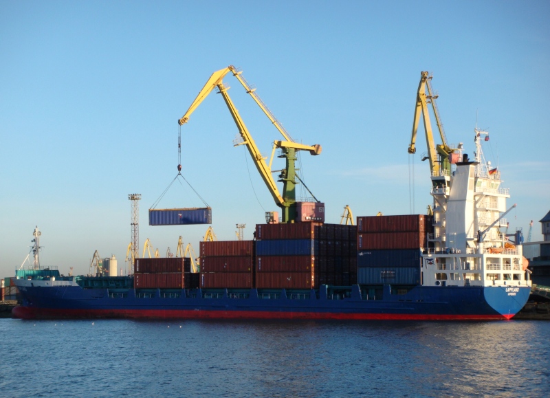

    Not a good ship arrangement. They achieved a slim streamlined hull, but the vessel doesn't look efficient enough in terms of cargo capacity & those rotors will be restricting cargo handling operations.

    Nah - they have no trouble overhead lifting containers from next to other vertical containers, and other regular ship superstructure. I can't think of many commercial unloading ports that use swing cranes anymore.

    You're talking about handling containers by big gantry container cranes - you're right then, but these cranes are mostly in ports that can accept big container ships. The proposed vessel is a short-sea multipurpose vessel which will carry various stuff from containers to windturbines' parts & is likely to sail all around Europe & there are a lot of ports that have just swing cranes or harbour mobile cranes (like by Liebherr or Gotwald) or just truck cranes which do all the cargo handling. Here's how containers are handled in my hometown - http://www.shipspotting.com/photos/middle/1/2/1/1432121.jpg

    Then I rest my case. That ship has superstructure as tall as a rotor, AND all those cranes are designed to lift the container straight back to the wharf. There is NO swinging involved, as you can see from the two cranes at opposite ends of the unload/load cycle.
