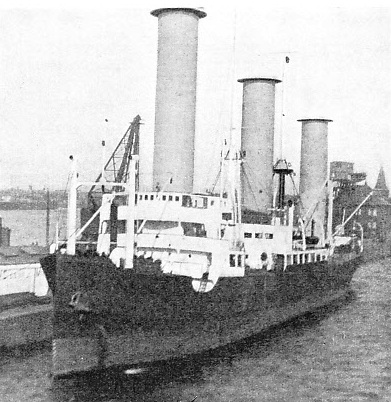

  4. rwatson
    Joined: Aug 2007
    Posts: 6,276
    Location: Tasmania,Australia
    rwatson Senior Member
    Fantastic. It had the first photos of Flettners second Rotor ship, the Barbara, that I have seen

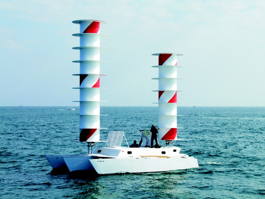

  13. rwatson
    Joined: Aug 2007
    Posts: 6,276
    Small catamaran using Flettner Rotor in high winds.

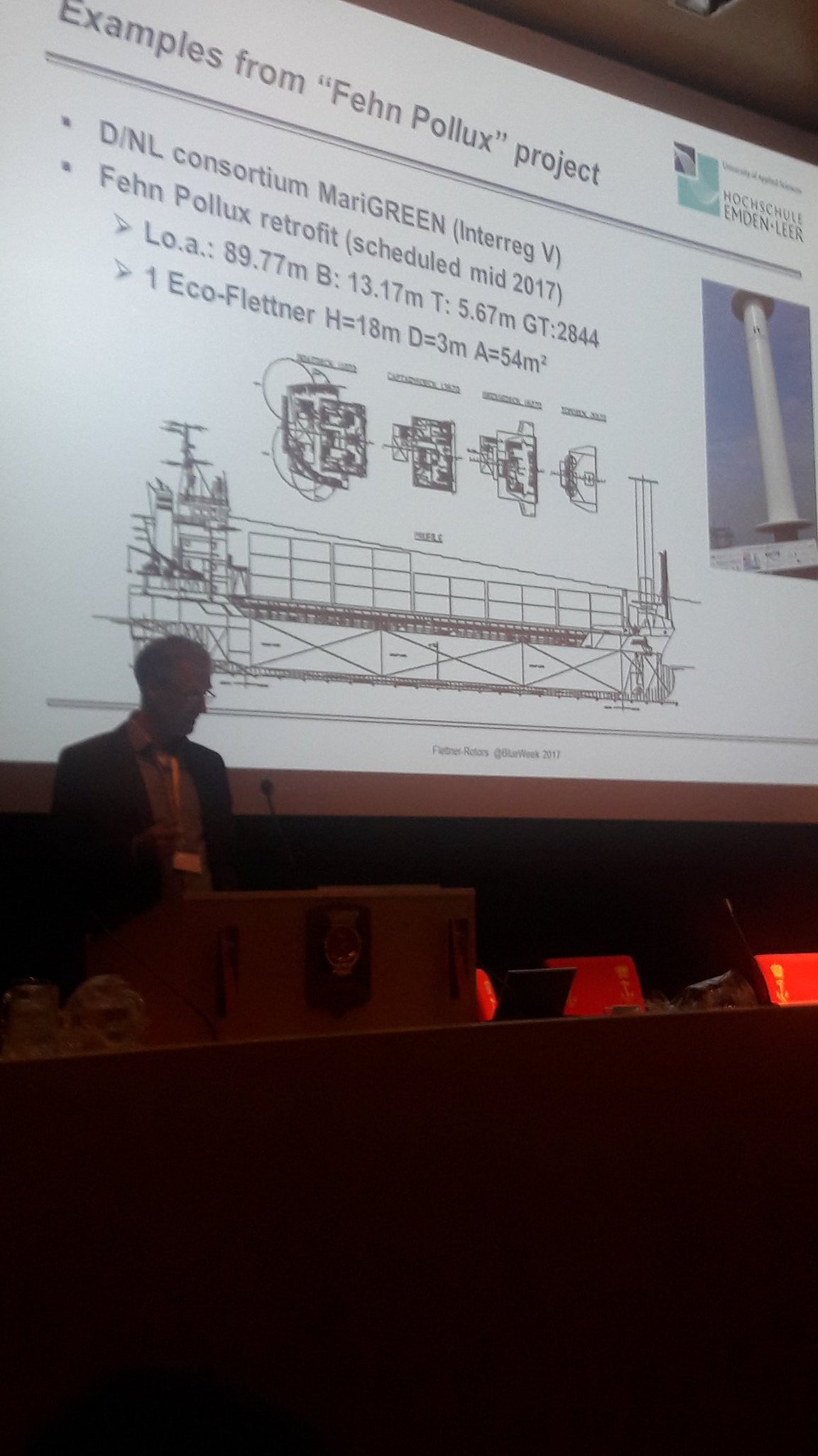

  15. Dolfiman
    Joined: Aug 2017
    Posts: 1,600
    Likes: 710, Points: 113
    Location: France
    Dolfiman Senior Member
    This is quite recently posted video (sept 2016) of the Enercon, if not already showed in this long interesting thread:
