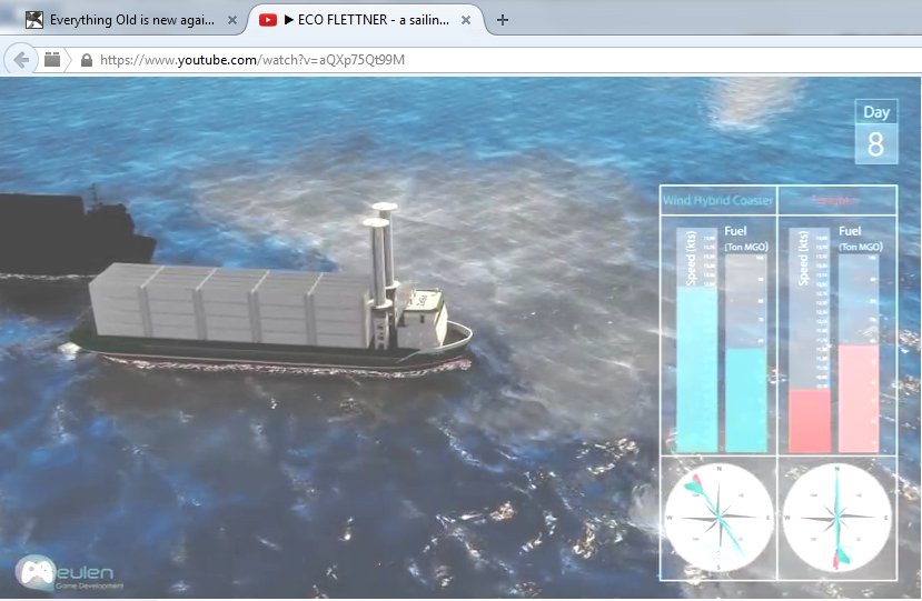

    Anyone able to Translate German ? E-Ship video
    Came across this by accident

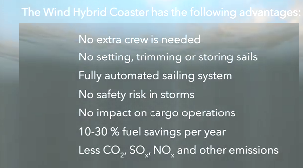

  9. rwatson
    Joined: Aug 2007
    Posts: 5,868
    Location: Tasmania,Australia
    rwatson Senior Member
    Some good information on this video - instead of just advertising. The accompanying PDF stress the point that routes with steady winds are needed to achieve the projected 30% fuel savings, and it takes about 4 years to pay for the system.
