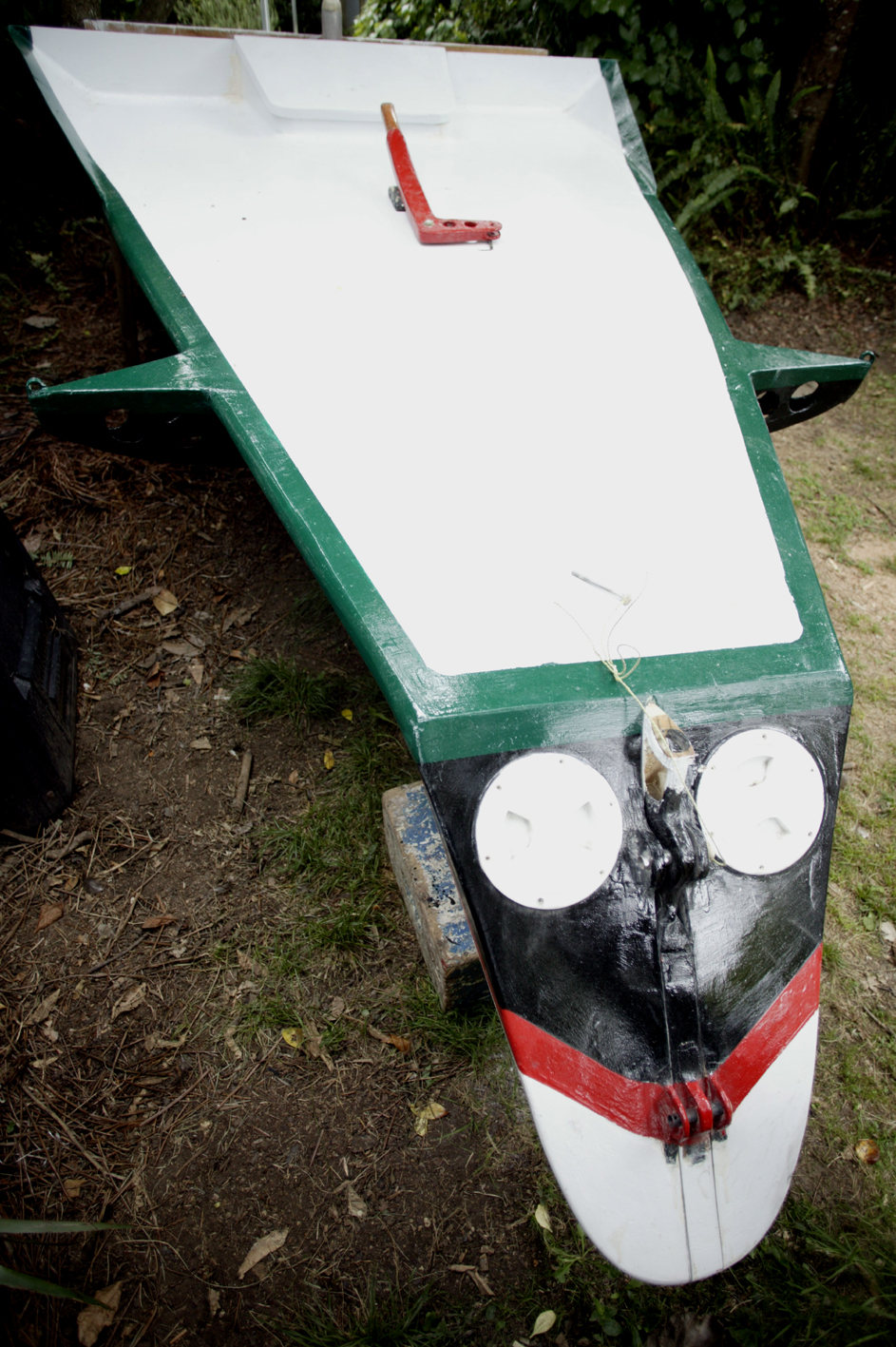

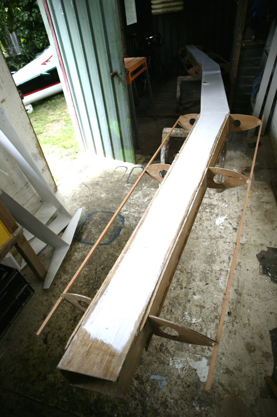

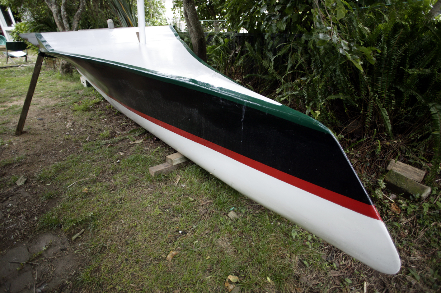

  9. Gary Baigent
    Joined: Jul 2005
    Posts: 3,009
    Location: auckland nz
    Gary Baigent Senior Member
    RBerrey, I'll have you know this is SERIOUS stuff. The foiler is not some dreamed-up-in-the-bath fantasy but is hard core reality ... and Doug and I of Team Serious will CLEAN up, crush the opposition; this is a given, goes without saying.
    Except I'm not enlarging the hatch.
    Also down below you squat as if toilet throned in narrow confines. Can you cope with this, Doug?
    Anyway here are three images of the EC Challenge 650 - the reality is REAL.
  10. Doug Lord
    Posts: 16,678
    Location: Cocoa, Florida
    Doug Lord Flight Ready
    Gc650
    That's what we need: a serious tri with a smiley face painted on the transom!
    Or maybe I've got that wrong......
  11. Gary Baigent
    Joined: Jul 2005
    Posts: 3,009
    The intention of the transom art work is to represent a Maori warrior smiling as he caves your head in with a taiaha or patu. Then he cooks you in a hangi.
