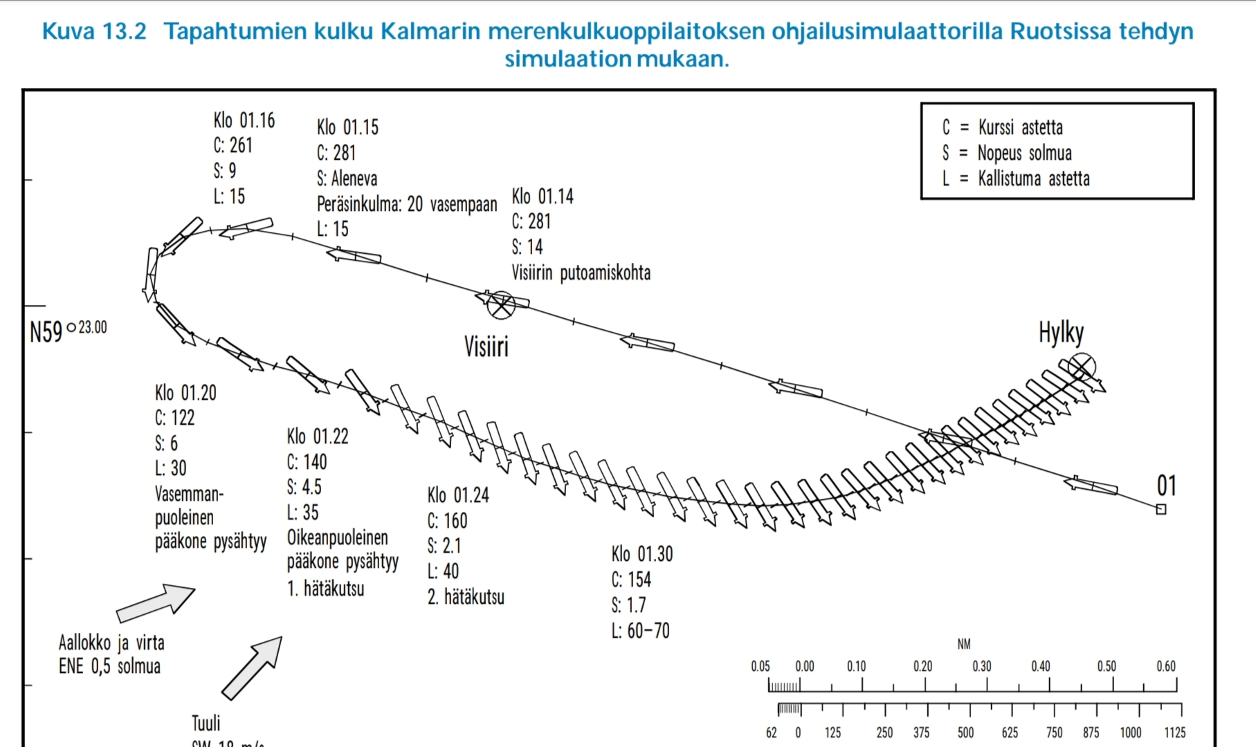

    sorry to say its a long time since I last raced a N12, before you were born in fact. So cannot comment, except to say you haven't given enough information, no idea of rocker or CofB for example. But it looks quite full forwards
    This is a good example of roll tacking that I often use
