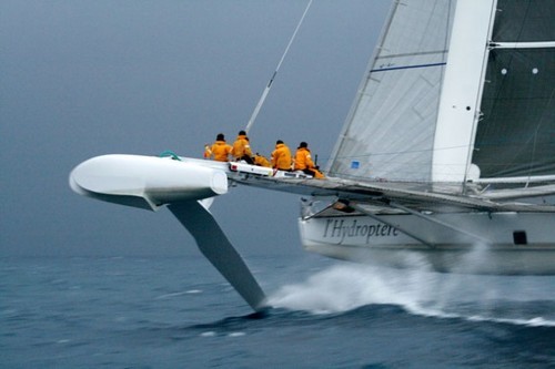

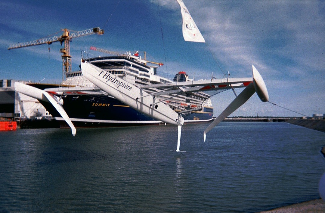

    Slavi, a clue to the design of such "amas" can be found in the history of Hydroptere: her original amas were displacement hulls and designed for intermittent water contact-they were not designed to be "sailed on".
    They didn't work too well and the later amas were stepped planing hulls which makes sense since contact would most likely occur with the boat at speed.....
    click for best view:
    left is the original ama, right is the later version-
