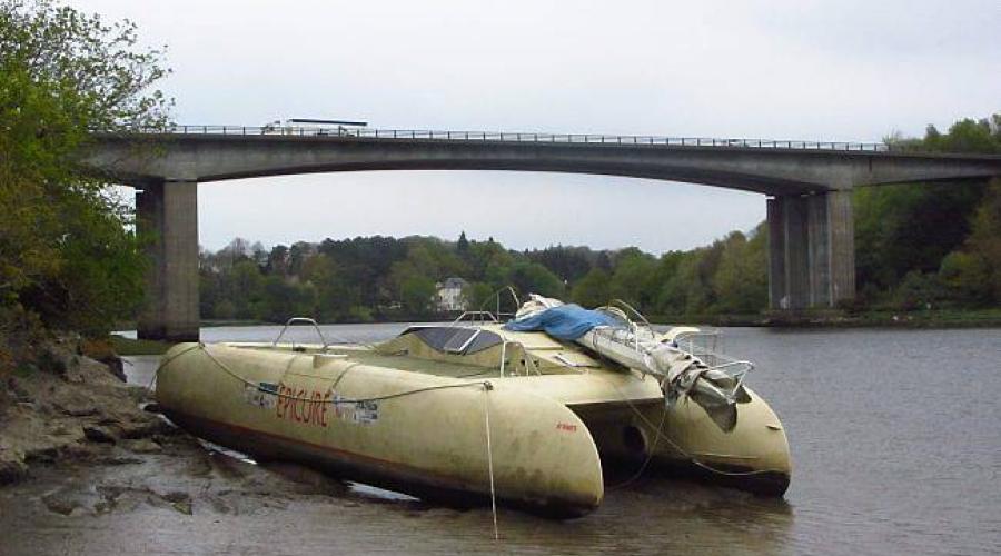

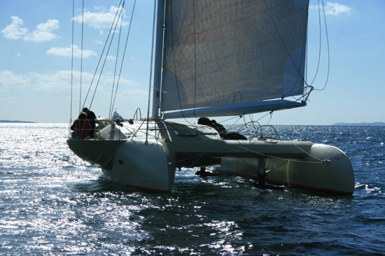

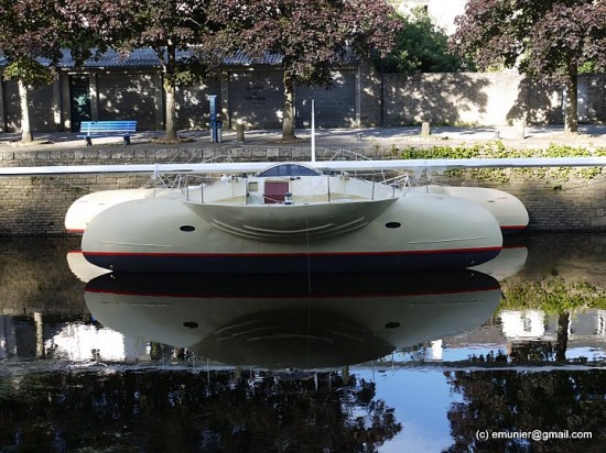

    I found this 47' proa "Epicure". I think it's beautiful.
    It's an "Indian proa". Similar to the Atlantic proa, with the difference that the leeward hull is the longest hull.
    I think this design might be the fastest of all proas. It has the weight of both the ackommodation and the sailing rig to windward, giving a good righting moment. It sails with the longest hull to leeward, meaning low drag.

    The owner had no money left to correct problems with boards and rudder. The boat got loose of moorings twice while waiting for buyer. No mention of damage. Aluminum hulls. Last post was in 2013 when builder CNA YACHTING tried to find the funds to put her on the hard at the factory.
  5. bjn

    I think one reason Rob doesn't like having the rig in the WW hull is because it's interfering with the space of the WW hull and the deck. As well as creating noise and vibrations. I think the cruising Harryproa concept is a bit like having a houseboat attached as a counterweight to a sailboat. The guests in the houseboat doesn't really have to know anything about, or be affected by, the sailing.
    Since the rig and supporting structures has a significant weight though, this Indian proa concept should have better righting moment than the Harryproa, given the same weight and beam.

    I do not want to get into haggling about nomenclature but why is this design called an Indian Proa? Doesn't its configuration fit the definition of an Atlantic proa?
