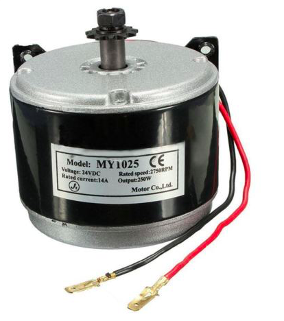

    I've scanned the web to look for some electric motors suitable to drive a boat, and very disappointing found motors with brushes and pulley drives and gearboxes :( How primitive and overly expensive.
