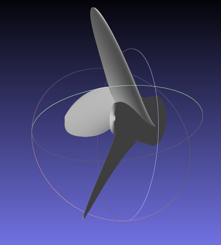

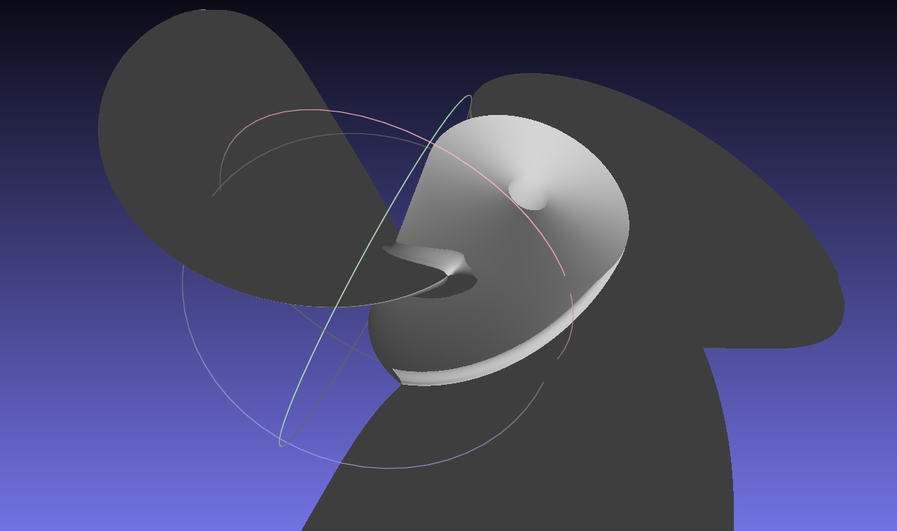

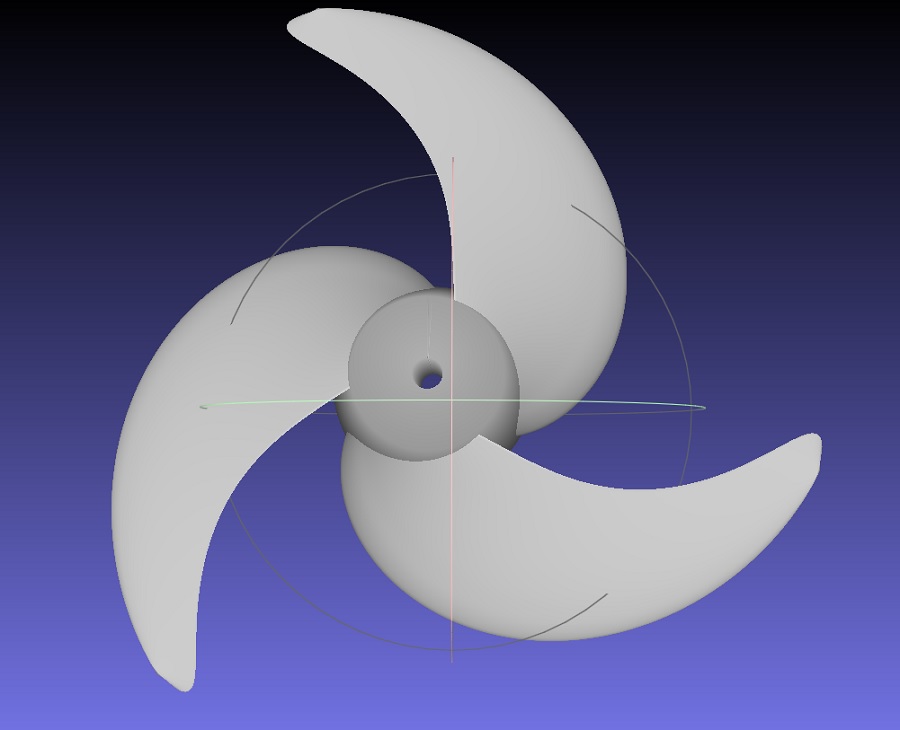

    I'm (also) far from able to design a prop, but I wrote a software tool which can calculate a .STL file which is to my knowledge often used for 3D printing. The input is according to the definitions of the ITTC lexikon based on parameters including skew and rake, the profile of the blades ist starting at root with an airfoil profile and ending at the tips as ogival profile.
    To get a good working prop in this way it would need test series with cheap and quick printed props. I don't know if you would consider this path a way to go for you. If so, I would provide the files for free.

    Before considering new designs; what do you actually have, what rpms and what power at which speed. Then a check for available standard screws, after that: how far is it possible to modify an existing prop.
