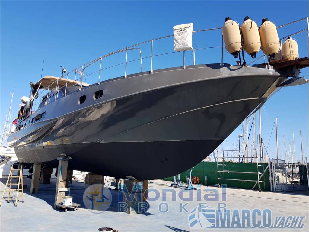

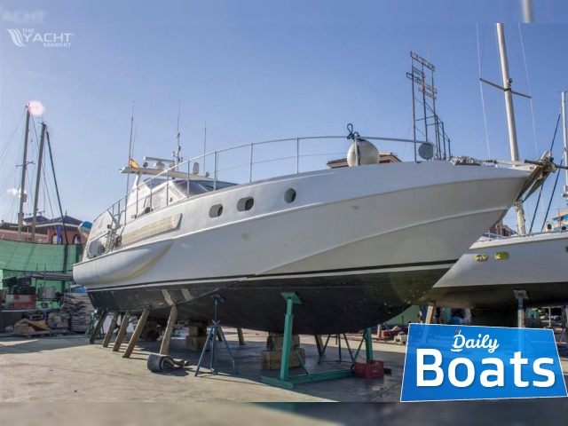

    Some photos of the Ischia 80 hull below:

    Found some additional photos of a 1988 hull, this one was made of fiberglass by subcontractor. Doesn't look like a Deep Vee, after all, more like a modified Vee?
    1988-baglietto-ischia-80-power-9892876-20250801095823913-1.jpg 1988-baglietto-ischia-80-power-9892876-20250801095825926-1.jpg

    With my limited understanding of hydrodynamics, deep vee is beneficial for displacement speeds at sea . I will even say that high angle vee would be the best for low resistance on the wavy sea. Look at indigenous people designs.
