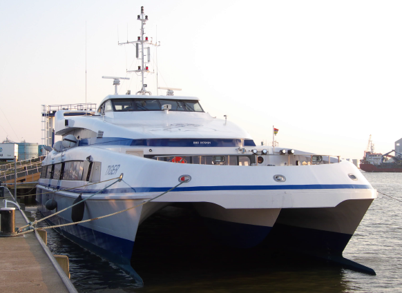

    Yes, here:
    Then you're going to say...er??..that is not 30 foot.
    Correct...it is 45m.
    But the NUMBERS of the hull are exactly the same.
    L/D ratio = 7.5
    Fn = 0.9
    So it matters little what the actual size of hull/boat is...it is all about the numbers of the hull in terms of its hydrodynamics.

  13. Ad Hoc
    Joined: Oct 2008
    Posts: 7,521
    Likes: 1,410, Points: 113, Legacy Rep: 2488
    Location: Japan
    Ad Hoc Naval Architect
    The pax ferry is 18:1, so, almost the same.
    As I noted, it is about the numbers in terms of scale. It is why model testing works...using geosims...exact copies of the hull at different scales all at the same length beam displacement and speed - scaled to suit of course.
    Hence whether the cat is 3 feet 30feet or 45m matters little ..if the scaled numbers of each hull are the same...it is the same hull in every respect.
    This:-
    fallguy likes this.
