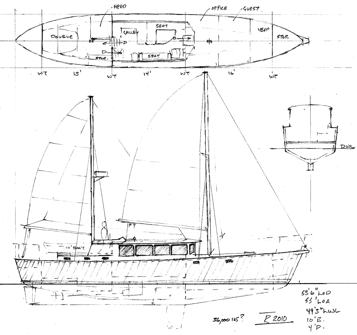

    There's lot's going on in this thread...appears to be several different boats are being discussed now.....:confused:
    One set of specs was mentioned for a mini Windhorse or a "low-cash" FPB64. The sketch below is my take, a scaled TimberCoast 22 hull. Full displacement, vee-bottom, plywood, foam/glass, or aluminum sheet material construction. Essentially a direct descendant of LFH's Marco Polo.
    I don't really think a 55' boat makes much sense as a coastal cruiser, something about 38' would be a lot handier if one is in and out of harbours, not to mention moorage fees.

    Rick,
    I really appreciate the effort you are putting into this, and have absolutely no reservations about the stabilized monohull. To the contrary, I’m interested to see how far this concept will carry, hopefully all the way.
    An iterative design process has to start somewhere, and an assumption on size and type of hull is in my opinion not a wrong start. We’ll find out what kind of boat we can make out of it. I’m reasonably positive a weight budget summing up to 3 tons will allow the comfort I need for cruising the Baltic in summertime, but there is no way to know that until we have an idea of what the weight of the basic empty boat will be. I’m also a little concerned that the physical shape makes the available volumes in the boat difficult to use. I guess we'll get an answer to that later on.
    Erik
  12. Guest625101138
    Guest625101138 Previous Member
    You are impatient.
    We are close to establishing the footprint to work within. I am certain the client has some reasonably firm requirements for his layout within that footprint. The designer's objective is to take those requirements and optimise the use of the available space to match the requirements.
    It is cart before the horse to present a layout that may not fit within the footprint or make assumptions about what the requirements might be rather than what they actually are.
    Rick W
