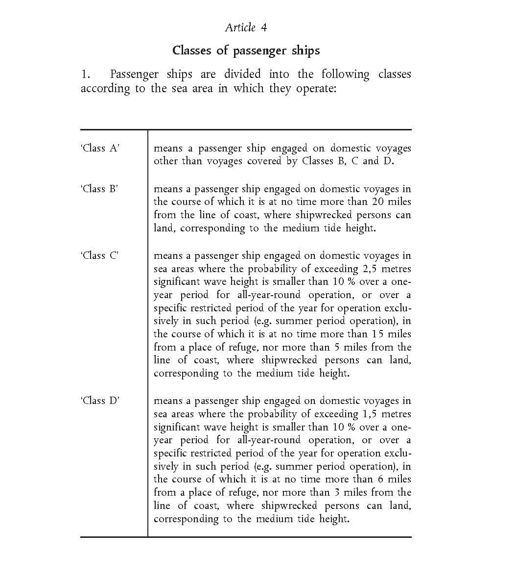

    I think the wording used is a misnomer. There is no 'design' category. There are Classes which categorises vessels, thus:
    The CE mark is merely a show of compliance with European rules on HSE etc. noted here.
    It is down to what the vessel is "designed" to satisfy. That is for the designer/naval architect to note. Then the appropriate rules are imposed onto the vessel by the local statutory authority.

    2AdHoc:
    For recreational vessels there are no classes, there are design categories. These vessels such as Lagoon42 are not 'classed', they are 'certified'.

    Ad Hoc,
    Alik is referring to Design categories as per Recreational Craft Directive. You are referring to Passenger Ship Directive...

    Alik/RAraujo
    Thanks for the catch.
    I don't do recreational boats, hence thought it may have been a misnomer from the categories of EU vessels I have to comply with :)
    Noted here:
    Definitions of Boat Design Categories.
    ‘A’ OCEAN: Designed for extended voyages where conditions may exceed wind force 8 (Beaufort scale) and significant wave heights of 4 m and above but excluding abnormal conditions, and vessels largely self-sufficient.
    ‘B’ OFFSHORE: Designed for offshore voyages where conditions up to, and including, wind force 8 and significant wave heights up to, and including, 4 m may be experienced.
    ‘C’ INSHORE: Designed for voyages in coastal waters, large bays, estuaries, lakes and rivers where conditions up to, and including, wind force 6 and significant wave heights up to, and including, 2 m may be experienced.
    ‘D’ SHELTERED WATERS: Designed for voyages on sheltered coastal waters, small bays, small lakes, rivers and canals when conditions up to, and including, wind force 4 and significant wave heights up to, and including, 0.3 m may be experienced, with occasional waves of 0.5 m maximum height, for example from passing vessels.
    Now I know too :)
