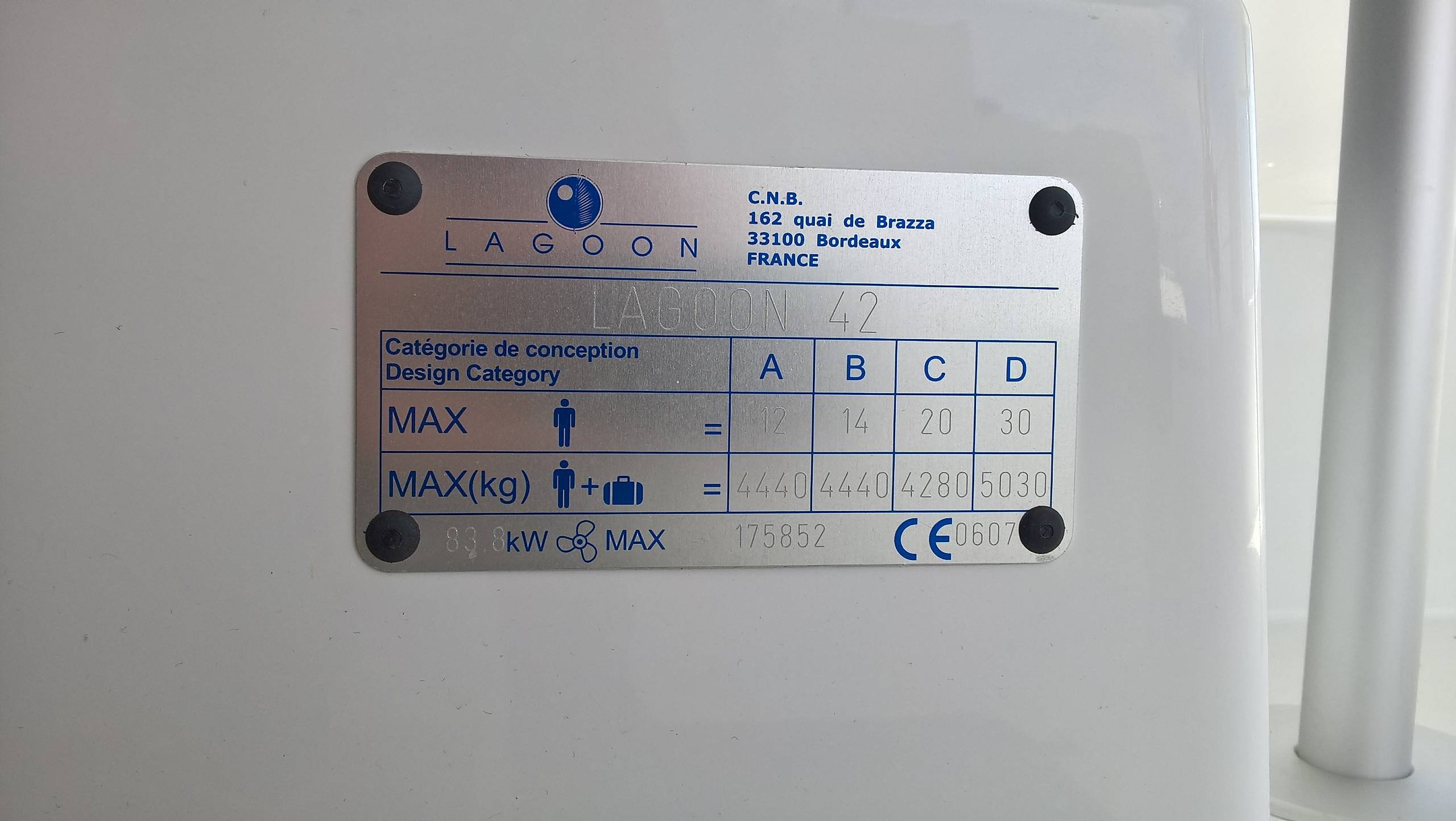

    I've been sailing recently on a Lagoon 42 cat and noticed the builder's plate mentioning several max loads and passenger capacities for the four EC Design categories (A,B,C,D).
    I am looking for operating a charter yacht myself with two crew and would like to find the maximum passenger carrying capacity to spread crew costs over as many paying guests as possible, in order to keep prices low. I always assumed that 12 passengers (sleeping) aboard was the limit for small craft being sailed by a commercially endorsed yachtmaster.
    However, this builder's plate gives the impression that more people are allowed on the boat, depending on the area the boat is sailed (ocean, offshore, coastal, inland waters).
    Can anyone clarify? Are the passengers indicated on the builders plate "sleeping guests" or just day passengers? And would MCA have a restriction on maximum number of guests that overrules the EC certification regarding maximum passenger carrying capacity and load?

    This is a maximum RECOMMENDED number of passenger as a result of ISO 12217-2 calculation. It reflects in no way national maritime authorities requirements nor charter boats requirements which are different for each country and also dependent on the safety gear (liferaft, lifejacke, flares, etc)not included in the boat when sold.

    Those capacities are part of the RCD (Recreational Craft Directive).....anything commercial is a different playbook as said above.

    Being a commercial boat, as mudsailor says, there is no a priori limitation on the number of passengers it can carry. You only have to demonstrate, through calculations countersigned by a subsequent inclining test, the boat is able to take them because it meets all the requirements of security and stability that apply.
    Passing from pleasure boat onto a commercial boat totally changes the rules applicable to the boat. The CE mark, which surely meets the boat now, probably not be enough.

    There are no passengers on EC-certified recreational craft. According to definition, all people on board are 'crew'...

    I agree CE marking RCD apply to recreational boats. But some EU countries (at least France) recognize "commercially operated" "recreational craft".
    "recreational craft" no more than 12 passengers onboard. On special conditions, can go up to 30. Sailboat, daylight, operated from single harbour ... (hence the meaning of D30 for the french Lagoon 42)
    But the boat must technically comply CE marking for number of people (passenger + crew) on board. 12 passengers + 2 crew = you need CE marking for at least 14 for your intended design category.
    Equipment and licences are specific for this kind of use (a mix between pure recreational and commercial passenger). Some constraints on boarding and fire equipment beyond pure CE requirement.
    I do not know how other countries (even within EU) recognize this French specific regulation.

    fcfc is righ. In some cases such as charter boats (bare-boats) are commercially used for the recreation of their passengers. In such a case the boats carry their CE mark as well as comply with Flag regulations for their type/size/exact purpose. Greece is another EU country that this is applied in some cases.

    in the case of commercially operated bare-boats, crew members are passengers. Not the RCD definition but applies in some cases, in some countries. If the boat is operated without commercial captain's licence, it is considered a bare-boat and must comply to CE plus flag regulations.
