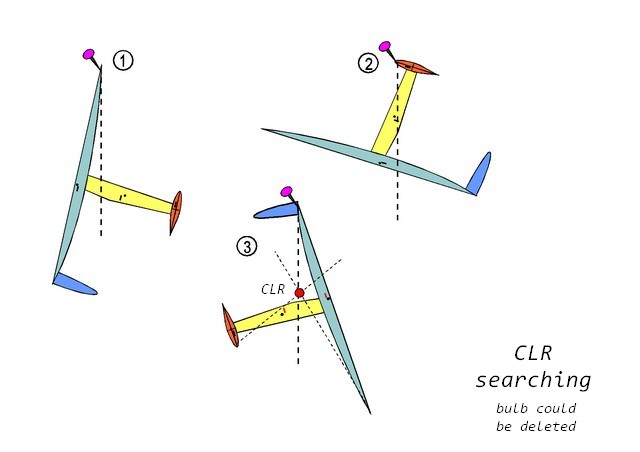

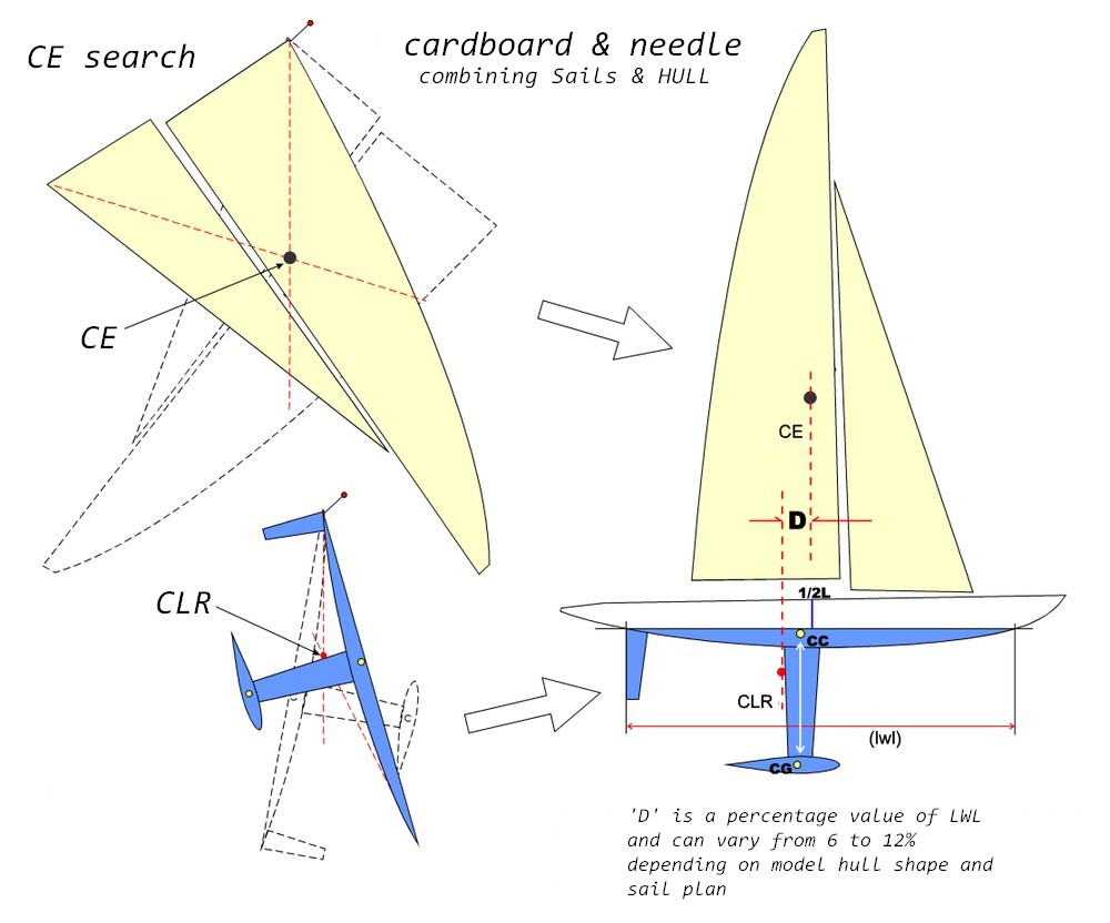

easy way to calculate CLR?

  2. ClaudioD
    Joined: Oct 2011
    Posts: 13
    Location: France
    ClaudioD Junior Member
    the Cardboard pendulum is a sufficiently precise method.
    I use it since 20 years on my RC Sailing models.
