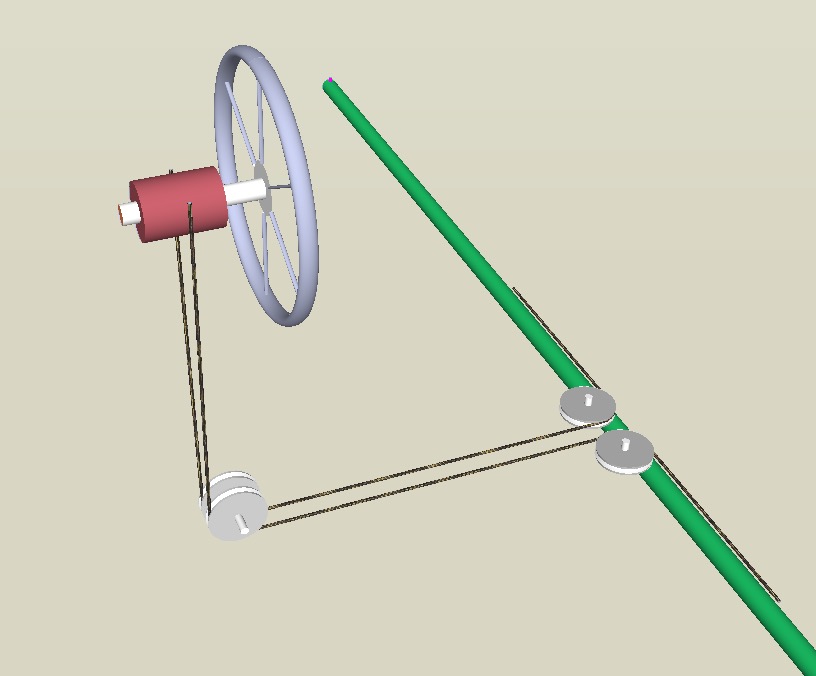

    this is rough schematic of possible steering arrangement for light-displacement 10.5m catamaran.
    the steering pulley is 12.7 cm diameter
    2 turns lock to lock for +/- 40 degree rudder movement
    total rope length ~3 m per side
    the green tiller bar is 4.4 m long and lies outboard of the aft cross beam.
    protected but still open to the elements.
    would 8mm dyneema sk-75 be suitable? too stiff?
  2. Skyak
    Joined: Jul 2012
    Posts: 1,203
    Location: United States
    Skyak Senior Member
    Just a note, you are not showing the distance from the tiebar end to the pintle axis. The tiebar moves in an arc so it will pull on the dyneema cord at an angle. The angle would be significant on the short side and you have no provision for the added length it would need -so yes, anything stiff would be too stiff for that geometry.

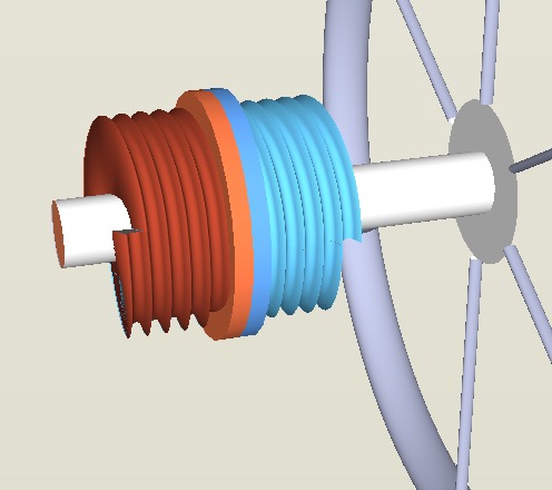

  6. UpOnStands
    Joined: Nov 2015
    Posts: 681
    Location: Sydney
    UpOnStands Senior Member
    one possibility is to split the sheaves allowing one to be rotated to take up slackness and then pinned against the other which is fixed to the shaft

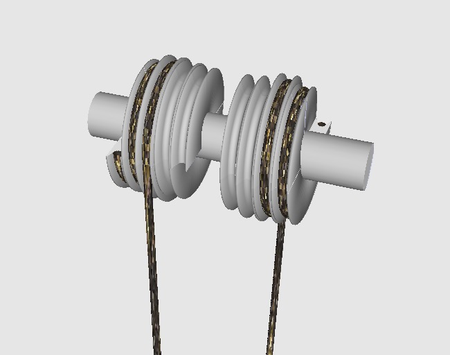

  7. UpOnStands
    Joined: Nov 2015
    Posts: 681
    Location: Sydney
    accounting for geometry
    this irregular sheave will handle the skew in dimensions as the tie bar moves aft at full lock (40 deg). Definitely a job for CNC. This means the 2 sheaves must be pinned to the shaft and slack/alignment handled by shifting the vertical pulleys separately. Rope now 4mm dia.
