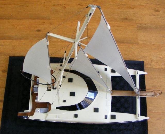

    More Photos
    If you fellows wouldn't mind it would really help visualize some of this 'new rigging' if we could view some photos of what you are describing??

    Mine were done exactly like this - including the diamonds etc

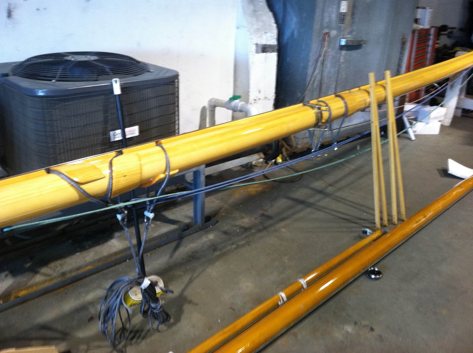

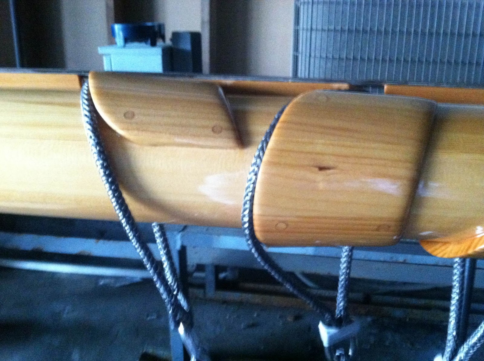

  15. catsketcher
    Joined: Mar 2006
    Posts: 1,306
    catsketcher Senior Member
    Brian
    I am using T balls to told the stays on. The diamond spreaders are wood/glass. I will have a second set, misalignment with the first, ready in a few days and can take a photo.
    I have made a composite mast base and masthead too. Saved me quite a bit of money.
