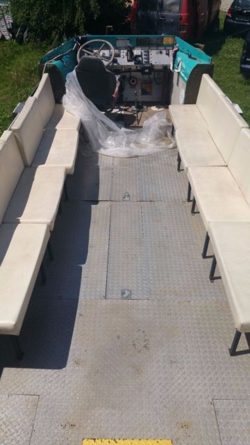

    I am not surprised that the tourist operators persist with these ancient vehicles, when you look at the money required to replace them with more modern alternatives. This one has an asking price around $AUD one million.
    - 44 Pax plus 2x crew
    - Caterpillar 3208 with Hamilton jet drive
    - No suspension, vessel rides on soft tyres
    - No shafts, minimal maintenance hydraulic drive
    - Fully sealed hubs and brakes
    - 8-9 Knots cruise
    - 45 Kmph on road
    Width is just 2,5m

    This one is a LARC, used for tourist excursions in central Queensland. These are 3 metres wide, a much more substantial vessel than a DUKW, and I think similar ones are still used professionally in flood rescue, and the like.

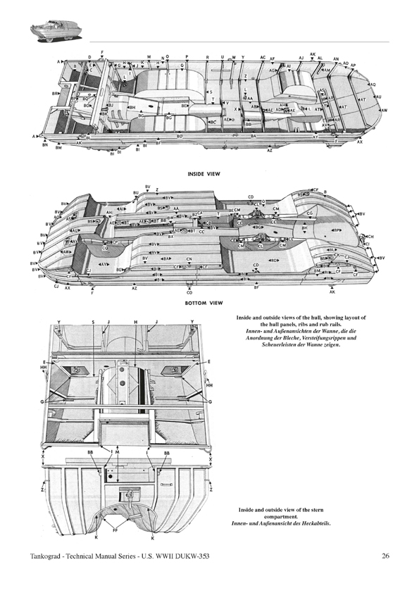

    I think the guy that designed them said they work better than any truck in the water and any boat on the road. That's not saying much.
    All the truck frame and transmission, transfer cases and everything is inside the hull, beneath the floor. They don't have room for positive flotation, they certainly sink awful fast.
    I know one of the sinkings with casualties was caused by the rubber boot disintegrating that sealed where the transfer case shaft exited to the propeller. I've no idea if there are more through hull fittings.
