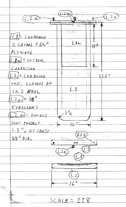

    The biggest problem with offsetting the mast on a pointed bow boat is that it looks a lot more odd than doing the same with a square bow one. If not worried about such appearance, why not go for it?
    A solution for your over topping problem might be a single lee board. A ten-foot long box boat I have designed has this system. The lee board is secured at the top with two lines. One leads to the bow (to keep it from shifting aft and to keep it connected to the boat so it won't get lost) and another attaches to a hook which grabs the inner cockpit edge (see sketch).
    If the board hits an obstruction, the unsecured bottom is free to move aft. At this point, the cockpit hook may come loose leaving the bow line as the only one attached to the boat and the lee board. The lee board can be pulled out of the water and the hook reset. This lee board is intended to be shifted over to the lee side with every tack. The foil is symmetrical for this reason. I settled on this system because I wanted to build this boat out of just three sheets of plywood. There wasn't enough material to make two lee boards.
    This design is intended to go sailing when the wind is good, but to go after pan-fish and bass when it isn't.
    I am definitely interested to see what you have come up with for a design. I hope to see at least some sketches.
