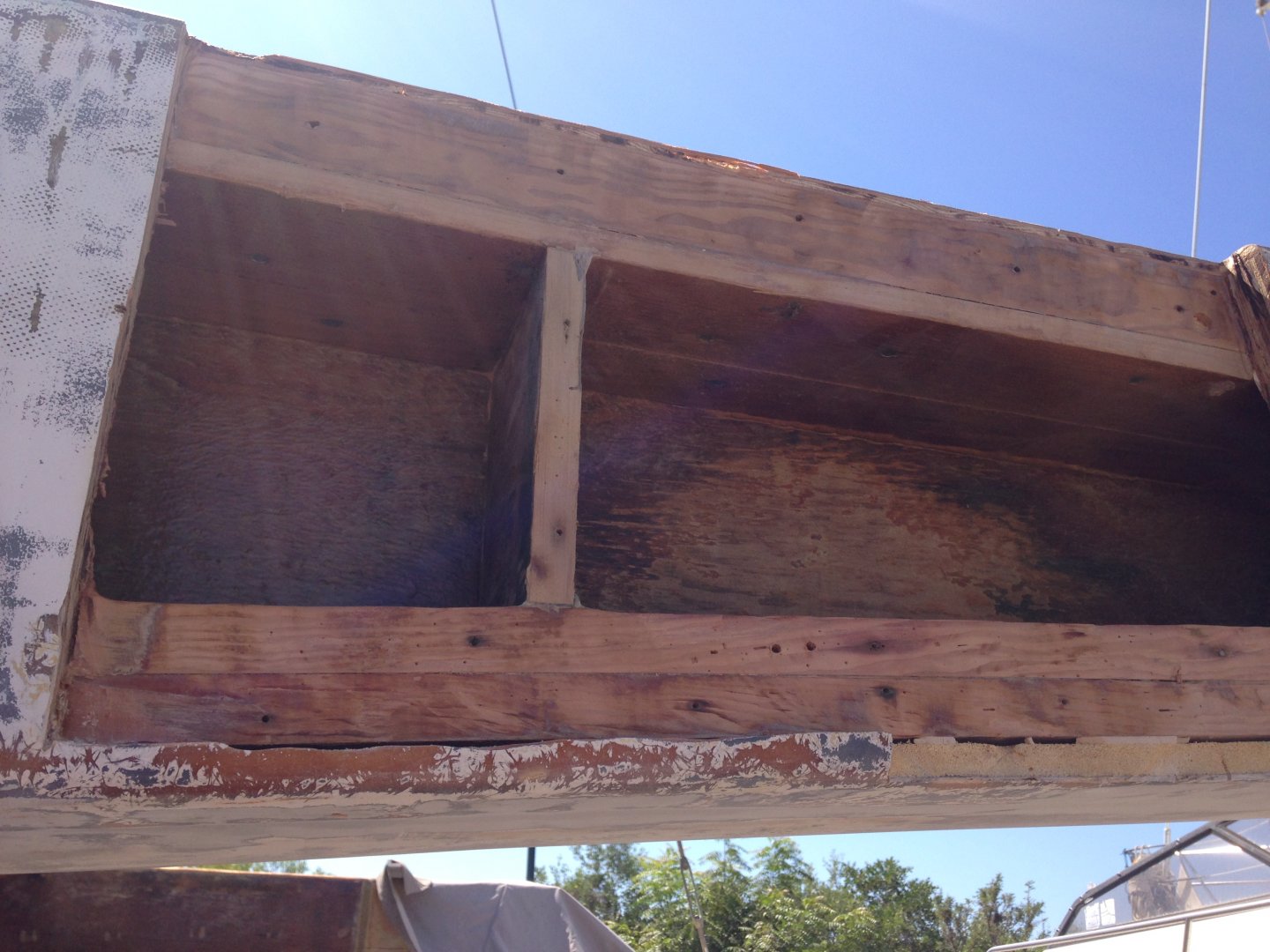

Here is a pic of the box
I tried poke it with screwdriver. With a small one used for electronic, I managed about 2mm. With a regular flat one about 1mm
So, u suggest taking plywood off from one side of the box, sand off all resin, install hair dryers, create ventilation between all compartments on the box, making sure the damp air can escape the box
Should I close the box while running the dryers? Then How much closed does it need to still be efficent? Or just with a blanket for easy supervising and access? IMG_1725.JPG

Great news. This indicates that the moisture is predominantly near the surface.
Since you are in the tropics, nature might be providing all the heat you need. The opened box is now fully ventilated.
Easy test to see which method is best. Leave open for two days, check moisture meter. Close up and blow dry for two days. Check if greater drop in measured moisture.
Just closed enough to ensure air travels through all compartments.
Easy supervision is essential.
I would not consider sealing things up until readings stayed low for a few weeks. Speed drying will give artificial low reading if surface dry faster than water can migrate from deapth.
