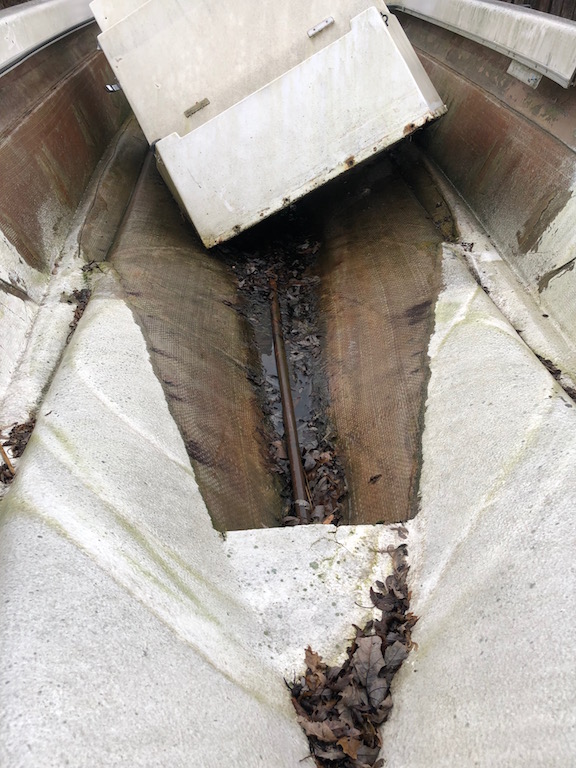

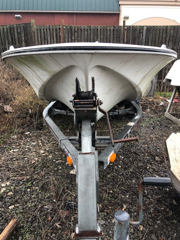

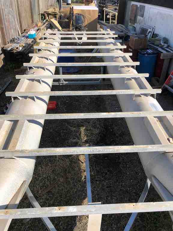

    Thanks Fall and Onda. A few pictures might makes things clearer and sour some discussion...
    The barge to be, a freebie I've now stripped to the frame -
    The donor hull, an unexpected freebie ready for surgery -
    Donor hull looking aft, glass exposed -
    Here is the process I'm thinking for the Frankenhull, comments welcome and appreciated...
    Flip the hull over and cut out the center portion with a Sawzall, over-sized by two or three inches, say 27" across the beam instead of 24". Flip the remains back up and onto a flat surface, shim it to level fore and aft along the keel, and plumb through the center line. Mark a point on the stem 24.5" tall from the flat surface. Run a laser level across the remains and cut the bow down to the level line. From this point onwards I have some choices.
    I was going to screw in some timber along the new chine to stiffen the remains, and to give me something to screw the mould panels into. Until then it'll be a floppy mess, and if I crack it before I can form it all up, I'm screwed. Then why not epoxy the chine timber permanently with structural fiber/filler, then square up the outside face to vertical? Staying on that thread, could I save a boatload of resin by creating an external frame for foam core and battens, laying up first in the hull interior? I know I wanted to avoid fairing, but I'm thinking a core build would cost less and go faster. Or maybe even a plywood core. Fewer glass layers, less resin, etc, etc. Thoughts?
    My only concern with this donor is that the square chine and flat bottom when I'm done may create some unwanted lift. At 6 knots, is this likely to be an issue, putting upward pressure on the center of the deck and cross frames aft? Should I make the hull narrower than the 23" diameter pontoons, to compensate somewhat? How much narrower?

    There's all kind of splashing going on under a pontoon boat so you'll have to seal up the spaces between the top deck and the top flange of your 3rd hull, otherwise the new hull will fill with water pretty fast.

    The donor hull can be anything that floats and will fit between the existing pontoons, I’d not get too carried away with perfect fit and lines here, after all, you’ll be doing very well to even achieve hull speed in this rig, and it seems more important that it floats upright than spending tremendous energy and money on a perfectly dimensioned center hull that is still slow.
    If you’re going to use the hull you show, use the entire hull, if it will fit between the pontoons.
    If it must be cut down, take a section out of the middle, then reglass the two halves together.
    Just glass a flange along the top line, if it’s a little floppy initially, not to worry, it will become very rigid when bolted up to the deck beams.
    The flange can be glassed in prior to cutting down the freeboard, would help the hull to hold its shape.
    I must reiterate that in any hull configuration, including just the original two pontoons, it will handle like crap with a low powered single straight shaft/spade rudder configuration.

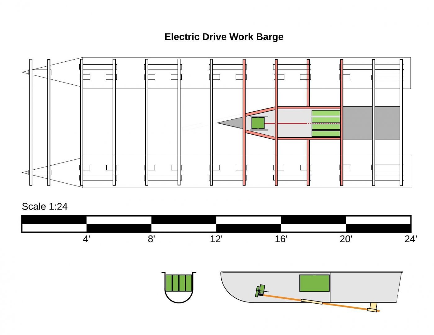

    Agree. Fore and aft the drive hull will be sealed below deck, while new framing above the flanges (in orange) will seal the motor and battery/shaft log compartments. Both compartments will have watertight hatches at deck level. Hope that makes sense.

    Another full hull is being added to an already very buoyant craft, the displacement numbers have been crunched, all good.
    This is not an ocean going yacht, sealed decks?
    There should be plenty enough electricity onboard to power a bilge pump that will easily handle splashes!
    I would not waste one drop of epoxy on this, polyester is more than adequate.
    Are you guys are intent on draininG the OPs wallet?
    There are discussions on this forum that talk about hi speed, hi tech, lightweight futuristic craft, but I don’t see this barge as fitting that category.

    The donor hull will certainly need to be cut down. I was going to try and retain the keel and bow intact, then glass up new hull sides and a transom from the inside against a vertical mould surface. A little target fixation on my part, wanting to keep the production bow shape intact, and not considering the labor and material needed to fabricate new hull sides.
    You suggestion leaves a single seam along the keel, which could be reinforced the same way I was going to treat the two chines. This could be done practically by propping the hull up on it's side and marking my cut lines either side of the keel with a laser level. It'll still be a trick to get two identical halves, but I should be able to get close. I can fix the gunwales to each other with temporary stringers while I glass the inside of the mated hull along the keel. The mated hull should then be stiff enough to flip, then mount the shaft strut, cut the shaft log entry, and fill/glass/fair the new keel line up through the bow stem. Last step would be cutting the freeboard down to size, leaving the flange surface for last. Does that sound right?
    Lastly, would you please help me better understand the issue of using a fixed shaft & rudder vs outboard or I/O, both of which are now in use on pontoons? Pontoons handle like crap under the best conditions, how is it any worse with a fixed shaft and rudder? I can't imagine it's a power issue. These boats came standard with a a 35 or 40HP back in the day. Low speed maneuver dockside or otherwise is just above idle RPM, no more than 10HP (if that). My RPM/torque/prop spec will deliver 300 lbs of thrust for 3000 lbs displacement, which seems adequate to tool around at 5 or 6 knots, or to maneuver and land with reasonable control..
    If the issue is how poorly pontoons track in general, I could add a narrow 6" or 8" keel fore and aft of the shaft log, without creating too much drag. Would that be useful? What is it about redirecting thrust with a rudder that is so different? I'd really value your insight, and any mitigation that might be possible, assuming this remains an electric boat and that I'm limited to 5-7Kw of power, outboard or inboard.

    The issue with the rudder is not so blatant at cruise, but it will be ungainly at slower speeds, esp in a crosswind.
    The biggest drawback is control in reverse, where there’s no prop driven flow over the rudder to push the boat in the direction you need to go, so it will prop walk until enough speed is gained for the rudder to have some effect.
