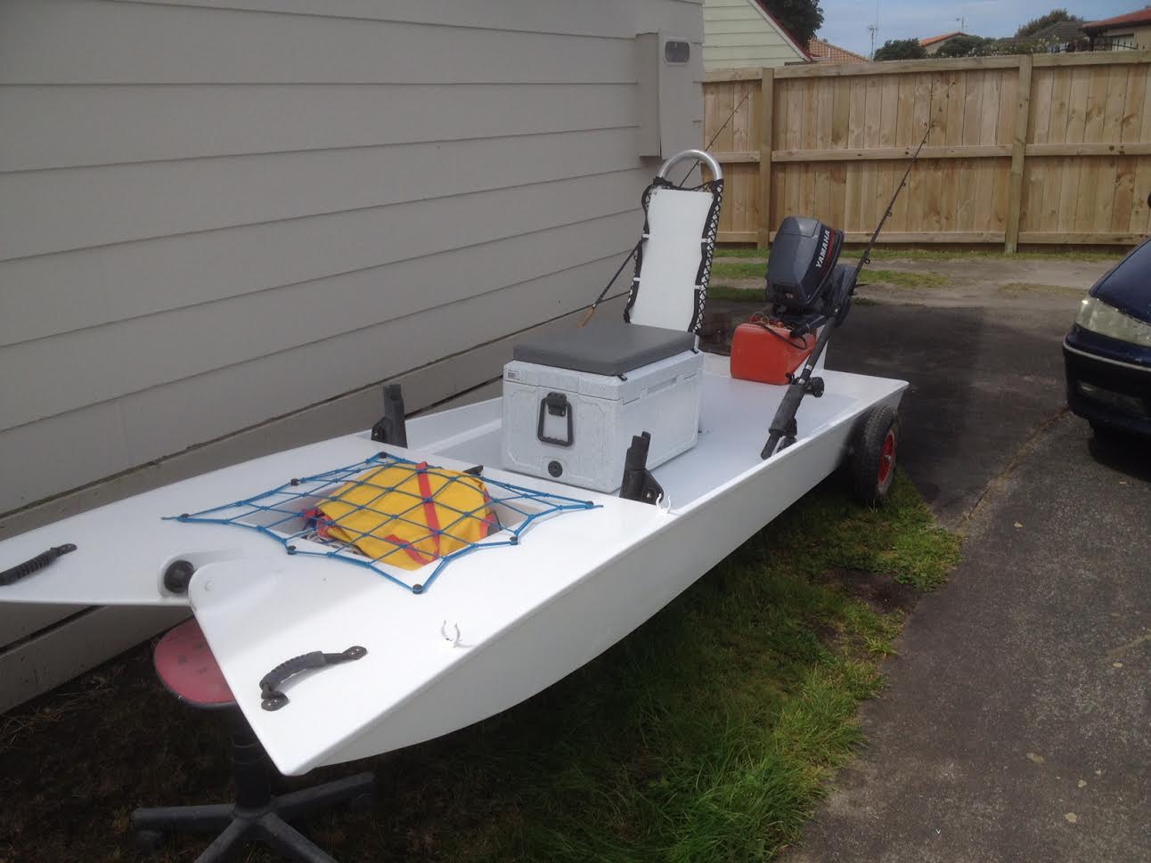

    I wouldn't use a skeg, just some strips of wood, these will do double duty, they'll make the boat handle better, plus be sacrificial wear strips that can be replaced when needed.

    Designing a boat around a 5hp outboard, pretty well rules out planing types, for most practical purposes. This is severely limiting, to put it mildly, and the result is not going to be much chop.

    Micro Skiff I think is usually what such craft are referred to as. I've designed and built something quite similar. Although I went for an inverted V hull form, the overall dimensions and weight were very similar and I used an 8hp outboard.
    In my experience pounding in choppy waters is only an issue for the passenger seated in front (presuming there might be one?) For anyone standing it's a non issue as legs make for an exceptional shock absorber!
    As for how wet the ride is - Because the standing position keeps you so high in reference to the hull I think if there's any spray it will be low down and only bother your lower legs.
    5hp will be enough if you are solo although I think it wouldn't be enough to comfortably plane with a passenger. on my skiff 8hp is just enough with 2 people and gear. I think by myself I get around 18 knots top speed which feels very fast on a boat this size.
    I wouldn't be too concerned with some of the comments here, I think you will be quite happy with how it turns out. My only concern would be the 249 litres of buoyancy. It might sound ample but bear in mind you make up a large portion of your displacement so any movement fore/aft or side to side will drasticly affect the hydrostatics.

    That's a very cool boat!
    I fully expect not to be able to plane with two people up, which is going to happen now and again. That's why the console is on rails to be able to adjust COG.
    With buoyancy I meant the easily available volumes to install bottles or foam for safety purposes, which is a local legislative requirement
    The total buoyancy of the boat is considerably more, I will ask the computer. I determined the COB and the answer is there somewhere.

    Where in NZ do you fish? And can you pull the boat over soft beach sand with those wheels?
  7. kfly
    Joined: Jul 2009
    Posts: 9
    Location: NZ
    kfly Junior Member
    I live and fish in Tauranga.
    Being able to wheel it across soft sand is why I designed and built it! I'm 12km from the nearest ramp but just a few hundred metres from the beach where I can now launch!
    I've been really surprised how sea worthy they are. At first I thought it might just be a cool harbour boat but actually I've been out in some pretty shitty stuff and amazed how well it handled it.
    I designed an alloy version that a mate built too. I'll try and upload a video, I just have to try and compress the file size a bit first.
