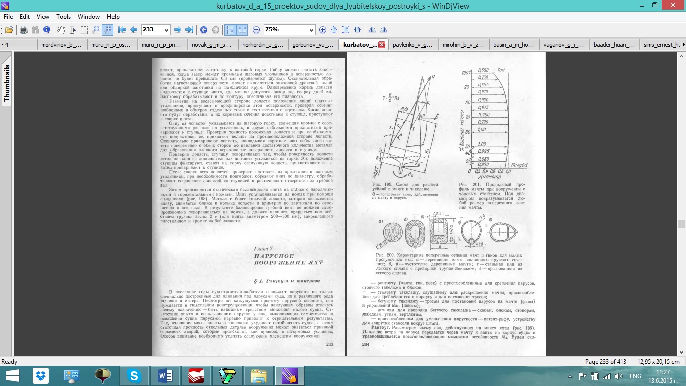

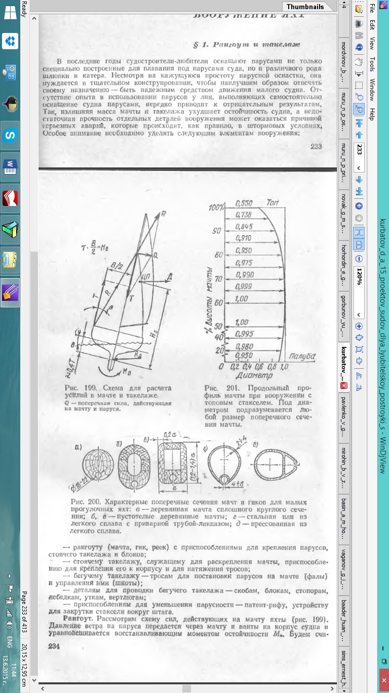

    Design of Yacht Mast
    What it is necessary to make the professional projecting a mast for yacht to convince the surveyor of Classification organization that it not be damaged at a strong wind during travels?
    From Rules GL for Yacht up to 24m, 2003, Part 3, Section 2-Mast and Rig, we can see following:
    1.1 According to the development of computation methods GL examines mast and rig dimensioning
    through geometric non-linear finite element analysis (FEA).
    2.1 Normally, four sailing conditions upwind and one spinnaker case are considered, all at 30 ° heeling angle of the yacht.
    3.2 Loads in longitudinal stays and halyards also contribute to mast compression. As a general approach this contribution to mast compression will be brought into account by 85 % of the maximum load at the mast step of the four upwind cases and is to be added accordingly to give the maximum total load.
    3.3 Buckling load will be calculated observing the contribution described under 3.2. As a requirement for sufficient stiffness buckling load must be at least a factor 2,6 above the maximum total load.
    All this is difficult enough for calculation. For this purpose I bring to your attention one very simple and light formula for calculation of the Inertial moment of cross section of a mast for yachts from Dmitry Kurbatov's book „ 15 projects of vessels for amateur construction “, 1985.
    The formula is approximate and it is possible to use even when the Diagram of righting arms misses.
    I regret that I cannot offer you the text in English for these formulas. All the same I am not a professional translator. But I think that formulas can be understood and without specialized translation.
    In the picture 201 you can see the longitudinal section of a mast at armament with a mast head staysail.
