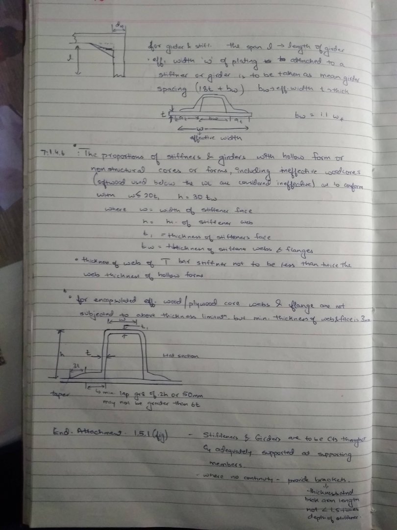

    actually am trying to learn to draw midship of a catamaran in soft copy to give a print out
    my vessel if grp based high speed vessel
    i have done the calculation for thickness and lamination sequence
    but then am not sure of how to start and end it with.
    please if anyone can help me doing it.
    it is urgent.
    im uploading the calculation excel
    offset excel and body plan (stn 5 being midship)
    also the word document.
    please help me

    and the excel prepared is as per rules
    i have written and noted down each rule.
    im requesting if anyone can help me draw it in autocad
    with the given values of thickness and stiffners dimensions
    i have written the rules
    ill upload the pdf of my bodyplan
    but sir i am actually not able to visualise and draw in autocad what is where and how to mark it.
    i have attached the files and calculation i could understand the max
    hope this is enough and help in drawing it out.

    sorry sir but i can only see the drawinf of body plan which i had attached earlier in my reply.
    i am in need to draw the midship section of this catamaran
    ive done the calculation but not able to draw it like where to draw what transverse or girders and how to label them
    hope u get my query.
    i have understood and done the calculation rest part is to draw. which am unable to do.

    no no sir not actually wanting that someone else to do my job
    is drawing on autocad so easier than on paper.?
    i just got paper drawing of someone with same kinf od hull and drawing of midship of GRP.
    if that can be made for my dimensions as found in excel is that possible to do in autocad.
    am new to autocad and stuff.
    tbh this is my degree project work. im learning and trying to apply.
    hope u understand and help me out.
    on lighter note sir if you actually give me that final drawing with the dimensions calculated in excel there is nothing more i can ask for right now and would be so grateful forever. :D

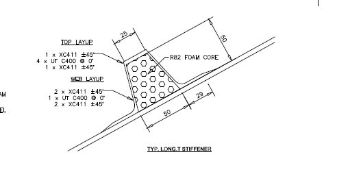

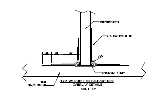

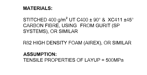

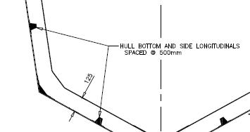

  12. Ad Hoc
    Joined: Oct 2008
    Posts: 6,910
    Likes: 855, Points: 113, Legacy Rep: 2488
    Location: Japan
    Ad Hoc Naval Architect
    It is much easier than you think. You have done all the hard work already, like this:
    So, all you need to do, is place this data onto your dwg with the assumptions in the calculations that you have made.
    For example, this is basically the same as your hand calculations, but shown on a dwg:
    And is is referenced here:
    So the section is shown, the layup is noted and spacing , on the hull lines, is also shown.
    You supplement the assumptions by stating what materials are being used, such as:
    And you can do a detail line by line dwg of the hull layup, or just list it as shown:
    You then add further details for the connections, like the frames such as this:
    Again, just direct from your hand calculations, but shown pictorially.
    Or combinations of them such as here:
    Or a combo showing frames/layup regions:
    So it is really up to you how you wish to show this data.
    No idea what "stands of a ship" means... and how does this assist the OP?
    bajansailor and shrijeet mishra like this.

    i hope by stands you meant stiffeners and plates scantlings.
    i have done the calculations of parts like bottom frames girders beams transverse and cross structure.
    just wanting to draw it
    yes sir posting wont help me drawing but i am learning many things which i would have not. from you and others
    instead of posting and scrolling instagram spending some time here is worth i feel.
    i have started working or autocad and engineering drawing basics so that i get to understand what to draw and how and where.

    sir
    thank you so much
    this was actually i am try to understand and learn that how to label and what is calculated in excel the scantlings where are those placed and it drawings respectively.
    if not autocad ill try first on A2 sheet and then try over it.
    if such problem comes in autocad ill request you again
    i hope u dont mind helping me over.
    thank you sir.
