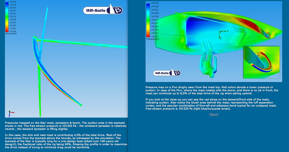

    You may also want to take a look at http://cdn2.hubspot.net/hub/209338/news/Ad_aerodynamics/index.htm?t=1428319882242
    In the attachment, a more recent article about Finn mast aerodynamics. According to this study, the mast shape is not very important - what you gain in the mast efficiency you tend to lose in the sail, and vice versa. The cat rig is different from a sloop in that the mast rotates with the sail - it makes the mast more efficient.

    "Note that in aerodynamic terms, the mast does produce drag, as the aerodynamic drag is defined in the direction of the apparent wind. But in hydrodynamic terms, where the drag is oriented against the direction of the motion of the boat, the drag is often negative."
    I refer to the body fixed coordinates of the boat: "negative drag" is not lift, but positive drive, in the direction of the motion of the boat.
    Cat rigs are often unstayed and rotating with the boom, at least on smaller boats.
    A round mast is not bad, but you don't want to attach the sail on the lee side - that's like overrotating the mast, which is not good.
    Intuition is great but often leads you wrong when it comes to aerodynamics.
    I cannot edit those old webpages anymore, but here's screen copy of those broken pages offline.

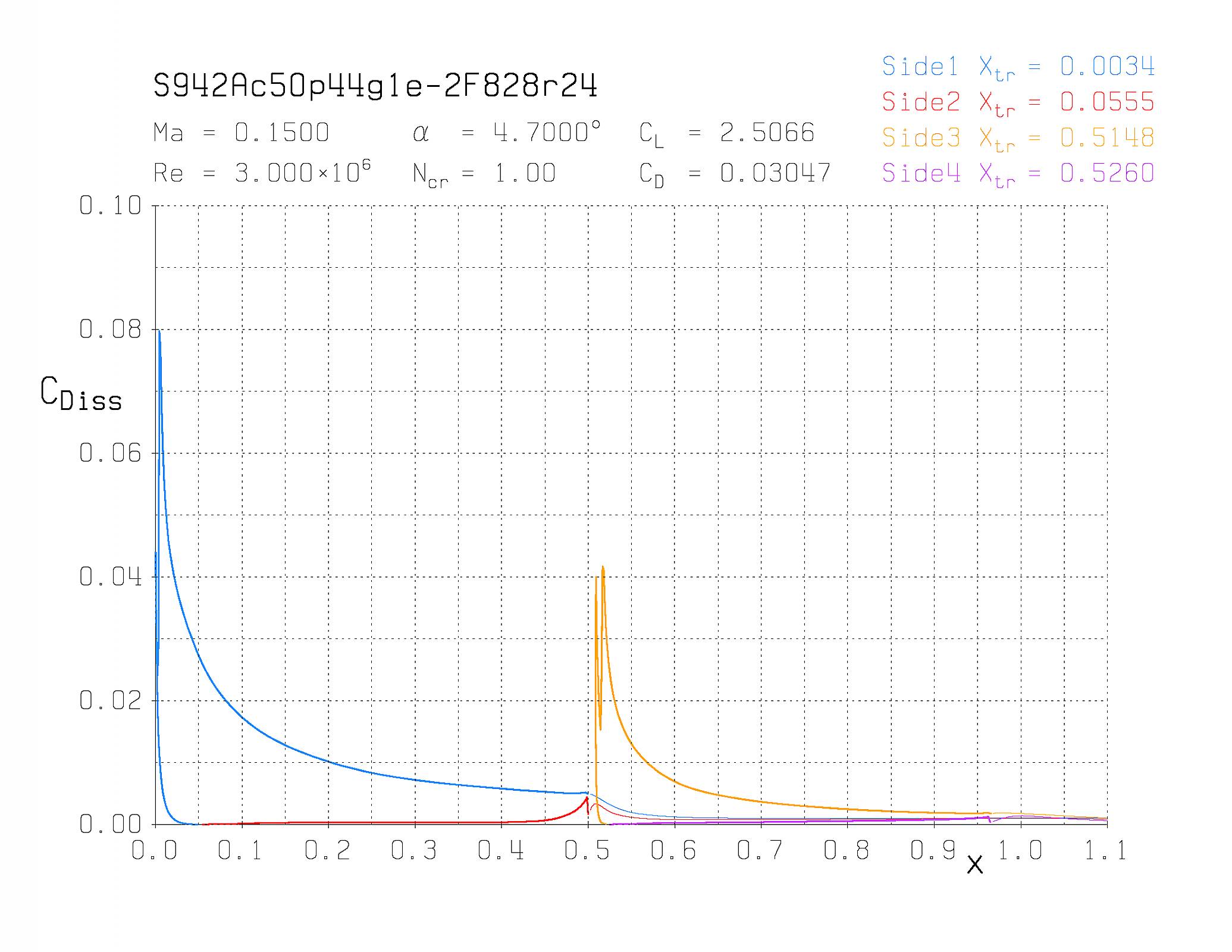

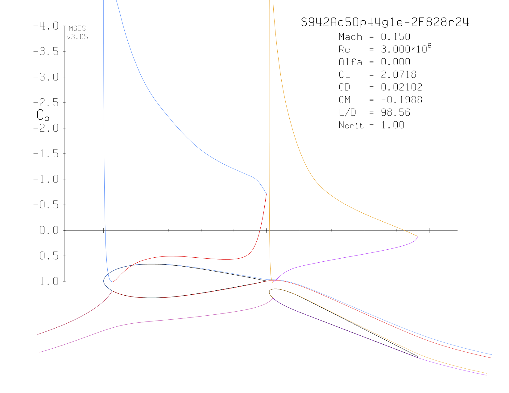

    Here's a typical section pressure distribution from that wing. The flap is deflected 24 deg, and and the apparent wind is aligned with the forward element. The forward element and the flap have equal chord lengths.
    The peaks of the pressure distributions are clipped, but you can tell that the area inside the pressure distribution of the forward element is substantially larger than the area inside the pressure distribution on the flap.
    For this section, if you hold the forward element fixed and only vary the flap deflection, the change in lift is approximately 80% of what you'd get by rotating the whole section. If you hold the flap at a fixed angle to the airstream and rotate just the forward element, you get about 20% of what you'd get by rotating the entire section. So would you say that means the lift is generated by the flap or by the forward element?
    The lift is generated by the total deflection of the airstream, and the air comes off the wing largely parallel to the direction of the trailing edge. That's why I say that although the lift is carried by the forward element, it is determined by the aft element.

    That is not correct. The two elements work together. The main element couldn't create the lift that it does without the influence of the flap.
    In so far as the flap lets the section create the lift it does without separated flow, and in so far as the slotted flap allows the lift to be created without the leading edge suction peak that would cause more skin friction, it would be more accurate to say that the flap reduces the drag over trying to do the same job with a single element section.
    Here's the dissipation coefficient distribution for the same case I showed above. This shows where the profile drag comes from around the section. The main element has more drag on it than the flap.

    Thank you for the Cdiss coef plots and for the wing sail sections and comments
