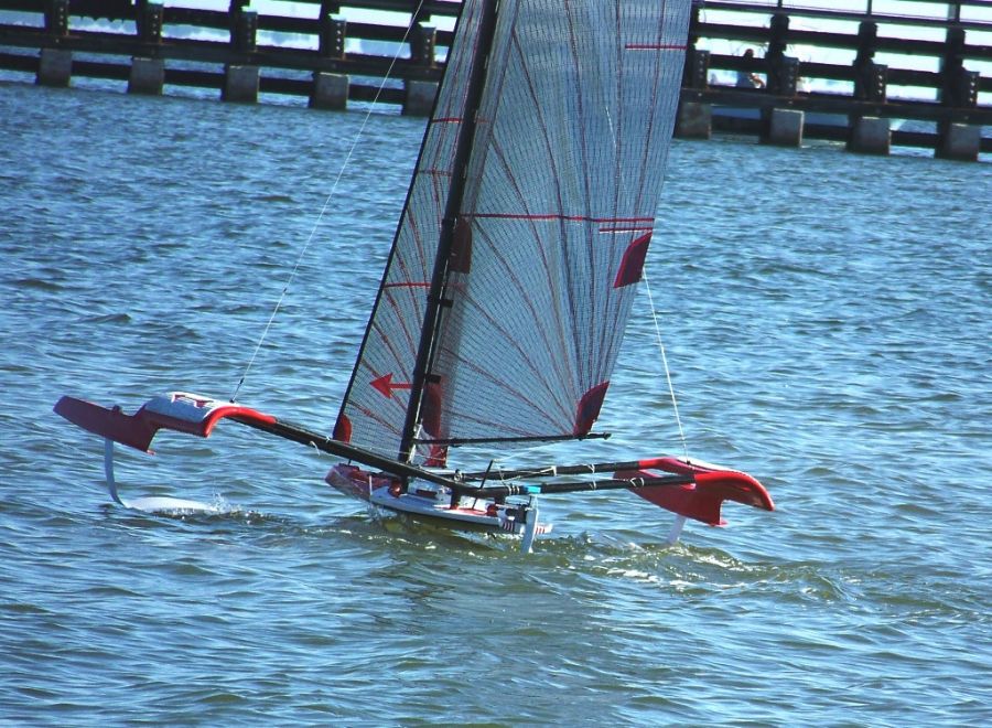

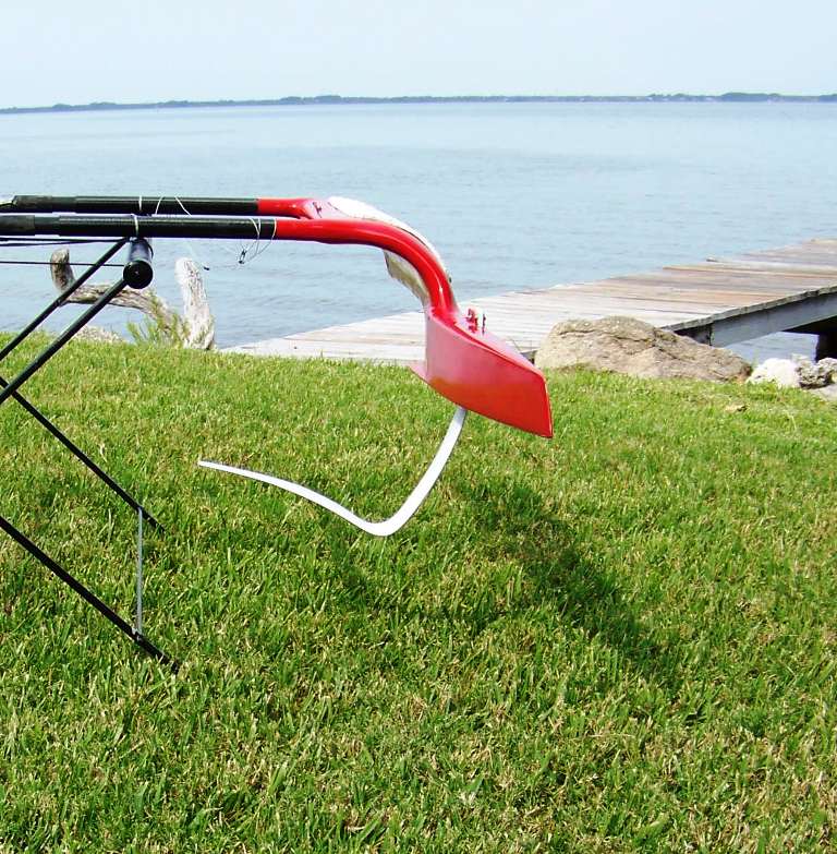

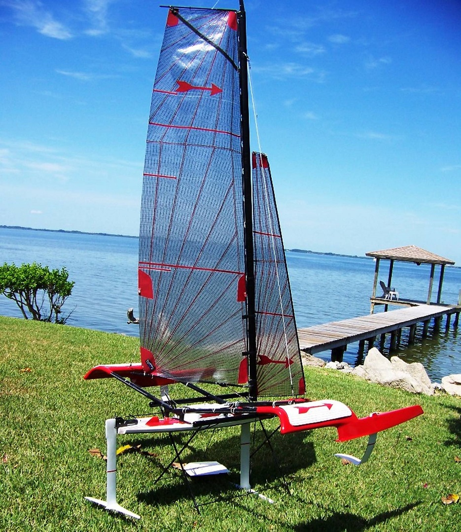

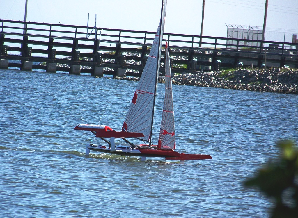

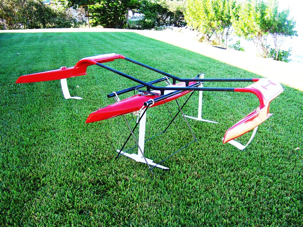

    Jay, the only trimaran in the world ,that I know of, using the altitude controlled foil on a daggerboard is my 5' test model. The advantages are numerous, but primarily much greater pitch control with the rudder T-foil and daggerboard foil working together and the ability to fly the main hull in very light air-way before it would do so because of wind pressure-and the fact that the main and rudder foils would control and maintain the angle of heel of the whole boat. Secondary advantages include the fact that as soon as the main hull flys, the main foil begins to unload, reducing drag. And a wand controlled main foil could also develop downforce if desired which would increase RM(-and also increase structural requirements). The amas use fixed UptiP foils which maintain altitude with no wands or other adjustments-this Test Model was the first trimaran of any size to use UptiP foils in the amas that I designed based on the original TNZ foil used in AC34.
    You can read more about the results so far in testing in the thread--the last two posts-- http://www.boatdesign.net/forums/mu...f-righting-trimaran-test-model-36058-144.html
    Fire Arrow on July 24th, 2014-the day she first flew. This Test Model is a scale model of a 20' full size tri designed specifically for this foil system which will fly the full size boat in a 5-6 mph wind. The Test Model pictures were taken in a 5mph wind measured with a Davis Windmeter:
