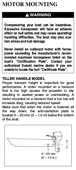

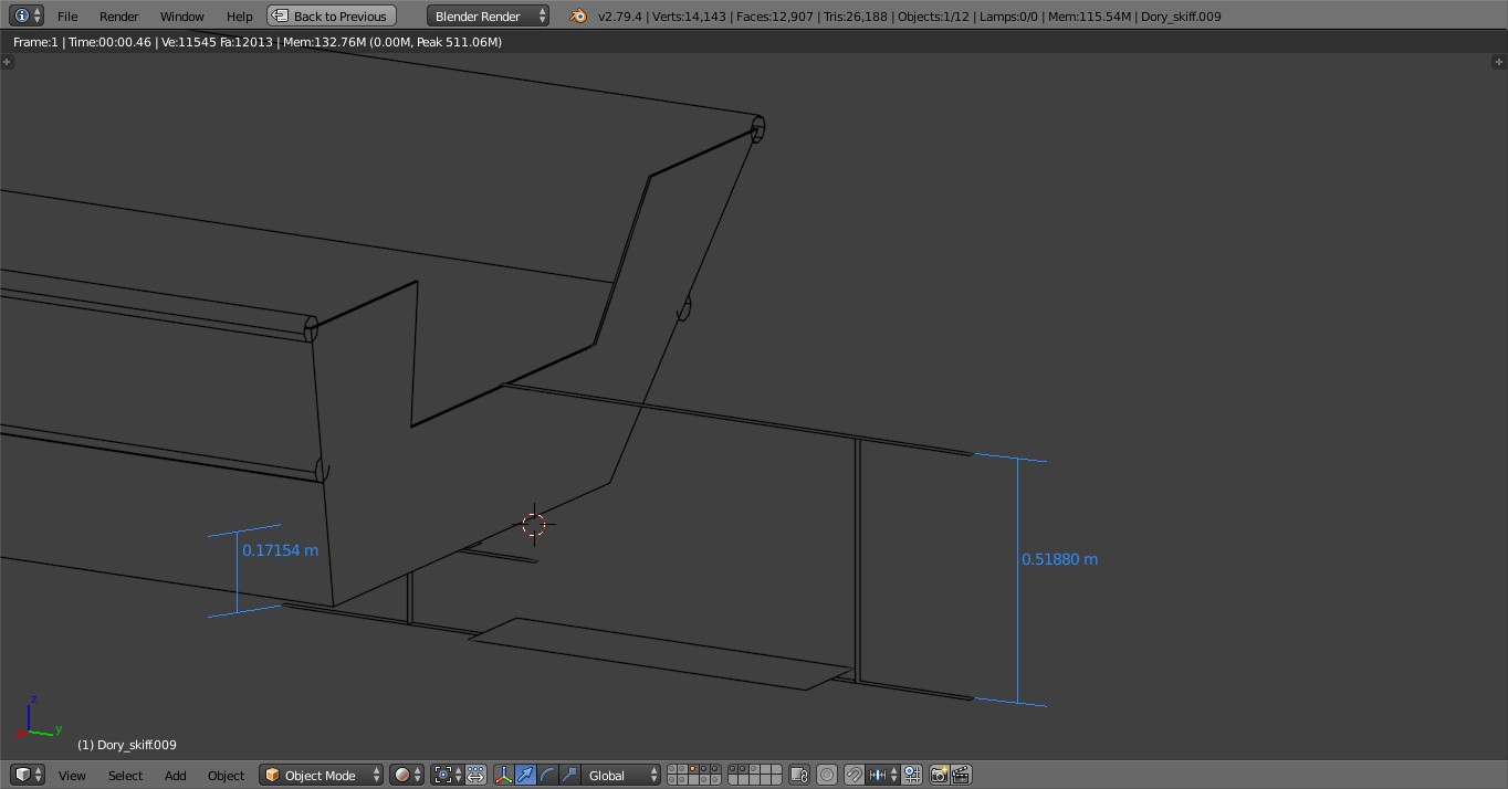

    Hi, I'm still here, nobody can tell me how to put the Suzuki 25hp outboard motor, I tried to find information about it and I understood that, the engine should be in this position as seen from the images below. I hope it's positioned in right place, compared to the hull and the anti-cavitation plate.If needed I can also provide the model if it can help to provide the corrections.

    A standard short shaft outboard typically has about 17" (43cm) distance between bottom of clamp bracket and cavitation plate. . On planing boats, the cavitation plate is usually set about 2 to 4 cm below the bottom of the boat. On a 22 inch long shaft (56cm) the plate should be positioned at he same distance below the bottom as in 2 to 4 cm. That will be the determinant for the transom height. Larger outboards often have a hydraulic "jack Plate" that allows the operator to control the relative vertical position of the cavitation plate. The cavitation plate is often raised so that it is even with the bottom of the boat when running in fairly smooth water and the best speed is sought. If the plate is lifted too high the prop my break out in a sharp turn so that it is ventilating. That is not what you want to have happen if you can avoid it.
    The outboard will have some trim adustment. That is it will have some provision for changing the vertical orientation of the shaft, therefore the propeller will either tilt slightly upward from the horizontal or slightly downward depending on the adjustment. Once again big motors (spell that big dollars), may have a remote controlled system for changing the tilt while underway. If the prop tilts a little bit up then it tends to lift the bow of the boat. If tilted down it tends to lower the bow. There are plenty of variables here. One of the variables is how the boat is loaded. If it is front heavy then the prop can help lift the front if it is trimmed to do so. ..................... The best positions can only be determined with sea trials.
    The tilt factor is what I had in mind when I suggested 14 degree transom inclination, in a previous post. Smaller Outboards, like the Suzuki 25, are typically engineered for that transom angle. If your buyer insists on 12 degrees, so be it. He may know something that I do not know. He can adjust tilt if necessary by using wedges with the clamp bracket. Also if the cavitation plate is a bit too low for best performance, the height can be adjusted with what are commonly called "rev sticks". That is simply a wooden spacer under the clamp bracket that results in raising the plate a little bit.
    All the comments above are subject to an examination of the actual configuration of the motor including its clamp assembly and the actual angular tilt measurements. That is simple enough to do and will be well worth your time to do so. If a buyer insists on some measurement or feature and that ultimately fails to not work as well as it might have, then it will be your fault for building the boat wrong. I have been there and done that.
    Best of luck to you.

    Now I am confused, for now I have made a correction and I have scaled the engine, the anti-cavitation plate is 25mm from the bottom of the boat but if you think this must be 4mm maximum, then I'll have to correct the position.
    In the weekend when I have time I try to do other parts of the project by going into the details of the metal sheets design.

    Parfurijaz, The detail of your most recent post is good. Let the plate be 2.5 cm below the bottom as in the detail. That is a safe place to put it and that location conforms to standard practice.
    Refer to my conversation with Gonzo, above, for additional commentary.

    The drawing indicates 0 to 1 inch. The top of the anti-ventilation (Not an anti-cavitation) plate should ideally be dry and not submerged when the boat is up on plane. Outboards have adjustment slots for fine tuning.

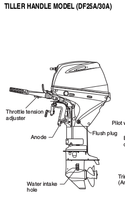

    I also had a doubt about it, but I kept drawing like the example ... But after you made me notice the obvious difference, I did a quick search, and I found a link with some clarification, I also downloaded the manual of the engine manufacturer, and in the manual that is the anti-cavitation plate .. as you can see .. I must however warn the guy that engine is too powerful to that kind of boat ..
  14. messabout
    Joined: Jan 2006
    Posts: 3,136
    Location: Lakeland Fl USA
    messabout Senior Member
    Gentlemen, be kind to one another. We are all in this together and we are not being helpful to the OP by generating a pissing contest.
    For my own part, I rest my case. Let us suggest that Parfurijaz defer to the manufacturers recommendation. (2.5 cm) .....Suzuki, Honda, Mercury, Evinrude, Tohatsu, and the rest, recommend pretty much the same dimensions. Special purpose racing lower units ....like a Quicksilver or other brand of special purpose unit are a different breed of cat. That is not what we have here and the conventions are different for the two types. The standard lower unit, as on the subject Suzuki, is more than adequate for general use. Why would one not do what the manufacturer says to do?
