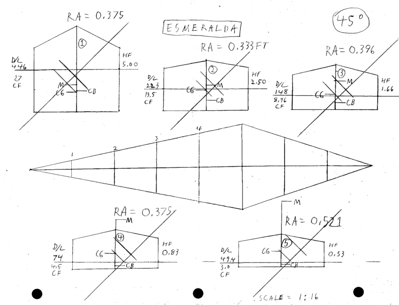

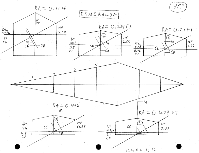

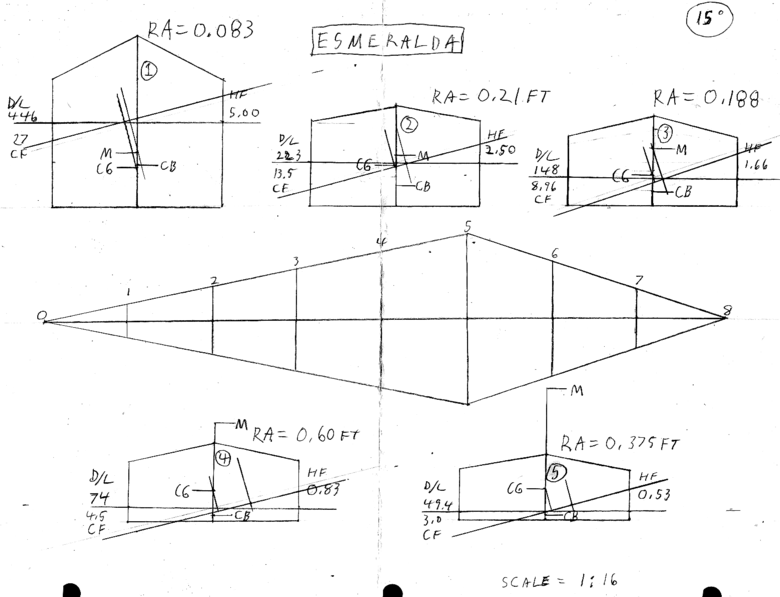

  3. sharpii2
    Joined: May 2004
    Posts: 2,046
    Likes: 206, Points: 63, Legacy Rep: 611
    Location: Michigan, USA
    sharpii2 Senior Member
    I think he confuses initial stability with ultimate stability, but in general terms he's mostly right.
    I think he projects small boat stability onto ships, which though flat bottomed, have much deeper sections.
    VCG location seems less important on boats with high Meta Center heights, which are not likely to experience high angles of heel. Your typical runabout is a pretty good example of such a craft. And this is where I think his thinking comes from.
    When the Meta Center height gets lower, such as boats with deep sections for their width, VCG placement becomes more and more important.
    Attached is a drawing from an experiment I once did, using a very simple flat bottomed boat, but making the sections ever deeper.
    Nothing else is changed. The design follows two rules:
    1.) Minimum free board must equal one quarter the Beam or half the draft, which ever is greater, and
    2.) VCG placement is one quarter the WL Beam, or three eighths the draft above the bottom, which ever is greater.
    The hull has a double arrow point plan view, so this effected its behavior quite a bit. I suppose this is because the average Beam was much smaller than the actual Beam.
    Notice how wildly the Meta Center heights varied.
