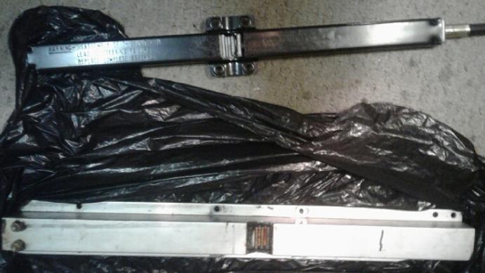

    Does anyone recognize this type of steering system? There is nothing written on any parts of it as far as I can find. It is on a 1968 Lazy Days houseboat and I'd like to find out who built it and how to find replacement parts, but how to find that out? The first picture is of the rectangular box that has been removed from the steering column, and the other 2 are different views of that same box in the hopes that it will look familiar enough to identify to somebody.

    It looks like a rack and pinion steering.

    That does look like what I've got. A local marine repair guy said a lot of the old Lazy Days had Morse steering systems and it looks like one of those to him. He also said they are hard to replace.

    You can buy new rack and pinion from teleflex. Otherwise, change to rotary helm.

    I surely wish I could buy one for any of those prices, but none of them are at all like what I need. Well, since my rack is still good the first one might do the trick but you can't tell what the rack end of the cable looks like so can't tell if it would match up.
  13. nopeda
    Joined: Aug 2013
    Posts: 13
    Location: GA
    nopeda Junior Member
    For a while I thought I found what I need at:
    Teleflex Morse Command 200 Boat Steering Cable SSC13036 | 36 Foot https://www.greatlakesskipper.com/boat-parts/steering-cables/teleflex-morse-command-200-rack-and-pinion/teleflex-36-foot-432-inch-morse-command-200-ssc13036-rack-and-pinion-boat-steering-cable
    Being untrusting of such good luck being possible I called and asked the sales person who assured me that the photo was an accurate representation of what I would get. At that time the photo they had up was of the same type rack shown here:
    Teleflex Morse Boat Steering Cable E300619-126IN-4448 | 10 1/2 Foot https://www.greatlakesskipper.com/boat-parts/steering-cables/teleflex-morse-command-200-rack-and-pinion/teleflex-morse-boat-steering-cable-e300619-126in-4448-10-1-2-foot
    which is the type of rack I need but not what I got.
    The silver one below is the type I need. The black one above is what I received. I called and complained so they changed the one photo, but not the others that are supposedly similar. Also I said I should be refunded for everything including all shipping, but they're not going to refund me for the original shipping even though it's not my fault for ordering something they showed a photo of that I certainly wish I was able to buy, but... And of course I haven't been able to find one anywhere and so far no one has been able to say where to find one. I feel sure there is one out there somewhere, but how to find it??? Of course maybe there really is not one, anywhere on the entire planet, as one person at Dometic (who took over Seastar solutions) encouraged me to believe.

    It looks to me like the by SeaStar Solutions shown HPS rack and housing is different from Teleflex, and and from the top rack and housing as shown in your post #13 picture it looks to me like HPS is what Great Lakes Skipper has sent you.
    It also looks to me Great Lakes Skipper first showed a false picture and false Teleflex text info on their sales website, at least for the rack and its housing, which website info they've confirmed to be right at your telephone inquiry, and from which you've bought.
    And it looks to me Great Lakes Skipper is now for the 36' cable showing what they're actually sending, but still give false Teleflex text info about the rack and its housing on their sales website, as per the above posted screenshot.
    Think Great Lakes Skipper owes you a full refund, including all shipping costs and your time, for messing around with the sales info on their website and over the phone.
