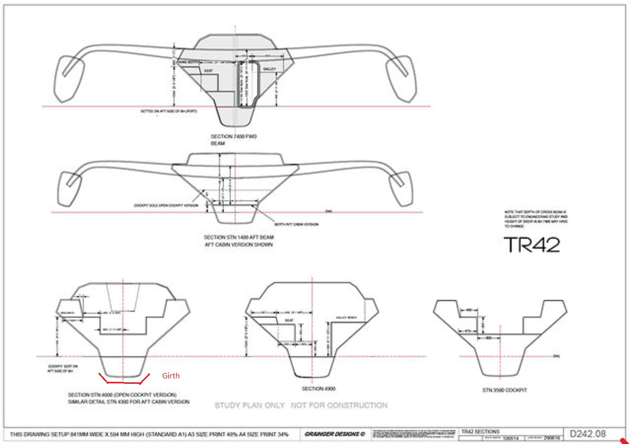

Can you post a midship drawing or a sketch with dimensions (the linear distance between that supports the hull at waterline, not exactly breadth). My formula is asking for a girth distance and have only estimated it.
Something like this?

If the program is asking for the service area then it is establishing maximum wave height it will be operating on. From there, along with the operating speed, the vertical acceleration can be established. If the vertical acceleration is computed, the impact area per unit length can be solved. The girth and length needs to be specified so that pressure can be established (F/A).
ISO 12215-5 does not ask for girth or computes vertical acceleration. This differentiates the two methods (LR, HnJ) and ISO uses to determine bottom impact pressure.
Vectorlam probably uses one of the two basic format hence the discrepancy.

Here is the mid-ship girth at the waterline you asked for... if I understand what you needed?

Now that you have shown the midship, can you show us where you place the longitudinals before we go any further.

Attached shows the (Red) longitudinal frame locations running along each chine made by the 5 hull planks. I won't need a longitudinal along the nearly 90 degree chine directly below the deck-hull joint.. You can also see the developed curve of each plank. Since the hull tapers, the framing is higher aspect near the ends, particularly the bow. Framing will also be added to support dagger board loads and rigging as needed. I haven't gotten that far along. I'm imagining the longitudinal frames to be about 1 inch wide, by 2 inch tall and the Ring frames to be 5 or 6 inches tall, but I need to work that all out.

The proper way to define the arrangement is thru midship in an example shown below. You need also to specify what angle is the chine. Below 150 degree, that is a natural stiffener. Above 150 degrees, that is a secondary stiffener which contributes little to stiffness. That way the width of the panel and the stiffener spacing can be established.
Let me see how you arranged the longitudinals. I see you have a center girder. That can be eliminated. I was wondering where you got that 12" witdh of panel.
After defining what is correct, I will show you the results of the calcs. What works and doesn't work.View attachment 165935
