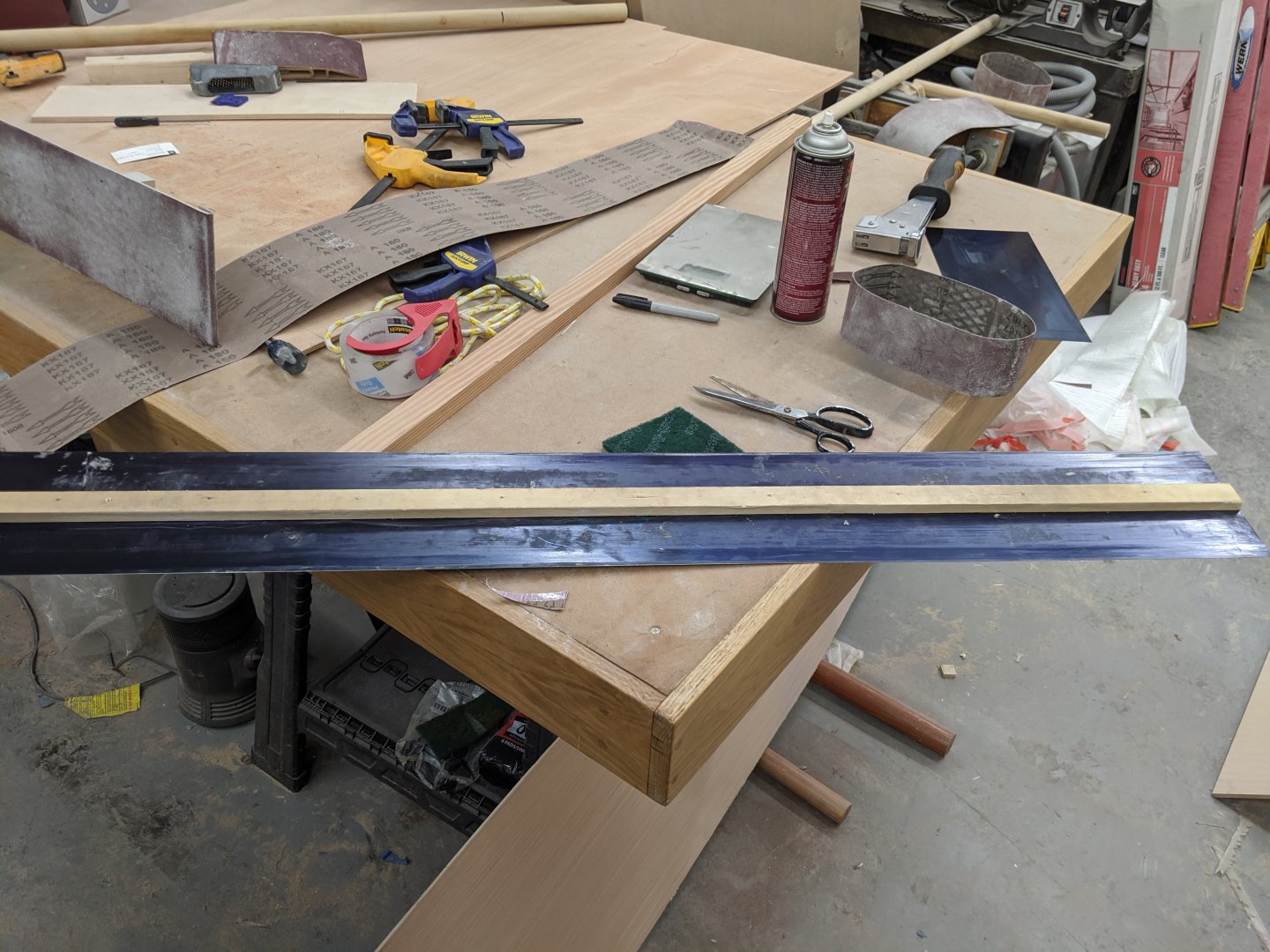

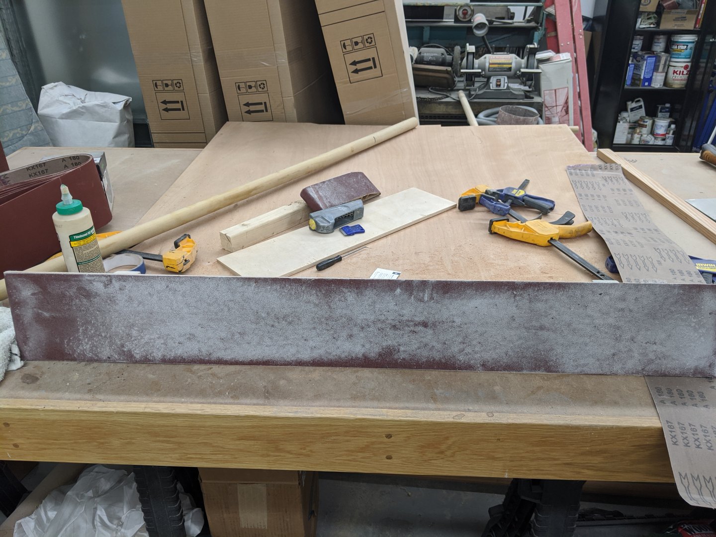

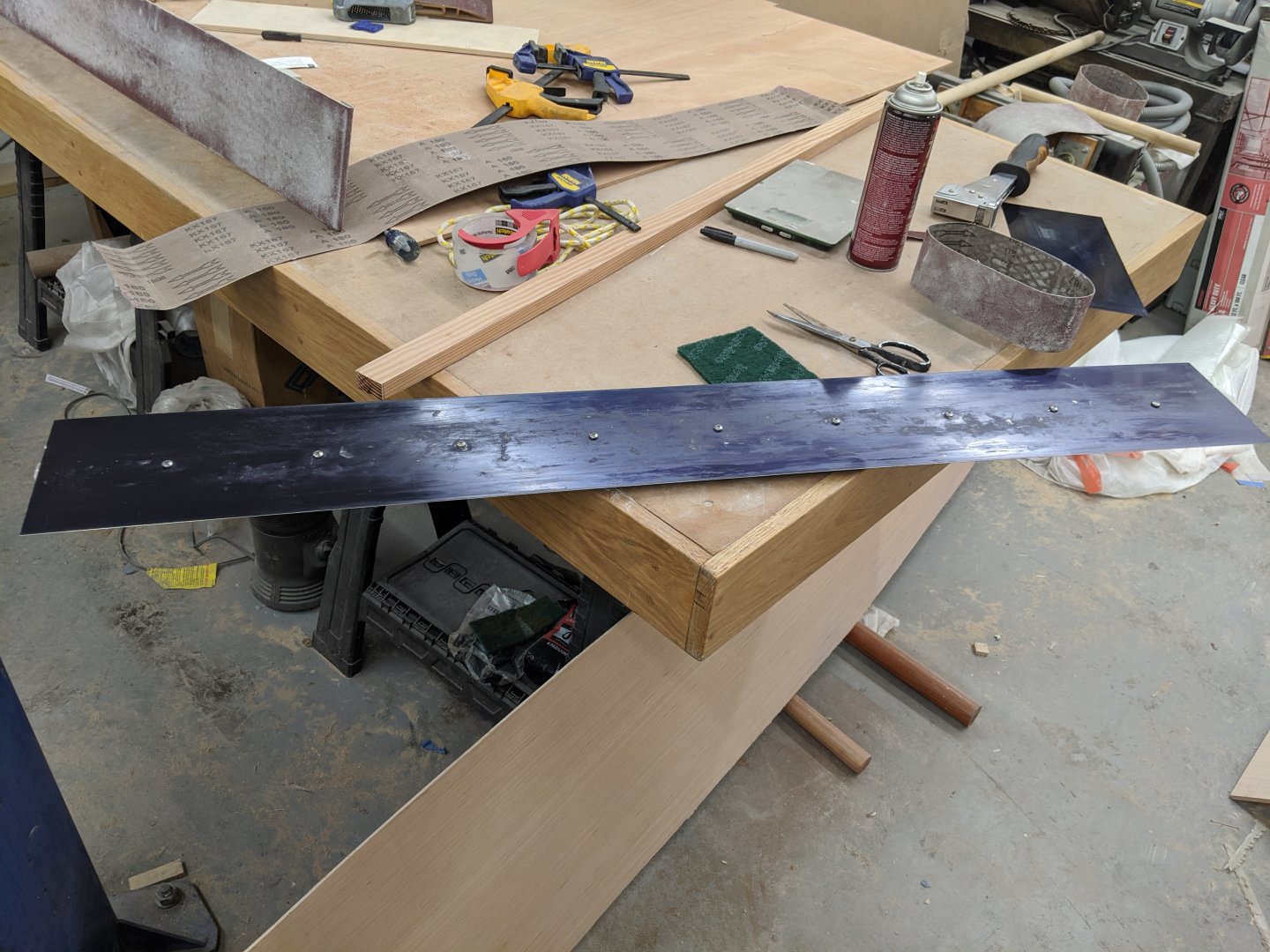

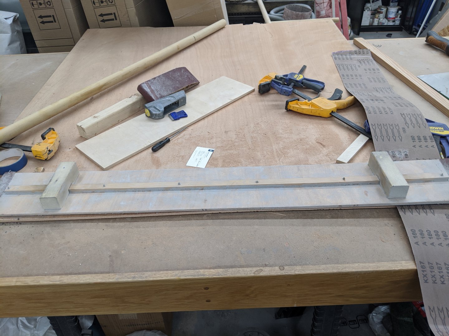

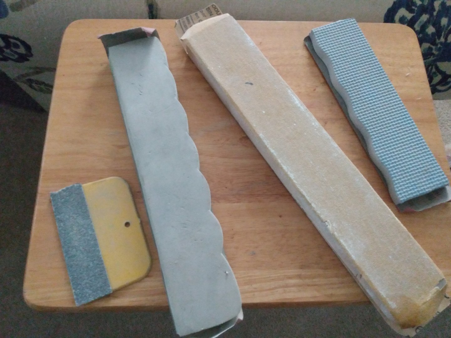

    I've made two sanding boards and a board to spread fairing compound. I used a batten down the middle on two of them to try to get them to lay fair to the hull. I posted pictures. I think the two with the battens work pretty good. The fairing compound board is .025" spring steel and the sander is 6 mm ply.
    Anyone else want to share theirs?

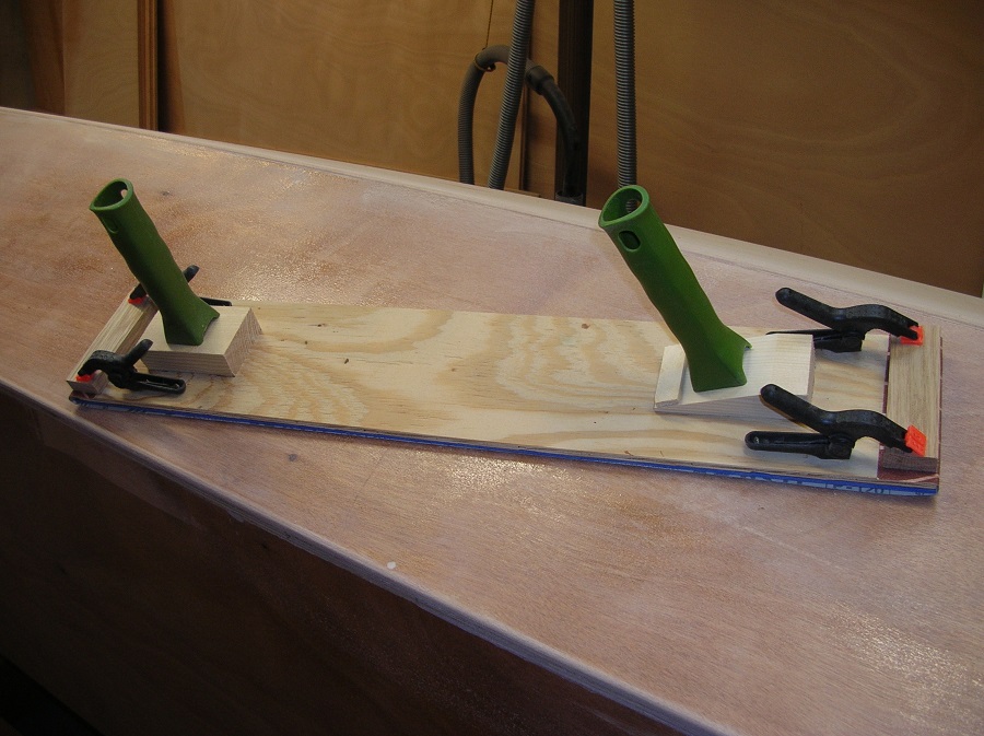

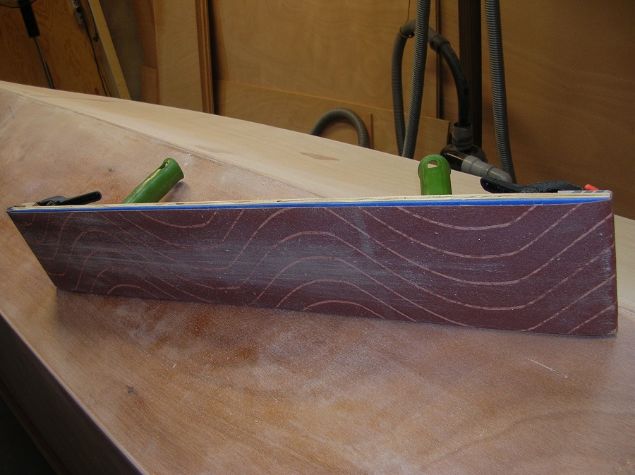

    I attached two handles on my board, so I can apply more pressure when sanding. The plywood board is lined with a firm foam rubber sole (ca. 2 mm thick, blue in the pic). It works well, but I had to change the sandpaper fixing clips shown in the pic, because its grip was not firm enough. Instead I use now a piece of a small steel u-profile with screws.

    Heimfried, where are you sourcing the thin foam from? I think that would be worth trying to see if it improves my results.
    Fallguy, the flexisander video was how I came up with using the spring steel for applying the fairing compound. Are you using the air operated version?
    Thank you both!

    Sorry, no source that could help you. It was kind of packing material when my marine plywood delivery came. It was laid under the plywood batch to prevent it from slipping. That's all I know.

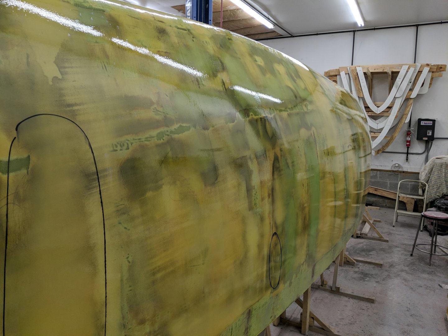

    My sanding boards still don't match the curve of the hull like the spring steel bog board does. I'm going to try some foam like Heimfried. My first hull is faired putting on the seal coats now. I did 7 or 8 fairing/guide coat sanding cycles before I thought it looked ok. Definitely going to focus on fairness of the mold for the next two.
