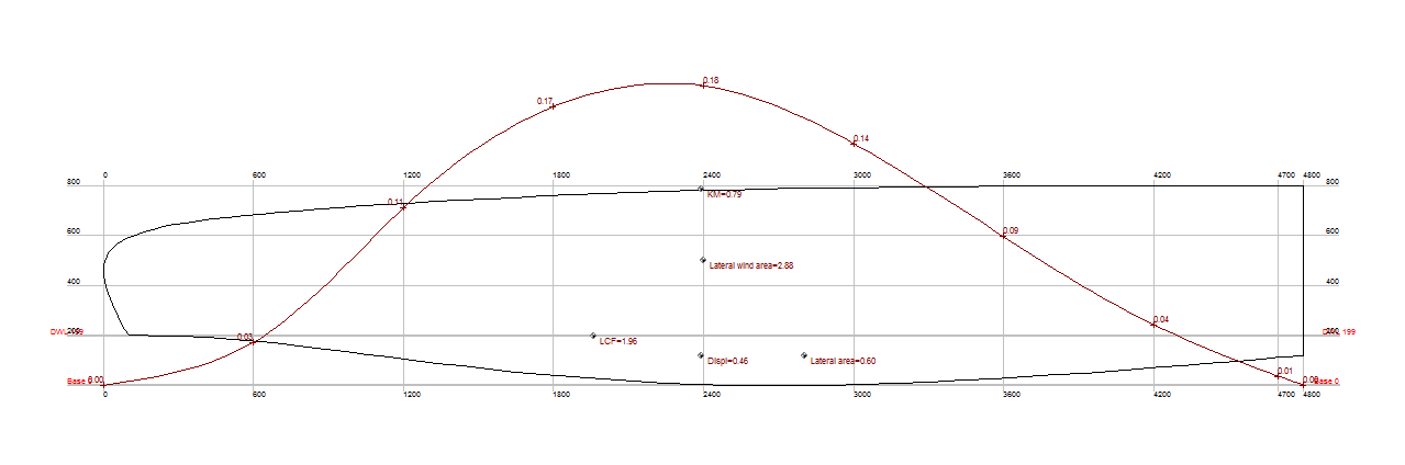

    this is my first post in this thread:
    ...Your design is not adapt to the performance you want.
    Here an EXAMPLE, my design, what is exatly you nedd.
    Is not 20 ft, and is not designed for to be built in plywood, but this is the geometry.
    Same disign, but in plywood and 20 ft long will have 7 knots with an engine 7 hp, and 12-15 knots with two engins 7 hp.
    An EXAMPLE.

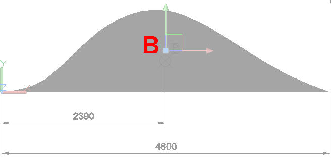

    Hi PAR, I understand everything you say and you are quite right. As always, I believe that giving bad advice can be harmful and to tell someone "leave your design and adopt mine" at least you should give a better design. So I try to make clear whether any design seems bad, explaining why. Free software can be used but what is not free is the analysis of the results we get from the software. Just to mention the most obvious thing I've seen, the curve of areas of frames that presents WindRaf has positive values on the left end, where there is no submerged hull. It is therefore a wrong curve. From there, what else can I say ?.
    In short, speaking for YotaTruck, do not listen to what he says WidRaf because it is unreliable, that is, because he is wrong.

    Doesn't look too flash at the stern end, either (curve of areas) ! :D

    According to the curve of areas that WindRaf has shown us, the center of buoyancy is located 2390 mm from the aft end, ie LOA / 2. That can not be considered as "very backward", as a "trained eye" can easily deduce (see post # 11).
    I'm afraid WindRaf is confusing the LCF with the LCB and the blame for this is not in the free software.
