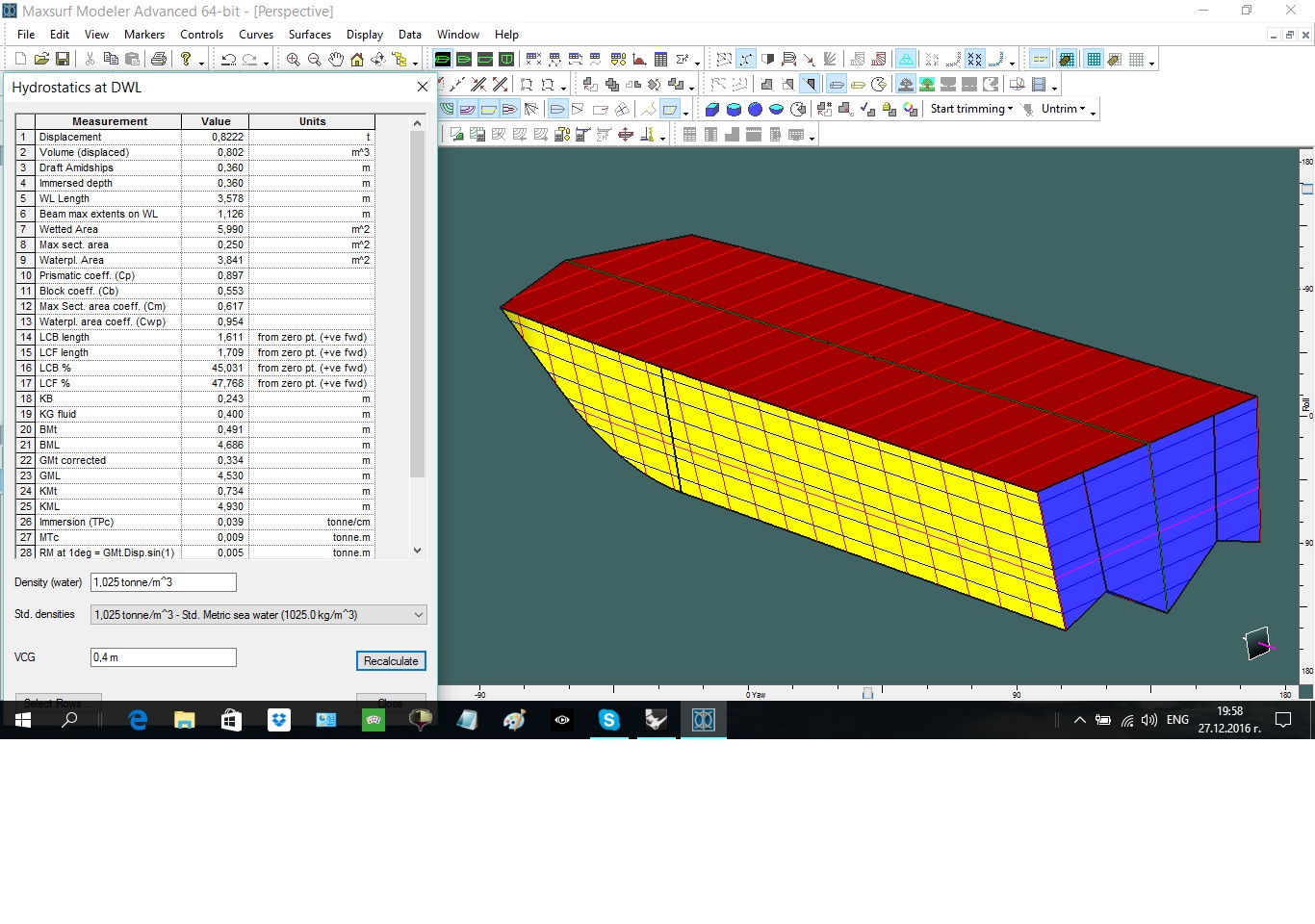

    Wow it really works!! How did you do that?? My new model (when I said it's resolved) is a brand new model with new size so that's why I think it's worked, but yours? It's the same one! Amazing!!
    I'm going to use yours instead if I may.. Really,, thank you thank you very much!!

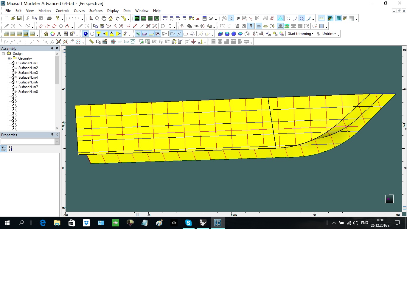

    Hello Rabah,
    No, I made the model with only bow and hull shaped particularly. The other shape is conditional, and since I don't know the good shape for them, I just made it like that.
    I'll accept any guidance to make it better..

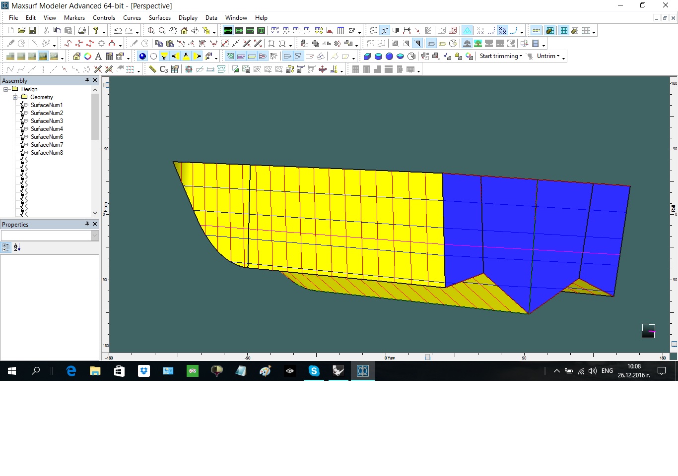

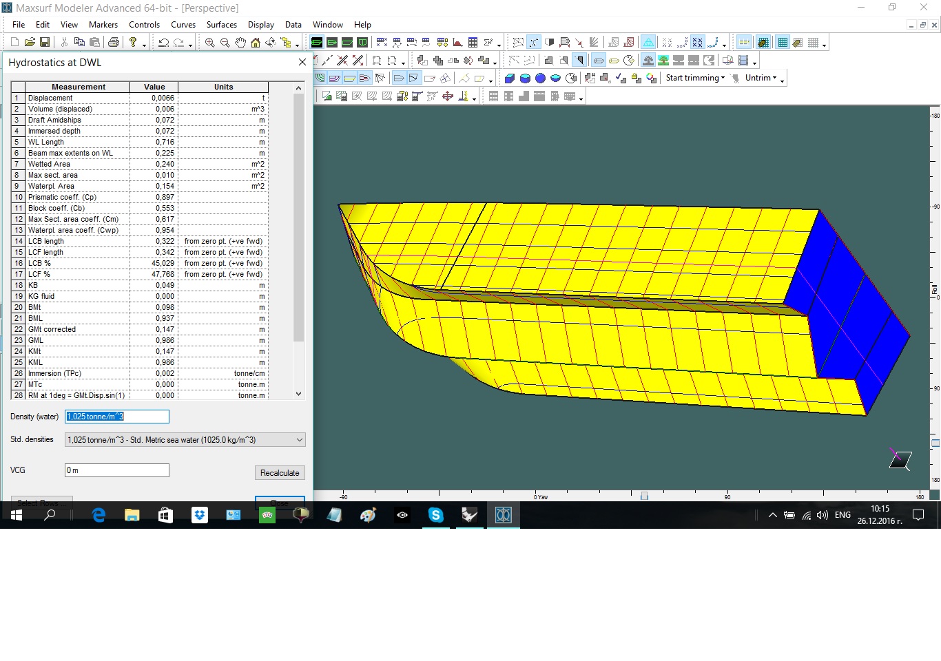

    Hi Endarkwolf,
    It is called a triple-hulled vessel /trimaran/ with outlines type „Volatile seagull”. It is used at motorboats with smaller ship dimensions. It has a main displacement body in CL and two additional laterals which call "sponsons". The reference for them is the following rule - keel lines of two sponsons always are above the keel line of the main body in CL.
    Major triple-hulled vessels like ferryboats and aircraft-carriers have three separate displacement bodies joint only with the Main deck.
    If we shall make scaling of this model with coefficient 5 we shall receive the following motor boat dimensioned:
    Loa = 4m; B = 1,2m; H = 0,75m; T = 0,36m

    Hi Endarkwolf,
    And what you will say about this variant - see the files?

    Once again,, it's awesome. What the name of this type? Can I use this design as reference? I guess if it's like this my prof can still count it as single hull.

    Hi Endarkwolf,
    It in effect is a mono-hull. The additional bodies are received only for additional volume at heel because augment the righting moment, that is augment the stability.
    There is no problem to use the model - I was made it for you. You can scale on what size you want.
    And on your old question how I have managed to make so fast this model the answer is very simple - all over again in Rhinoceros v.4 and then I unclose the file in Maxsurf Modeler /see http://www.boatdesign.net/forums/de...odeler-ready-model-other-programs-55792.html/
