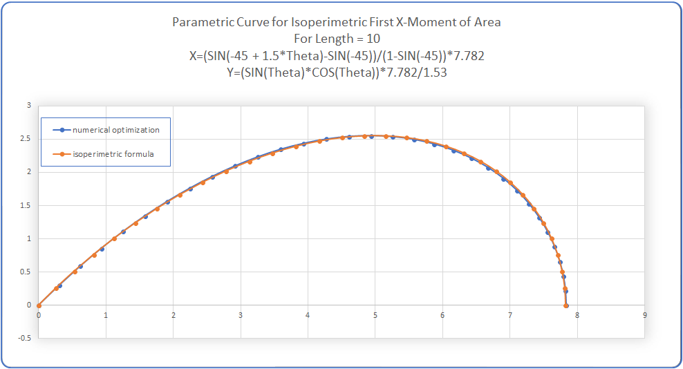

    Sorry for the delay, when I answered your question the first time I was 20 hours into my day and wanting to get to bed. I finally got around to cleaning up my cludge of a spreadsheet for generating and analyzing sectional shapes wrt righting moment. And I found the parametric expression for one particular case. There is no constraint on hull symmetry for the wetted portion, so imagine the hull centerline lies at the waterline.
    So here is the shape. It is shown upside down, but it represents the maximal first moment of area. I solved it numerically first, tried to run it through Euler Lagrange criteria, but unfortunately there were no ignorable variables to facilitate the integrations, and I had a nasty pair of nonlinear, nonintegrable, intergal - differential equations. So I went back to curve fitting, and eventually guessed the right family of curves and made the fit.
    In the formula, theta goes from 0 to Pi/2
