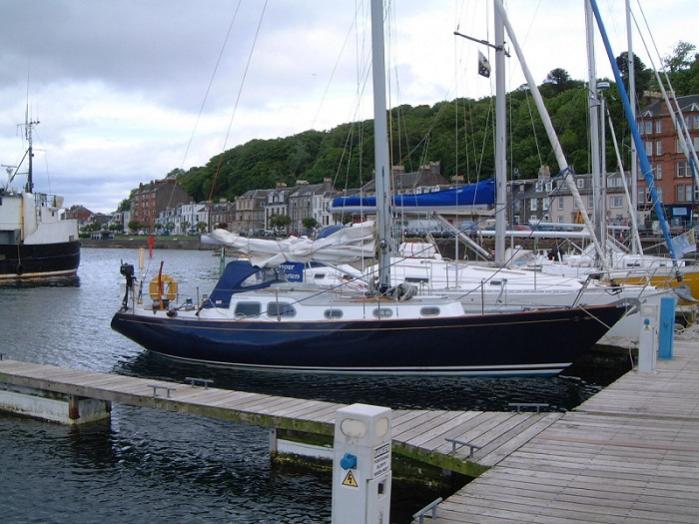

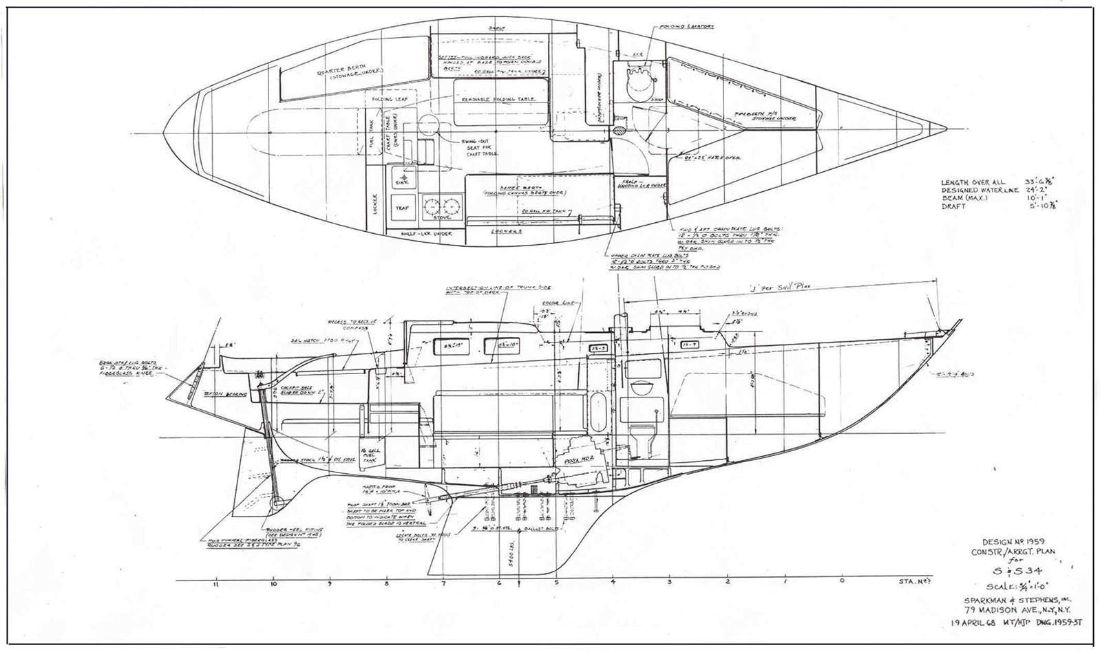

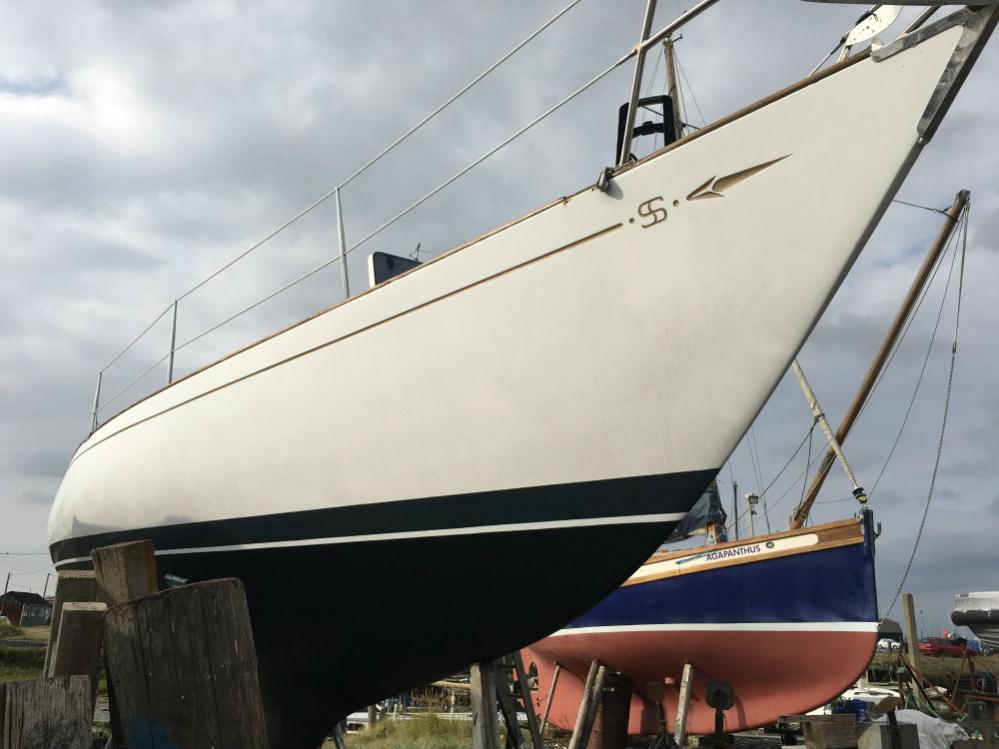

  8. bajansailor
    Joined: Oct 2007
    Posts: 1,921
    Location: Barbados
    bajansailor Marine Surveyor
    The S & S 34 is an excellent example of tumblehome being used well.
    And they are a joy to sail - well balanced and very stiff - when the wind picks up she heels a bit and just starts stomping along, very happily.
    Re the photos below, the blue hull is Earlybird, and the white hull is Kite - both live in England.

  11. colinh
    Joined: May 2018
    Posts: 5
    Likes: 0, Points: 1
    Location: Lancaster
    colinh Junior Member
    Thanks everyone!
    I don't fully understand Phil's RM explanation, although I can believe it's correct. The upward force on the lee side comes from displacing a volume of water, and for a given circumference a circle (cylinder) has the greatest area (volume). On the other hand the distance from the centre line doesn't increase... But, I think the point is moot since there's no particular need for the hull area to be a minimum. For a given beam, flat, vertical topsides would have the greatest volume.
    Thanks for the photos of Jazz and Peregrine. What make are they? Are they the same boat type? Actually, from the photo of Jazz, that seems almost bit too much tumblehome and transom narrowing.
    So, wetter, less deck space, and in the case of the S&S 34 with its significant narrowing towards the stern, a lot less living space.
    But the S&S 34 does look good. And its owners seem to think it's the best boat in the world...
    I found a set of lines for an S&S 30, which seems to be just a scaled down 34, or very close to it. So I'm studying those now...
