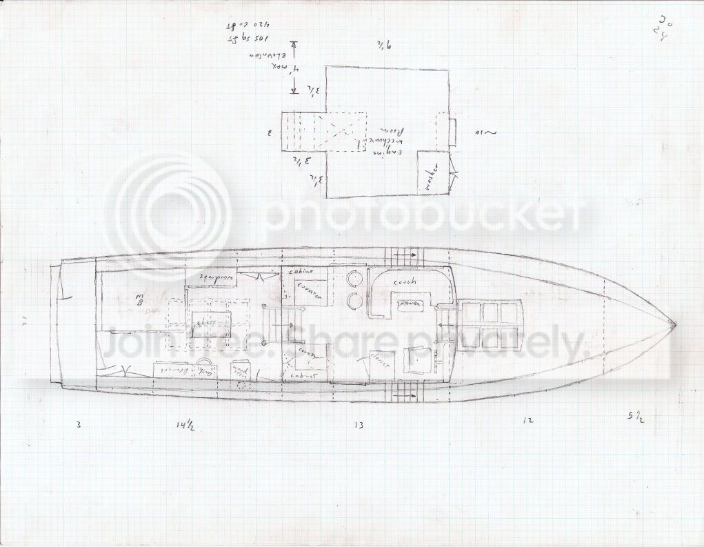

    ok on my plan of the aft cabin the heater/wood stove is offset under the cat walk and not directly under the designated stack. This means that I have to angle the flue over to the stack and they up alongside the engine exhaust and combustion air/ventilation. So the questions is are these things so finicky that its a really dumb idea to play god with the flue or am I limited to venting this thing virtually only ( a generalization to be certain but as a whole is this a limitation I need to be worried about )
    you can see in this plan view what Im talking about best
    starboard side just to the left of the steps leading down to the aft cabin is where the stove is. Ive added a mantle since that drawing but its position was determined by its need to allow access to the door of the head and the max angle of the flue given the height of the stove and the elevation of the cat walk above plus the distance to the stack
