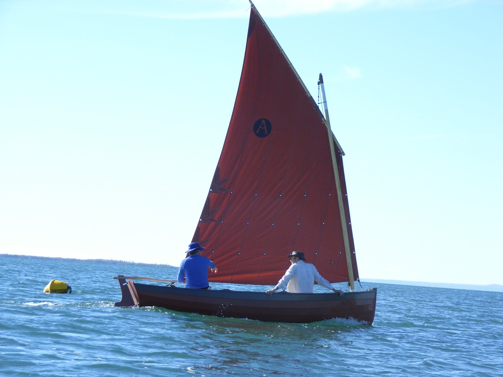

    The physics of lug are becoming more clear, but I still can't figure out how to make it work.
    If halyard is attached to the middle of the yard (center of gravity), then it's obviously the pivoting point for the yard. With some friction between mast and yard (and lashing to keep them together), the peak of the yard goes up, and the forward end goes down. And then it gets stuck in that position.
    So how does one raise the lugsail yard without these problems? Especially high-peaked yard, to which halyard cannot be attached to the middle?
    For example, here http://3.bp.blogspot.com/-TplyERYW_5Y/UBfLwnNUd-I/AAAAAAAABDw/OejC2MhWA1w/s1600/Aber+Sailing+Ricoh+029.jpg
    This is pretty close to my design. Can someone explain how can I raise the yard without these complications with a single halyard?

    Laukejas,
    I have been away from my computer and did not see your trials until now. for the yard to hold up the sail on a lug you have to attach the halyard near the center of the yard, and you have to have a portion of the sail ahead of the mast to blance it out.
    I have not found the lug rig that user friendly when hastily made, perhaps others have made it work, but I did not spend the time to work it out. I have made simple modified junk rigs work will well. cut flat, with just three full length battens, and the plan form was roughly ellipitcal. no boom, just used the bottom batten (though a boom held in place with a snotter might be helpful to allow better adjustment). we have won a number of local "build and race" type contests with this simple rig without any testing or adjustment. it just takes three flexible full length battens, and duct tape and some string. No sewing required at all! I put some small triangular pieces of plywood in the folded over sail at top and bottom where the halyard attaches, and the down haul, and drill a hole through it to tie to. this spreads the load out over more fabric to make strong attachment point. I also but caulk or adhesive between the plywood and trap cloth, but mostly it is the several layers of duck tape that spread the load over the fabric and make the attach point strong.
    you can get some camber in it by folding a hem around the perimeter and running a string around it, pull the string tight and it kind of "cups" the sail to give it camber. but I have not found this extra work necessary, using it flat seems to work just fine. far better than all the other improvised sails in the races we entered with it.

    The yard is actually held up by the halyard.
    Since the lower, forward corner of the sail is held down at the bow, and the yard crosses the halyard, the yard acts as a lever. It would do the same if the lower corner of the sail were attached to the mast, as long as there is some yard that is past the halyard. This would be true even if all the sail were behind the mast.
    The halyard attachment is the fulcrum. Some gaff rigs (usually with very short gaffs) have just one halyard and peak up just fine. (see attachment)
    As you can probably guess, the amount of yard in front of the halyard, being much shorter than that behind it, puts terrific tension on the leading edge of the sail. this is good, as it keeps the leading edge straighter.
    But the sail cloth and re enforcements must be strong enough to stand the load. The halyard too is under the same load. If this leading edge stretches too much, the sail will lose its profile shape.
    Usually good windward ability with sails with long, clean leading edges, require a great deal of tension.
    This is why lug sails made of poorer materials (like the one I sketched for you) usually have much shorter leading edges and have much more of the yard in front of the halyard. It's a design trade off.

    Sharpii2, thank you for explanation. But could you (or someone else) explain me how this works (it's Goat Island Skiff). I tried re-creating it just now, and what happens is that the yard slides all the way forward until the pulley on the yard reaches the pulley on the mast top. I see no more additional lines that would prevent yard going forward...
    P.S. And in this design I see no lashing between yard and mast at all! What prevents yard moving around?

    The yard will find its own equilibrium when the wind pushes the sail. On the goat island skiff, remember that there is also a downhaul which prevents the sail going all the way up. Also, the yard is supposed to go forward! Put the pulley about where you want the halliard to "attach" It is rigged that way so when you release the halliard the yard comes down easily.
