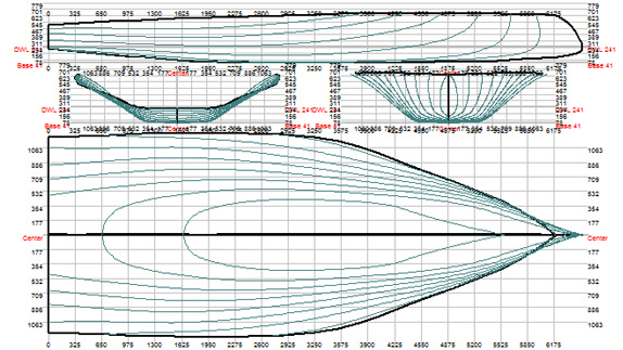

    This is a tentative 6.5 metre, not mini-Transat, water ballasted, T foil dagger and rudder, moderate small wing mast rig. Kind of like a larger version of my 5.5m but with single mast.

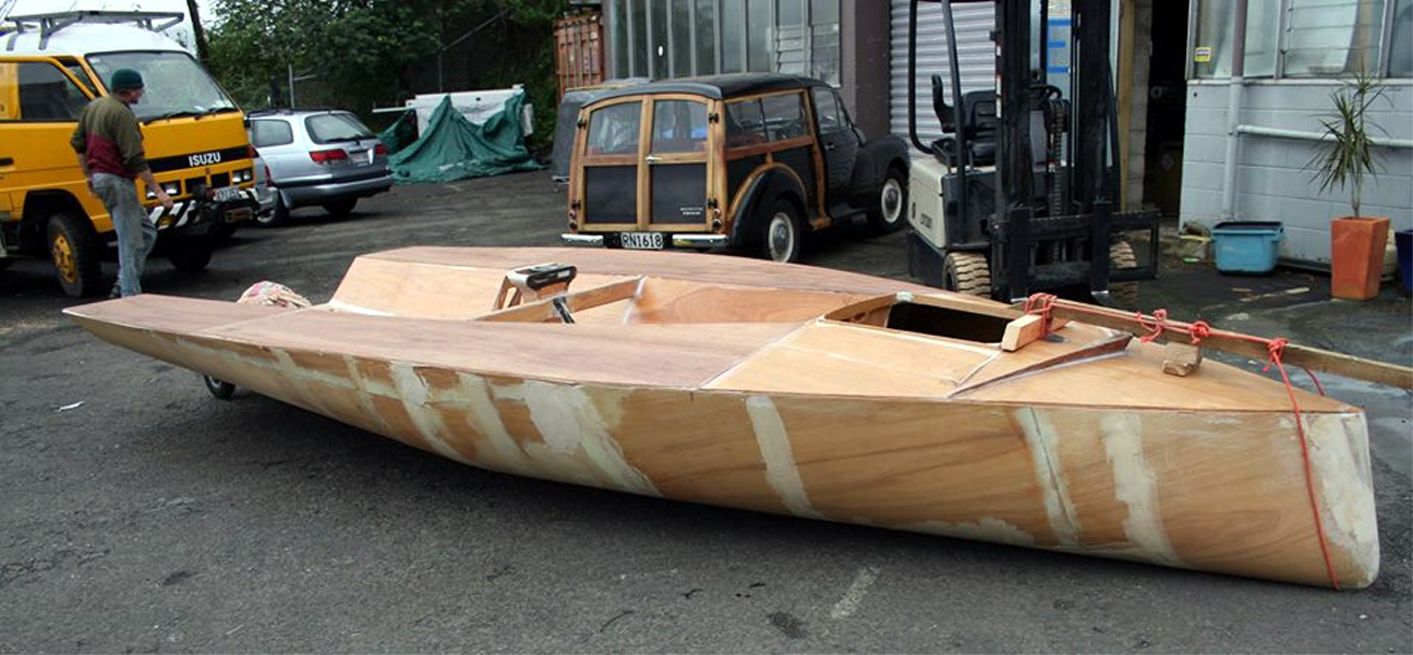

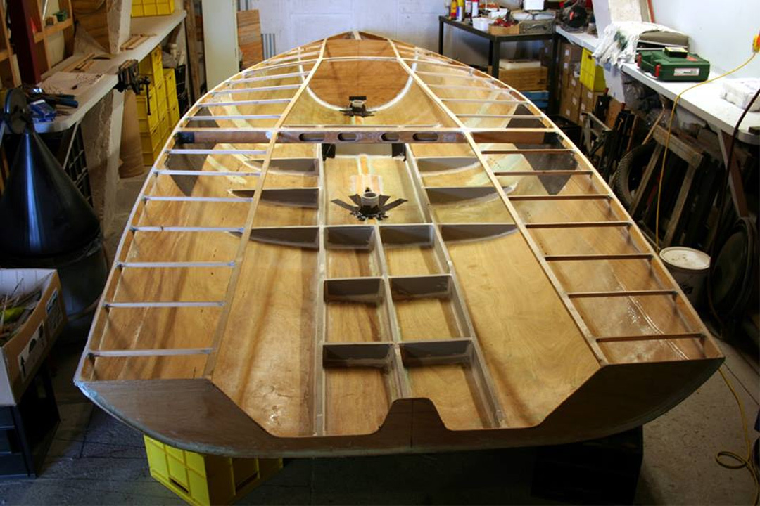

    Here are a few building shots of the 5.5 metre Coxs Bay Skimmer in tensioned ply with glass, carbon and some foam, very simple, not expensive, very light.
