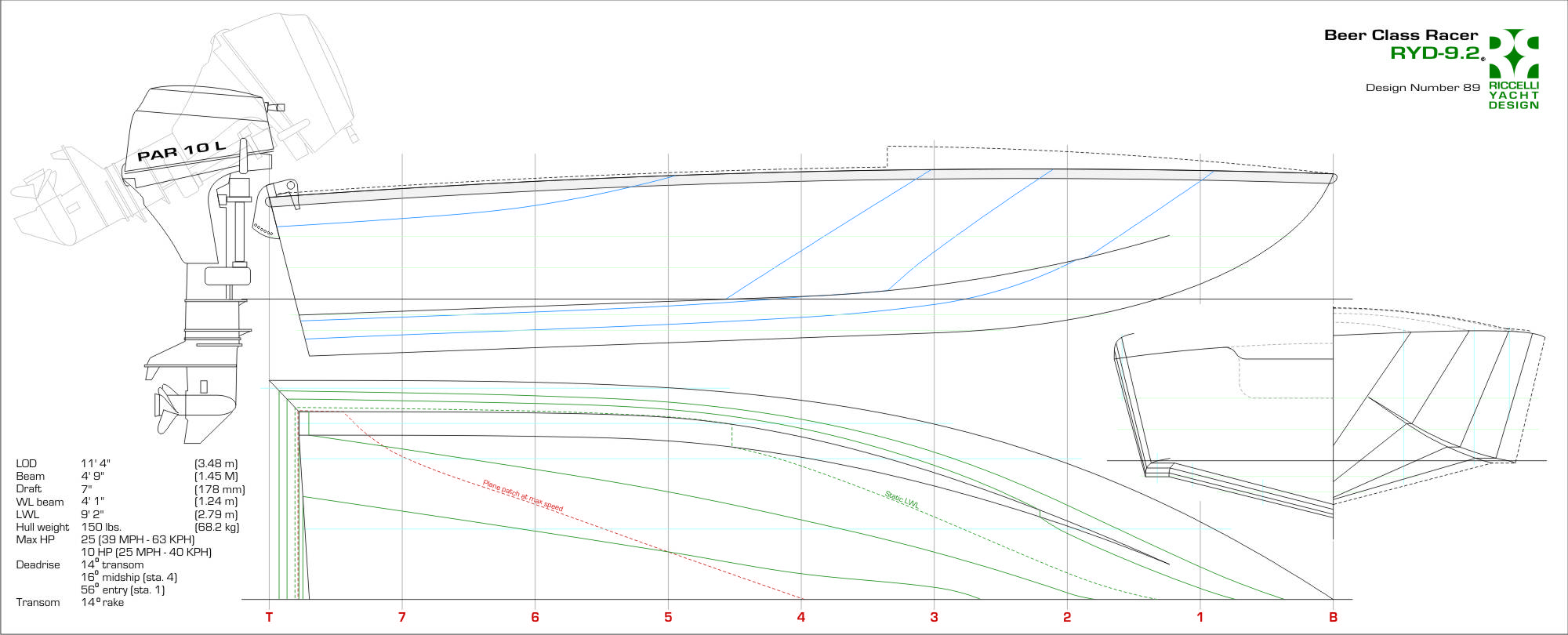

    That's basically a garvey style of hull and the various parameters about hull design fill several books, which you might want to invest in. There are plenty of plans available for this type of boat, some with CNC cut files available, so you might want to look around.
    You transom deadrise doesn't appear to be anything close to 12 degrees, more like 5, maybe less (how are you measuring this?). This shallow a deadrise will permit the boat to get up on plane fast and accelerate quickly, but it will also pound unmercifully once you get over 30 - 35 MPH.
    Attached is a little boat I did recently and it has a 14 degree transom deadrise. It's nearly a perfect monohedron, so will do very well are high speed.

    Dead rise is measured from a horizontal line across the transom, at the centerline. So if you have 6 degrees, that's how much deadrise you have. Low deadrise and flat bottom boats do poorly in a chop. The garvey shape you have will be slightly better than a flat bottom, but not much, because the bow is too bluff and the deadrise so shallow. If you want to "soften" the ride an appreciable amount, you'll need at least 10 degrees and a much finer entry 1/2 angle too. Of course, with these changes, she's not going to hop up on plane as quickly as a flat or low deadrise bottom will, so you may also want to add some strakes, the help "get 'er up".
