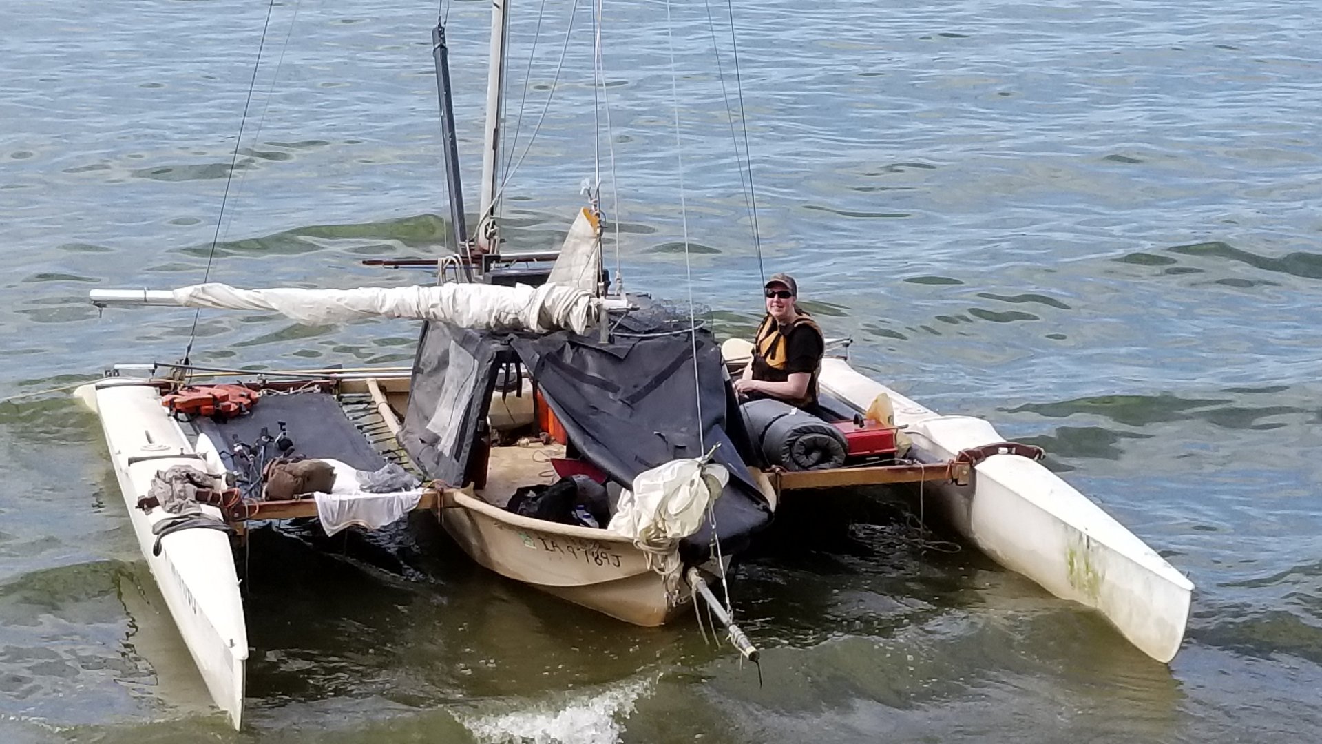

    I suppose if you have snow-melt all the way, you can save a lot on the potable water. I had zero resupply opportunities in the Everglades and other coastal trips. I love the RS Aero, by the way. My concept for the Everglades Challenge is to use the Aero's rig and a custom hull with the underwater lines of the Aero. But there again, It's a short duration race with resupply opportunities every 12 hours or so, and even then, I want to modify the hull pretty significantly. A particular motive is to support navigation and electronics, which are needed in the race.
    Also, camera gear has gotten a lot more convenient in the digital age. My partner and I used to both carry fairly basic camera kits that weighed about 3o pounds each. We had modified tripods for setting up in the water that were about 15' tall. And we had lots of flash power for night photography of wildlife. These days, a drone and a GoPro could do as well at half the price and a tenth the weight.
    Solo, I can go for just under 1 month on 3o kg in the conditions of the Norway coast if I have a reliable supply of fresh water. But it's a fairly bulky 30 kg when all the seabags and hardpaks are accounted for. Also, I used to carry six sails for my 16' dinghy. All were 6 oz nylon or heavier. My mast was a Dwyer DM 375. It's spreaders were heavier sectioned than the RS's mast. I could cartwheel up the beach in the surf without damage. You can't do that in an RS.
    So if you want to beef up an RS, add lots of hull volume forward. You need an isolated deck access for mooring gear and spares in the bow, and an open, but securable cuddy for waterproof containers and for hiding electronics. Beef up the bow and transom a lot. You should be thinking about 10,000 - 20,000 pound rated hardware being mounted to the bow and transom, and it should snap and not pull off the boat. I'd use 1" hardwood ply with glass over it. The ends of little boats take a beating. I've had an old outboard literally beaten to pieces hanging on my dinghy when a houseboat tore apart a fuel dock in a storm, and the houseboat and a lot of the dock ended up in the slip with my dink. There was nothing left of the outboard except the clamp, but the dink was fine. It took me a week to patch the all the holes in the houseboat.
    Use a stronger mast - like ten times stronger. Set up the boom on a slide so it can be raised and lowered on the mast. Your first reef is rolling the boom up and leaving the sail topped out on the mast. Make a self-tending boom jib for the boat. It should be about 3/4 as big as the standard jib. It can also be flown at different heights off the deck by using a tack pennant. I prefer full battened mainsails for this job also, and have had good luck resizing Hobie 16 mainsails, which can be had for a song.
    Use bigger boards and rudder and make them stronger. This is the number one problem with production boats. Since these bits are expensive, they are always too small and too weak for running up onto a beach in the surf. I'd use about 28 mm thick for the board (solid wood or glass, no lightweight foams), and about 22 mm thick for the rudder. The rudder kickup mechanism can't be too strong. I used 1" SS bolts running in 1" boiler pipe sleeves for all my pivots. These were built into solid heartwood mahogany cheeks 5/4 thick. This is what took the hit from the first Honda Civic that hit me while trailering. The Civic was totaled but my rudder was fine and I continued to go sailing that day. The transom and rudder sheared the A pillar of the Honda and the car's engine went between the hull and the trailer, straightening the hooks of the tie downs out and launching them a 100 feet in the air, according to a witness. The car was doing about 50 mph and I was stopped. I had a rudder gudgeon give out when I was a kid, and I plan to not ever let that happen again. Imagine the boat completely filled with wet sand, standing on its rudder and board. It needs to be able to do that. Because if you get the tide wrong, or the wind wrong, that's what happens when the surf plays with your beached boat for a few hours.
    I'll be interested to see what that fellow's RS looks like after 20 years of doing this. I've already posted pictures of my dinghy at 20.
