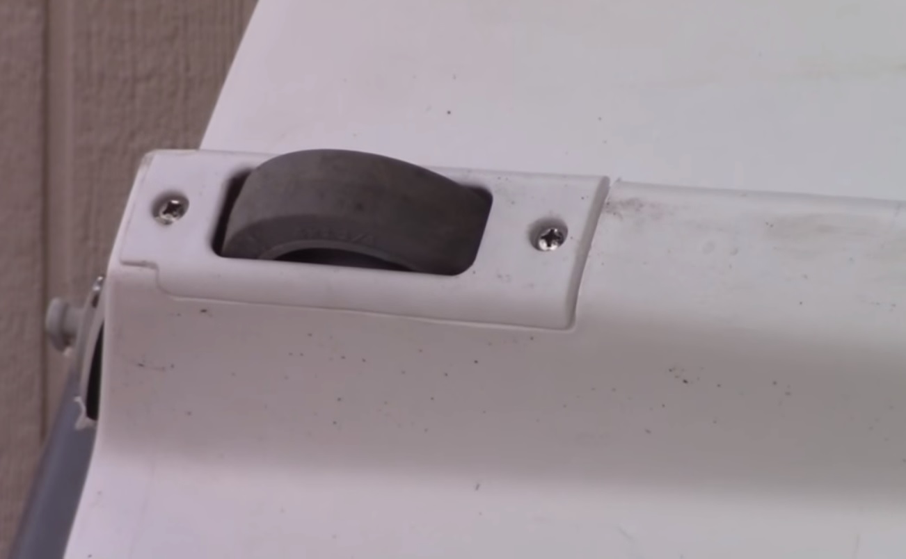

    Note the little wheel on the aft end of the Walker Bay dinghy keel, for ease of dragging it around on the hard, and to prevent wear on the hull.
    The little permanent aft wheel is shown in this video from 0:07 to 1:09, couldn't find it on the Walker Bay website, of course it will cause some added drag plus weight and costs, but it could be considered for your dinghy.
    Good luck !

    @Angélique, good idéa with the wheel! I haven’t calculated the weight yet because I do not know what material thickness is necessary for a boat like this and I don’t know the density of the polyethylene that is used (that might be easy to find out). Do any of you know? If I had the density and thickness of several material options, I could do some calculations and compare the results.
