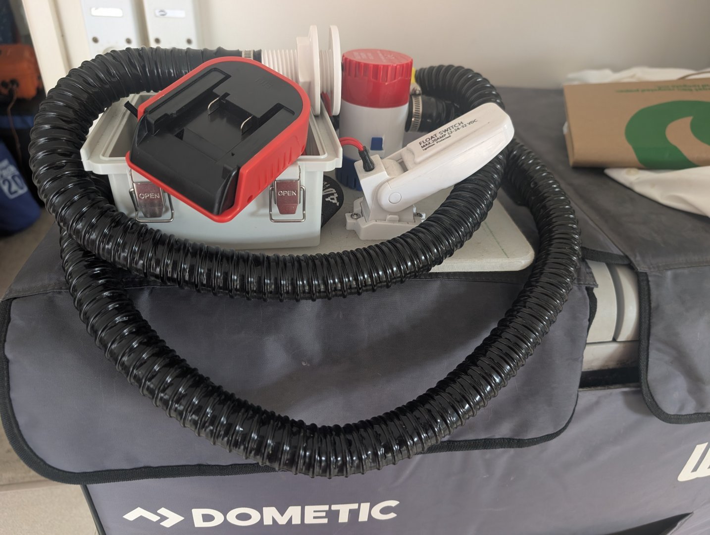

    This is a suggestion not specific to sailing, but aimed at baling small boats that need regular bilge draining; and you mentioned an electric pump back in the thread a bit.
    I needed a compact solution that could be moved between craft.
    Many modern bilge pumps run on a range between 12 and 24 volts and I use power tools with 18V batteries that provide a lot of electrons in a compact size. I found adapters for them online to feed power to the pump, and if your pump has a float switch you won't need additional switching. Put the tool battery and it's adapter in a waterproof container (food storage works), with a cable gland to slow water entry, onto a sealed Deutz connector, with a light flexible outlet hose to throw over the side.
    This was the prototype I used for kitchen sink testing, but in the field it should have the battery more protected.

    Yes, I was wondering if such a pump could be an alternative to a false floor or self-bailers if I manage to limit capsizes to say once per sail. Thank you :)
    The set-up would need to be ready for full submersion. Maybe a small motorcycle battery or a NiMH would be a little bit less of a concern than such a powerful Lithium battery. If it would be mounted close to the daggerboard case its additional weight would not hurt so much...

  11. HelmutSheina
    Joined: Dec 2025
    Posts: 36
    Likes: 8, Points: 8
    Location: New South Wales
    HelmutSheina Junior Member
    Talking very little extra mass for a pump with a small drill battery.
