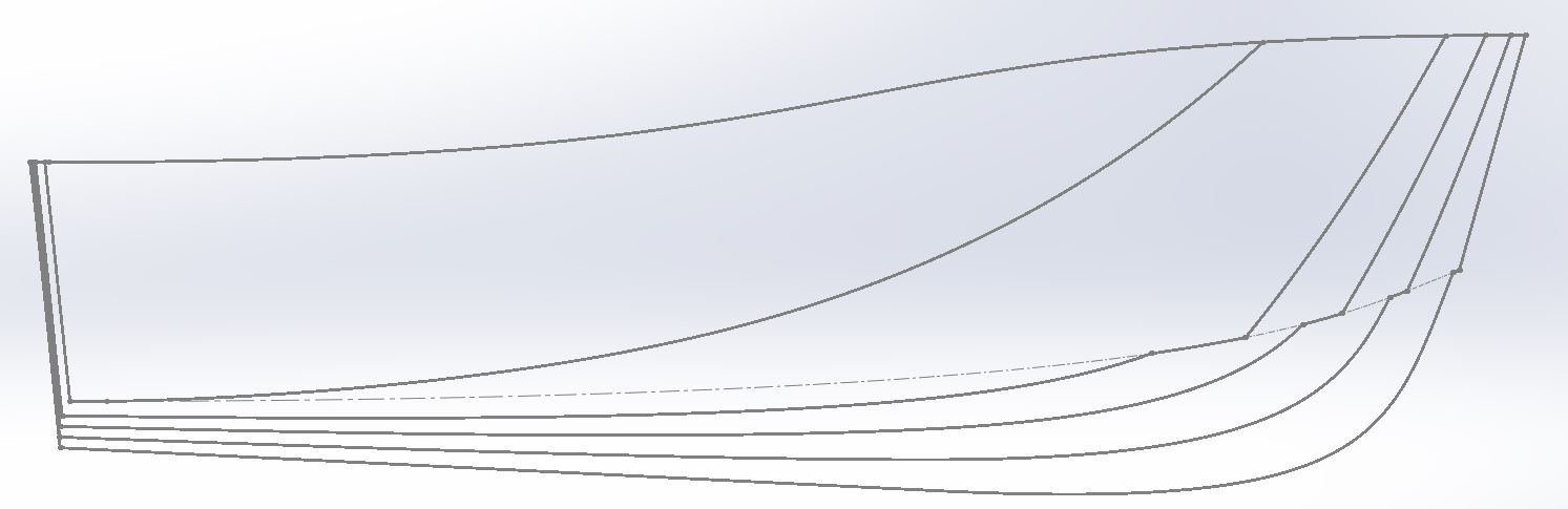

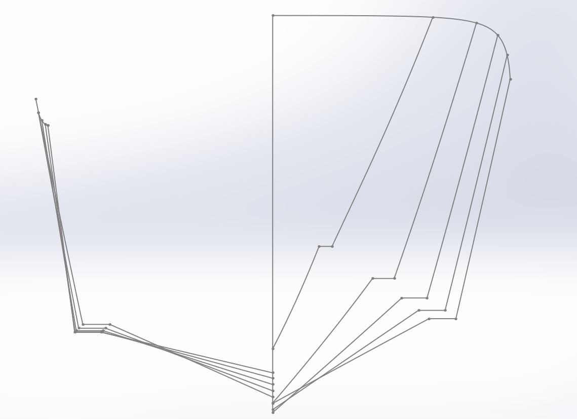

    Folks,
    I built a boat a while back, and am contemplating building another. Having been unable to find a set of plans that meets my "needs" I'm toying with a design of my own. Would love a little input from those more experienced than I.
    At this point I'm mostly interested in thoughts on the hull shape. I haven't done enough work on the innards to figure out weight and distribution to know what I expect the waterline to be which makes it tricky, but I gotta start somewhere.
    It's a 25' constant deadrise 20deg hull with a chine flat that carries all the way forward for initial stability and spray deflection. The lines are designed for plywood sheet construction. I'd like to power her with an inboard. Preferably diesel but given costs it may end up being gasoline. I'm guessing something in the 200hp range would be good for around 20-25kts.
    The intent for this boat is fishing and diving off the California coast where things can get pretty hairy. I want a hull that can make it home in comfort when the weather comes up, and that has a place a couple of people can overnight when desired.
    Lines and early renderings attached. Would LOVE to get your thoughts.
    Thanks!
    -Ben

    It might be interesting to place a keel/skeg that, besides protecting the propeller and rudder, increase the drifting area of the hull.

    I've thought about that. Would that add considerably to the drag (ie: make the whole thing less efficient)? I was kind of thinking that with the constant 20deg deadrise I'd be okay from a tracking perspective without the keel, but protecting the prop is always a good thing.

  5. PAR
    Joined: Nov 2003
    Posts: 19,133
    Location: Eustis, FL
    PAR Yacht Designer/Builder
    For a dive platform, that hull will be a rolly thing, though comfortable in a slosh at speed. You should consider a different approuch than the constant deadrise hull form. I'd make the entry finer, so you can get through the harsh stuff, but decrease her deadrise, so she'd enjoy more initial stability, which the divers would appreciate. This is a high speed hull aft and a wave basher forward. Unless you intend to target speeds over 30 knots, a different set of shapes would be more desirable, given your needs.

    Pretty sure I understand the "high initial stability" concept. The chine flats were intended to create a degree of that. I guess what I'm hearing is that it's not likely to make enough difference?
    PAR, I'm targeting speeds in the 20-25kt range for this boat, which I'm hoping I can achieve with about 200HP. I'm more concerned with getting to and fro comfortably than with how much she rolls on an anchor since the diving application is experienced watermen going hunting, not tourist diving for novices. That said, if I can make it more stable at rest and still have a the ride characteristics I'm after that'd be excellent. I based the hull lines at least a little bit on the Farallon boats that are common here on the West Coast among commercial fishermen. They've got a constant 20 degree hull and chine flats for initial stability, though I do believe they come to a somewhat finer entry. I flattened it out slightly to optimize space in the cabin figuring that most of the time when you're running the bow is out of the water. I gather that'ss probably the wrong approach, but hey... I'm just getting started with this.
    Am I correct in inferring that it'd be wise to flatten the deadrise at the transom and then increase it moving forward? If so, would it be wise to target about 20deg under the CG of the hull? What would be a good starting value at the transom?

    So here's a somewhat revised version of the lines. Less deadrise aft transitioning to a sharper entry. Doesn't show a skeg, but I'd plan to include one based on feedback here, though I'm also starting to wonder if it makes more sense to hang an outboard on a bracket off the back. I like inboard boats much better, but I'm realizing that at 25 I won't be able to bury the engine completely in the bilge and a motor cover in the middle of the cockpit is just as much in the way as a motor on the stern.
    This seem like it'd handle big water, roll less, and run around 25kts?
    I didn't dimension the drawing this time but that hasn't changed much with these revisions...

    If you run 20 degrees mono, you will have lots of stability. Certainly a finer entry in the front COUPLED with large trim tabs will enable you to push the bow down a bit running in rougher water.

    Good dive boats usually have little or no deadrise aft. For trolling fishing, it also helps to keep the rolling down.

    The topsides seem excessively high to me. I agree that you are better to buy an existing design and avoid a lot of dramas and possibly a boat that falls short of expectations. In any event, most dive boats in this part of the world (Australia) are power cats, and are well proven in the role, not to mention the ride out and back is very hard to beat.
