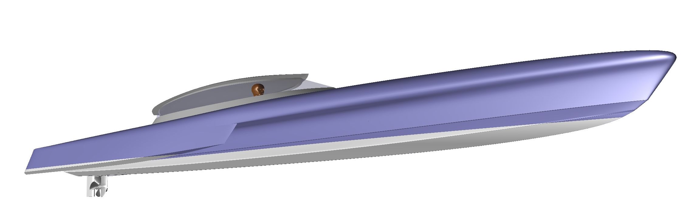

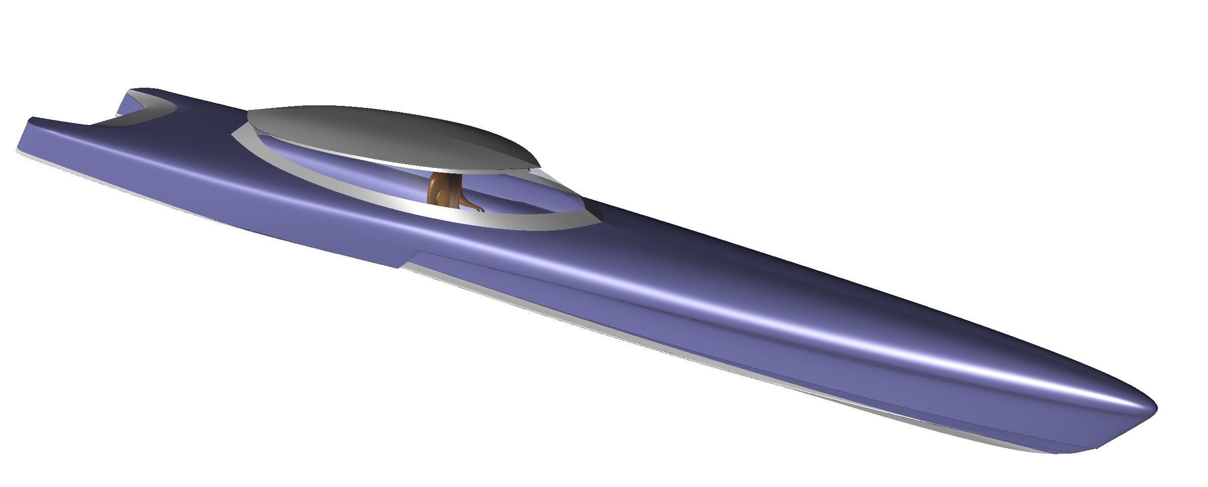

    interior height over keel in the cockpit is what? 1.26m? minus thickness of roof and floor etc.
    so internal height available for engine is 40 cm? what type of engine?
    Canoes work only if the paddler is active in controlling stability and of course are much slower.
    Your flat keel, high bow, and fine sections suggest that the boat will be impossible to hold to a line in wind or cross waves.
    For OP, which part of Skagerak? Seems as if you are looking at travel times of 6-10 hours depending on weather. Very few of us can sit in a constrained cocoon for that length of time -- for a race, maybe.

    Internal height available for engine is 70 cm
    Interior height in the cockpit is 150 cm
    Calculate and test, no guesswork, please.

    Proa sounds very interesting, Stumble. I don't know how much it will attenuate rough weather either. Anyone having experience?

    Very interesting HJS. What about stabilicing your suggested hull with a proa? Easy construction in aluminium is important, so the shapes must not be too complicated.

    my understanding is that proas are not great if the wind/wave direction is variable.
    Constant tradewinds are its specialty.

    In an absolute sense I don't know, but a friend owns Jzzero, a pretty famous ~37' sailing Proa he soloed/duoed to New Orleans from Seattle. With an average speed from Panama to New Orleans of about 14kn. But this has a lot more liveaboard capability than you would need.

    My handle on the concept is this. A low power long thin displacement Hull.
    A starting point may be the 21 feet long boat that Seiko namajira crossed the Atlantic with. Power was a, 2.5 hp tohatsu outboard. Beam was 5 feet and draft was 2 feet. Just scale up his boat by thirty percent or so. I think 15 knots is too high. I think 9 or 10 to be much more realistic
    Just Google tohatsu outboard Atlantic Ocean crossing for the website

    I would definately recomend a power catamaran or stabilized mono for this type of craft. You will need a very fine hull shape to meet your power requirements and if you go with a monohull you will create a vomit rocket unless you add some form of active stabilizing system such us stabilizer foils and or a gyro stabilizer system.
    I would much rather have a boat like Richard Woods Skoota that you can walk around in, carry some people and overnight on if you needed.
    I have made two boats that are applicable (im not trying to sell these designs but hope my experience is usefull). The first was a 24 foot trimaran with a 20 hp outboard and 20 knot cruise speed. The customer uses it often to cross the straight of juan de fuca which can have some terrible conditions for small boats ... open ocean swells stacked up by large currents and usually on the beam. Teh tri is safe in these conditions but can develope an uncormortable motion and wants to broach if surfing a big swell. It also leans outboard in the turns which feels really weird. We have since added hydrofoil assist and the speed is now up to 24 knots but the biggest gain is its stability... it now has a comfortable ride and stays flat in turns.
    The second boat we made was a 24 foot cat with twin 20 hp outboards. This is my own boat that I use to get accross the Straight of Juan de fuca. The ride is a lot more comfortable and you can take more people and gear, take the kids inner tubing, knee boarding, sleep overnight, and walk around. The trimaran feels like a motorcycle and the catamaran feels like a comfortable mini van. On a long trip I would definately want to be on the catamaran. We also added foils to this one and top speed went from 20 to 24 knots... but the biggest improvements were in ride comfort in a seaway, and load carrying ability. Without the foils the boat would start to get bogged down with more than 3 people and now we can have 6 people onboard and still maintain 20 knots.
    Hope some of that helps your search.
