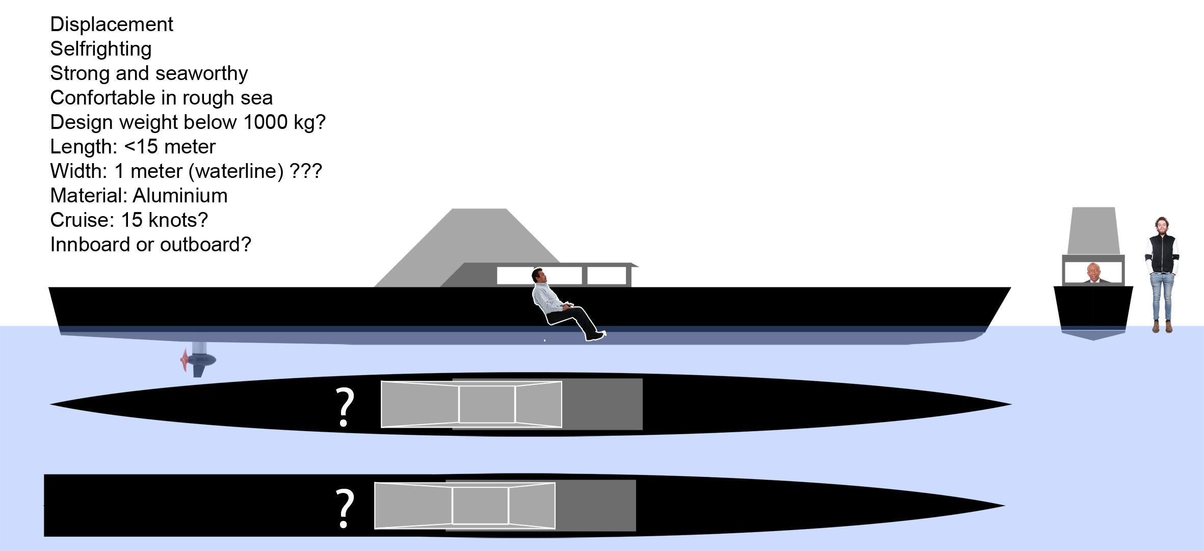

    I'm interested in knowing why this needs to be created, and existing boats are not capable of filling the role.
  2. Jon E
    Joined: Jan 2005
    Posts: 54
    Likes: 3, Points: 8, Legacy Rep: 22
    Location: Norway
    Jon E Junior Member
    What seaworthy low power displacement boat <15 meter cruising 15 knots exist?
    This "boat proposal/question" will cross Skagerak and be exposed to the North Sea. Therefore; fuel consumption, seaworthiness and length/width is a really big issue.

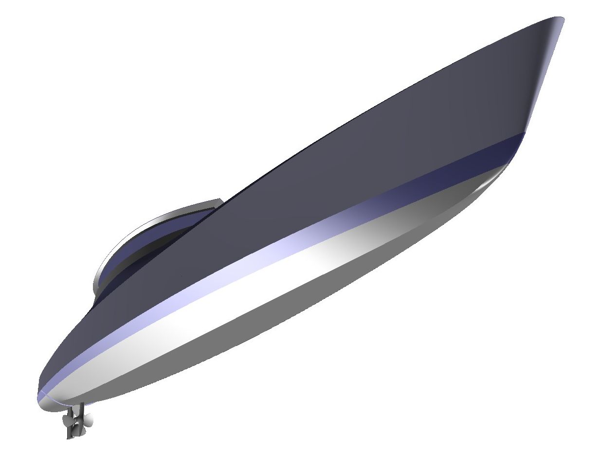

    As you're going into the ocean I would suggest some features.
    First off, flat vertical glass may not be the best answer to deal with waves that you may encounter.
    Glass angled forward may be good for rain but as low as your boat is steeply raked glass may be better.
    You may want to consider an aircraft-like cockpit like some modern lifeboats use.
    If that seems too claustrophobic, good quality glass automotive windshield glass may be an affordable alternative for the front of your accommodations. Granted such would lend itself to a wider hull but with a boat along the lines of a much smaller version of Cable & Wireless ...

    As I think of it this is basicallya rowing shell hull mated to a fully enclosed cockpit to keep you dryand the boat upright. The hull design is going to be very fast for very low power, but it's also going to be incredibly uncomfortable and rolling so much so that it will likely be impossible to tolerate. It would be a perfect example of the boat can take more than the crew.
    So the only way I can see to keep the desirable speed and power requirements is to move to a multihull of some sort. As weird as it seems I really do thing a power Proa maybe the best solution. It eliminates the docking issue with a stabalized trimaran, doesn't require twin everything like a cat, and isn't terribly complicated to build. My only concern is I don't know how much it will attenuate rough weather.

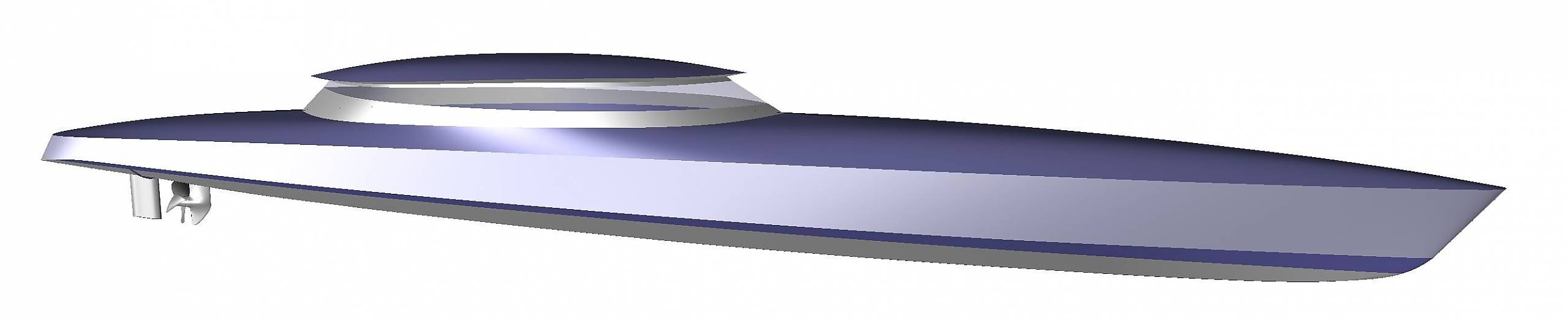

    Not enough freeboard to stop it "submarining" at some stage. And an upswept sheerline forward would interfere with vision from the seated position.

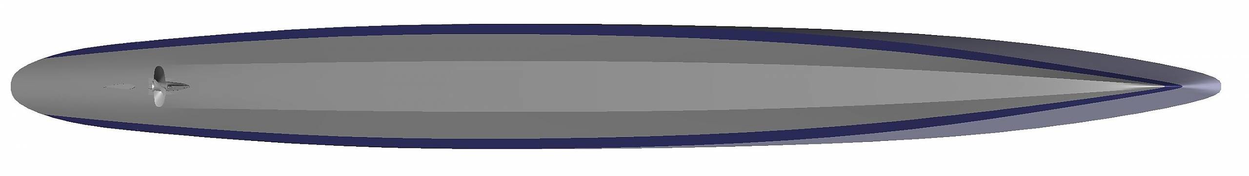

    Loa 12,6 m
    Boa 1,28 m
    Lwl 12,0 m
    Bwl 1,07 m
    Displ 1,4 ton
    15,0 knots 26 hp
    10,0 knots 8 hp

    With this design I really have to wonder if a wave piercing hull wouldn't work better. The ends are almost useless anyway since they would be too narrow to access, and anything to reduce pitching would be desirable.
  15. HJS
    Joined: Nov 2008
    Posts: 357
    Likes: 58, Points: 28, Legacy Rep: 288
    Location: 59 45 51 N 019 02 15 E
    HJS Member
    This showed hull form is based on our long experience with rowboats for unprotected waters. Reducing the pitch was precisely one of the important requirements, in addition to getting the lowest possible drag at Fn 0.7 in this proposal it correspond to 15 knots.
    Calculate and test, no guesswork, please.
