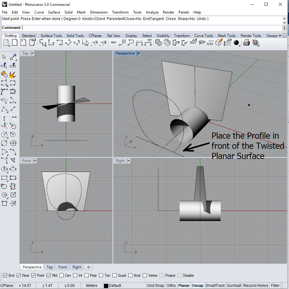

    Yeah, I know - but getting the profile from numbers is the hardest bit.
    There are plenty of other youtube videos on how to do the 3d propellor.
  7. rwatson
    Joined: Aug 2007
    Posts: 5,868
    Location: Tasmania,Australia

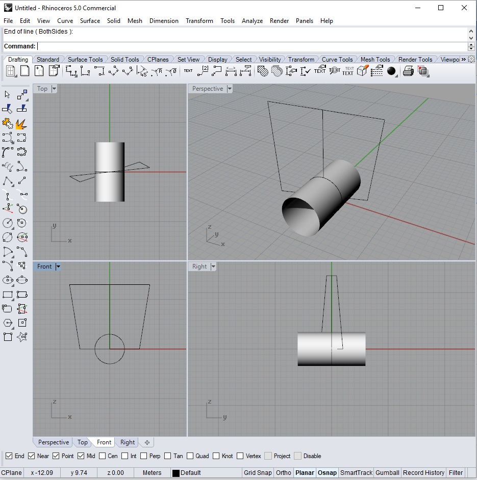

    rwatson Senior Member
    Here is a series of hints. It doesn't include making the chord of the prop blade, but that is easy after you have done the twist and the profile
  8. rwatson
    Joined: Aug 2007
    Posts: 5,868
    If you know the degree of twist needed in the blade, creating a surface with a top and bottom "angle" might be OK.
    But for for a hint about getting a proper "screw" twist into the prop blades, this might be useful.

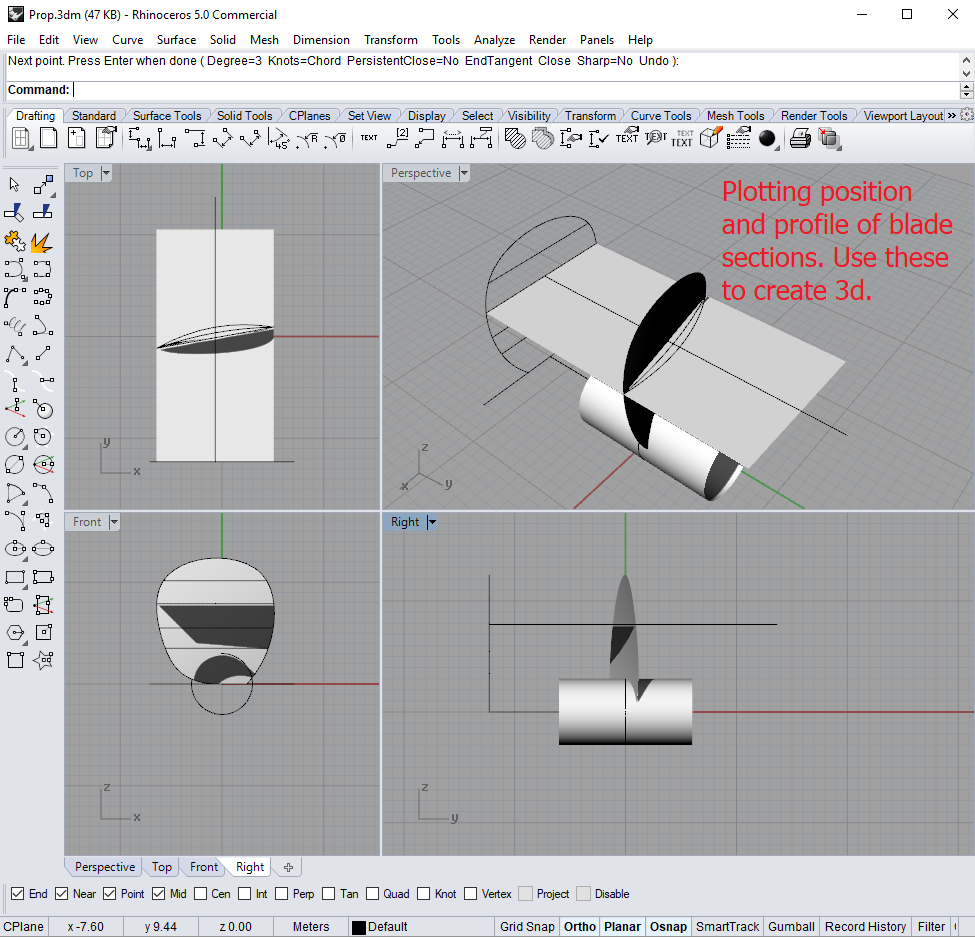

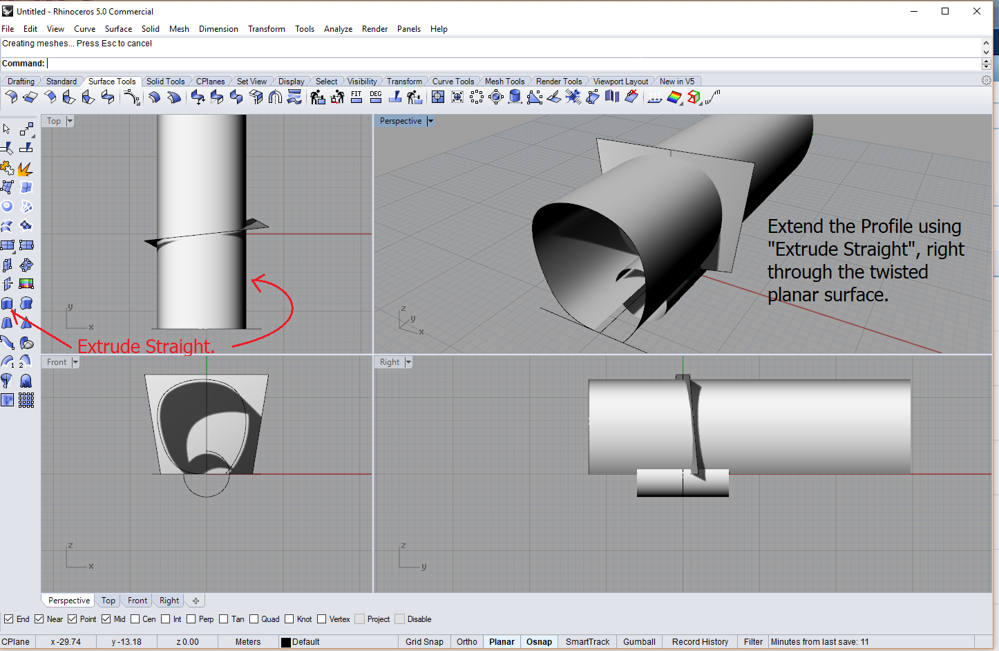

  11. rwatson
    Joined: Aug 2007
    Posts: 5,868
    Simple.
    Using the twisted surface as the "base", apply cross sections at the appropriate locations on that "twisted" Surface, and then join all the cross sections with a front and a back surface over the cross sections shapes.
    The original "thin" twisted surface just gets ignored.
