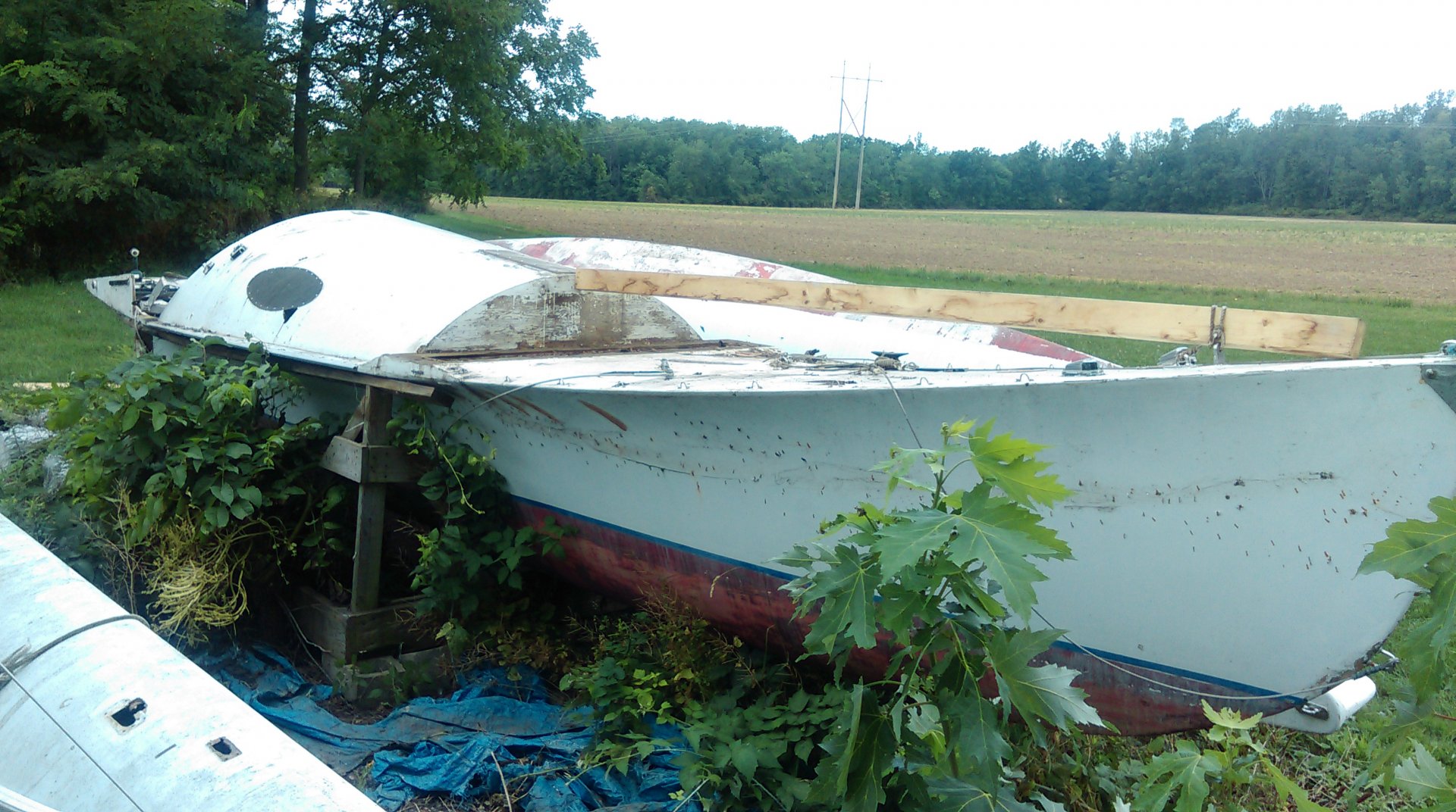

    Hello,
    Here's my input . I have a Newick 30 that is 26' wide and demountable, about 2500 lbs. The plans show main hull attachment similar to cakewalk, but waterstays were added after the initial build. I plan on building new arms at a higher point off the water and similar to these for a good low tech, cheaper and easy to build.
    Tim

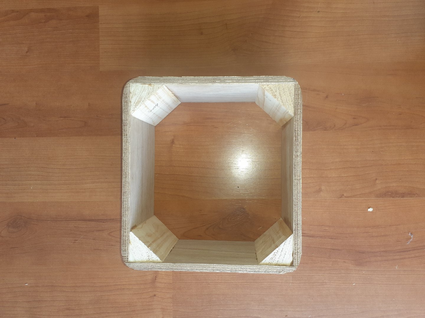

    Some good ideas Russell. I made up another section , larger at similar weight

    I like the rectangular cleats better. Without uni fiber on the outside, those cleats are what take the loads. The quality and size of the cleats will help determine the ultimate strength.

  11. nueva30
    Joined: Oct 2014
    Posts: 18
    Likes: 6, Points: 3, Legacy Rep: 10
    Location: usa
    nueva30 Junior Member

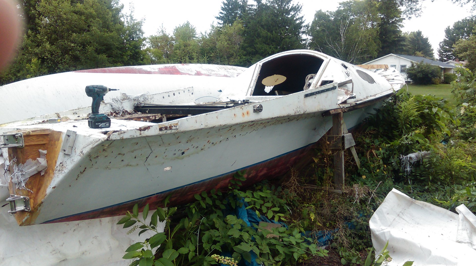

    Adrian and Russ,
    I don't have any pics of my boat together, that hasn't happened since the early 1990's. Here's some of how the boat is now. I can't get to the boat now because of deep snow, but I estimate the water stays to be around 9mm. I did talk to Dick Newick once regarding my boat and he said that making the vertical plywood 5mm 0r 6mm would have made the waterstays obsolete. The boat was pretty floppy with the current set up and the low beams, I'm hoping that raising the beams will help the stiffness. Have you made a decision which way you're going to build yet?
    Tim

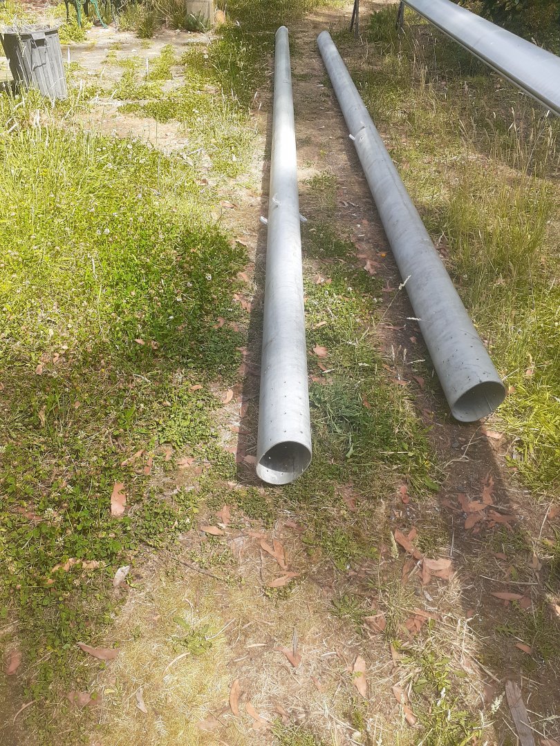

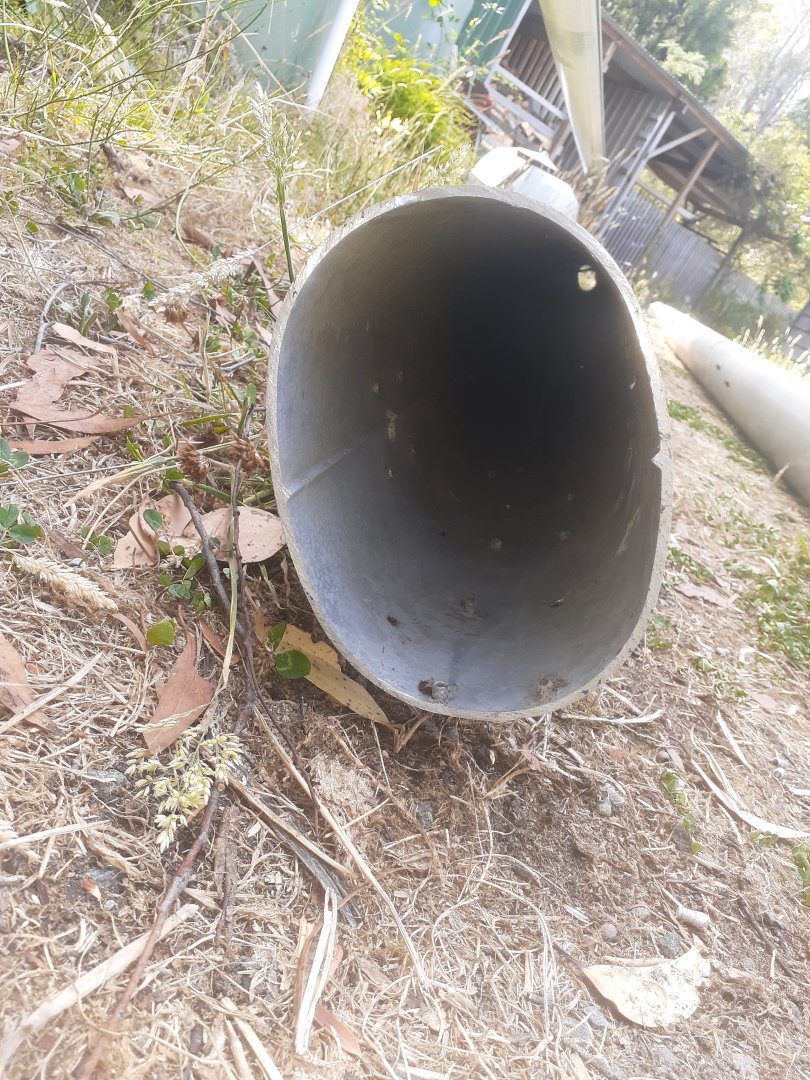

    An update on progress:
    I brought 2 sections yesterday both over 6.2mtr there anodised as well but have quite a few 4mm rivet holes and couple of bolt holes as It was once a mast . The section is 185x 135mm and 3.3mm thick and weighs 4.5kg per mtr ,at total of $150 it was to good to ignore . So I'm looking at tidying them up and using them as beams ,maybe painting them as well since the anodised looks a little shabby .Regarding strength in way of comparison the bucc 28 uses 140 mm tube with a 4.77 mm wall thickness and weighing 5.5kg per mtr,mine are lighter weight and thinner in the wall thickness but a larger sectional size ,so hopefully they'll be ok.

    Hi Ivan, no I don't know what alloy it is but the mast was built by a professional so I'd assume it a suitable alloy/temper
    The majority of the rivet holes are from a now missing external sail track I either put a rivet in them or I'll use them to fit another track or saddles for the lashing of the trampoline. The bolt holes I'm thinking I could could put a soft pad eye in and pretend it was meant to be there,the mainsheet track will cover some too.
    After cleaning the sections up yesterday I weighted them ,the finished weight of each beam should be 28kg at a length of 6240mm ,maximum beam of the boat is 6660mm and length of 9100mm .At 28kg per beam I'll be able to handle them fine with help from my wife ,
