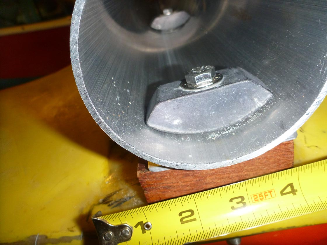

    I think this is very useful info, and wish I knew earlier. Instead, I copied existing cats (NACRA) designs, which feature tube, on my updated Malibu Outrigger build, as noted in pic. Seems either would do job.

    Yep. I locked each tube down similarly, to limit movement, used orig Nacra parts to do as close as possible. Thought of rectangular akas, but I stayed with tubes to make it easier. Seems to do fine, so far. Stiff as can be, even on old Hobie 18 pockets I had to build up. But, have to admit, rectangles would have been easier to work with, at least on outrigger side...maybe.
    I planned to do foam ama with chines, but holding off as current tracks so well.

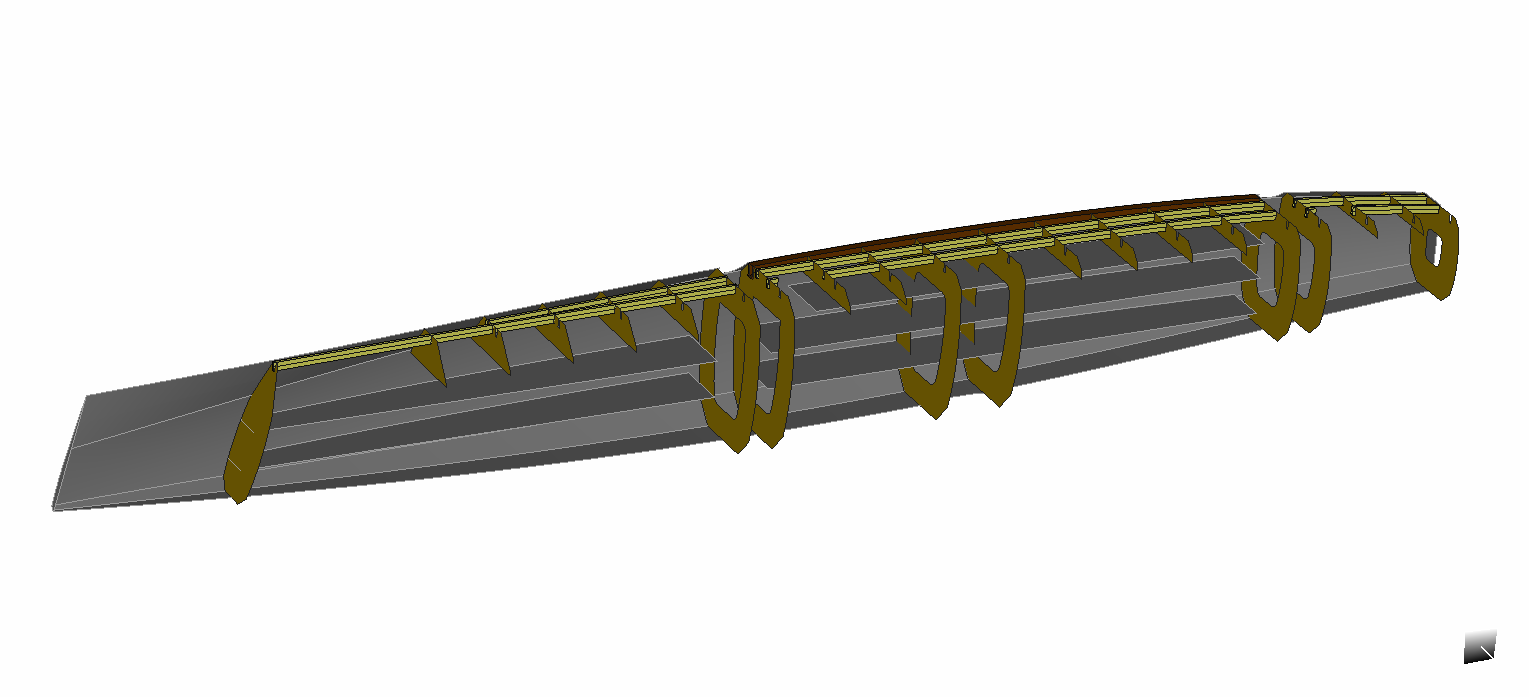

    On the next picture you can see my inner layout of the hulls. The frames are set where the beams will be located to transfere the loads and forces in the hull. The daggerboard trunk is also surrounded by frames. But maybe I'll clip the one more aft as these supporting the deck. The shrouds will be attached at the one infront of the daggerboard. As already mentioned the deck will be supported by deck-frames an stringers. The big brown one at the STB side will support the trampoline. The fore stay will be attached at the inclined frame in the front. To prevent the boat from sinking and to stiffen it out horizontal styrodur foam plates will be installed as showen.
    Now my question is how I can calculate the approximately longitudinal and transverse strength of the hull. For big ships with a high L/B ration just the midship section is used to calculate the longitudinal strength. But when I want to calculate the transverse strength the section varies quite a lot from where the forestay is attached to the one in the middle. My task is to know the minimum angle of the bridle and thus the hight where the following forestay is attached. Is it possible to calculate this by hand or do I need numerical FE methods for this?
    I have the maximum rightingmoment and the tension in the shrouds but how do I get the tension in the forestay with consideration of the force by the mainsheet?
    Can anybody help me with that? Maybe Wayne, I think you did several calculations like this for your F16 project? Would be nice, thank's a lot!!

    Re the pics of the aka anchor point above...I wanted to "mold" to hull, but could not, really did not want to fool with it. So, had a T-6 plate (you can see edge) made up with rails along side to keep the the aka in place, and, used NACRA beam anchors and orig stainless straps to hold aka...may not be esthetic but all works...might even have been over-kill. After full season, is fine...

    Umm the loads are quite high inward if you have a conventional forestay as in highly angled outer connection stays to the forestay at the bottom of the jib. Older designs had a compression tube between the hulls to over come this. The F16's went a different way with outer hull connecting stays, connecting about 1/2 way up the fore stay with a solid tube extension below finishing about 600mm above the spinnaker pole. Diagonals are taken out to the hulls and one directly down to pull the spinny pole up into an arc to give it strength. The jib is pulled conventionally on a halyard up the upper half and then a zipped section is put over the solid tube. It just allows the outer hull connecting stay to be at a much reduced angle and thus limit the inward pull on the hulls.
    Use 4mm D12 Max on the upper section and 3mm D12 Max on the lower and you will be fine. Remember its the tension on the main sheet that keeps the forestay tight, not the rear side stays, they are only there to keep things upright until the mainsheet is on. We use 10:1 minimum on the mainsheet just to bend the mast and keep tension on the forestay.
