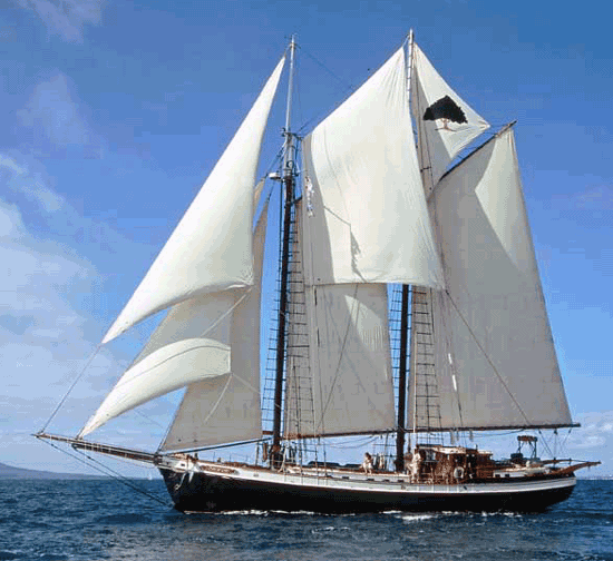

  6. Tad
    Joined: Mar 2002
    Posts: 2,321
    Likes: 214, Points: 73, Legacy Rep: 2281
    Location: Flattop Islands
    Tad Boat Designer
    Dave Gerr has one that I believe has been built, I think in foam cored glass....
    http://www.gerrmarine.com/commercial.html
    Sapphire
    Images: 1, 2
    72-foot Charter schooner, Coast Guard certified for 49 passengers ocean, yet drawing just 4 feet 2 inches
    Length Extreme 81 ft. - 8 in. (24.88 m)
    LOA: 71 ft. - 7 in. (21.82 m)
    LOD: 64 ft. - 0 in. (19.51 m)
    DWL: 54 ft. - 5 in. (16.58 m)
    Beam: 17 ft. - 8 in. (5.38 m)
    Draft: (CB up) 4 ft. - 2 in. (1.27 m)
    Draft: (CB down) 12 ft. - 8 in. (3.85 m)
    Displacement: 39 tons
    Water Tanks: 500 gal. (1892 l)
    Sail Area: 2,094 sq. ft. (194 sq.m)
    Area 100%: 315 sq. ft. (96 sq.m)
    Bridge Clearance: 64 ft. - 0 in. (19.5 m)
    Ballast: 18 tons
    SA/Disp: 17
    Ballast/Displacement: 46%
    Disp/WL: 237
    WL/Beam: 3.45
    Gross Reg. Tons: 23.5 tons
    Diesel Tanks: 200 gal. (757 l)

  9. Boston
    Boston Previous Member
    I'd be inclined to mention Ted Brewers "Sophia Christina" design
    or the "Tree Of Life" design
    both are coast guard approved and plans are available ready to build
    a few thousand for the Sophia and a another few on top of that for the Tree
    would be well worth looking into before you make a final decision
    cheers
    B
  10. PAR
    Joined: Nov 2003
    Posts: 19,126
    Location: Eustis, FL
    PAR Yacht Designer/Builder
    Boston has been drooling over this since he discovered her. She's a fine vessel, unfortunately not in the material KH-sails desires, though I'm sure scantlings could be worked up, but I'm fairly sure not in the time frame currently presented.
