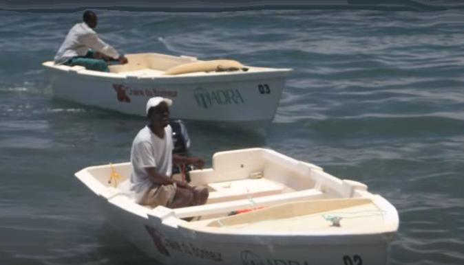

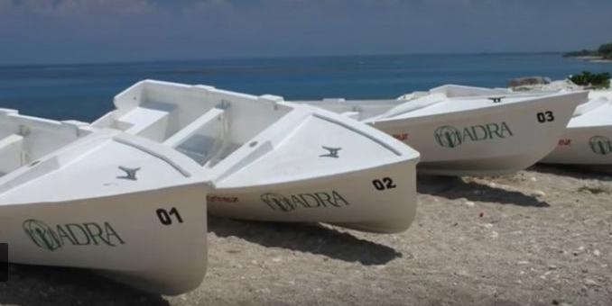

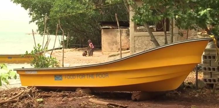

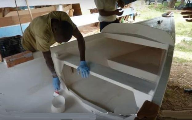

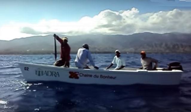

    I see an organization that has given Hatian fishermen outboard skiffs to replace their wooden boats and this video of another building skiffs for them. How ever perhaps for the fishermen who like their forward facing paddling canoes a planked bateau design would be a useable alternative.
  12. W17 designer
    Joined: Oct 2010
    Posts: 147
    Likes: 42, Points: 28, Legacy Rep: 21
    Location: Vermont, VT
    W17 designer Senior Member

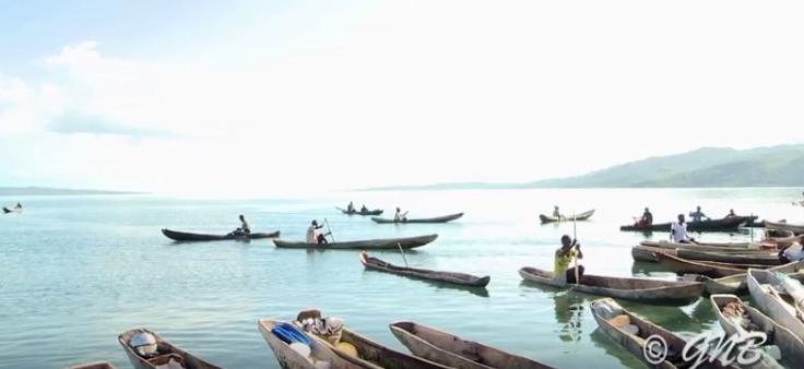

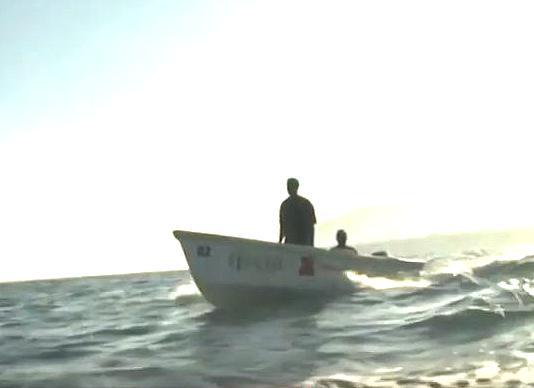

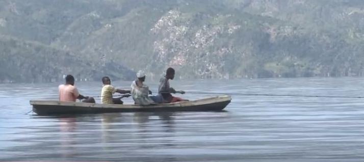

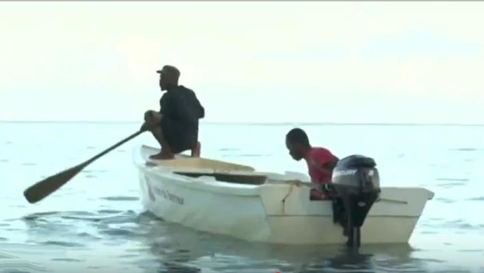

    Thanks Waterwitch. I think the rugged but versatile boat shown in the 2012 video is indeed a practical solution, even if the boat will be quite heavy. Once in the water, that weight will help to stabilize the moti0n. And Haiti is probably typical of the area for which the proposed new boat would be useful and effective.

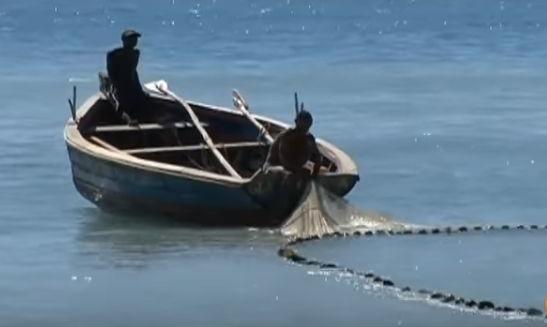

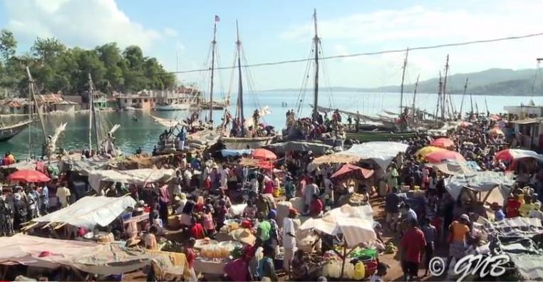

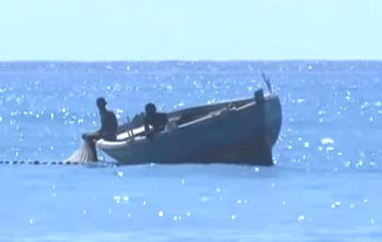

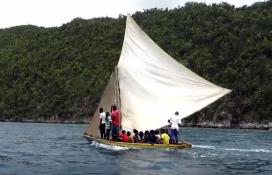

    To help guide potential designers, I think it's good to see how 'the locals' are presently fishing and what boats they are using, so I have collected some pics taken from various sources ... including some cleaned-up screenshots of the ADRA build project.
    Because of the need and usefulness of inclining the boat side, grabbing a net and then using boat and crew weight to 'lever' that weight up, I really think a fairly wide monohull, makes more practical sense than a multihull of any form, for this particular requirement of a versatile hand-fishing craft.
    If Stumble or any reader knows what size of O/B motor they prefer to use and handle, that would be good to know. Weight, economy, cost, thrust, speed .. all factor in, so we'd just be guessing.

    Primarily the Haitian fishermen cannot afford any outboard engines, or the fuel to operate them. The few in operation tend to be reserved for emergencies, or when they need to hurry back to the dock with a large catch. The primary means of propulsion is rowing supplemented with sailing. Traditionally they used drag sails (including shrubs) to pull them out on the shore breeze in the morning and drag them back in the evenings. Sails for Sustenance has been working to bring used sails from the US to Haiti and helping the fishermen modify them for use on existing boats. This is part of the concern, traditional NGO's assume the use of a 15hp outboard, because it is the standard the UN uses. But in the truly impoverished parts of the world what we would think of as minimal power is a pipe dream. Our SOR assumes no outboard power at all, but provisions for a small 3-5hp for supplemental use only would be a nice addition. But 95% of the boats sea miles will be under oar or sail.
